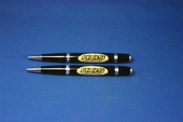

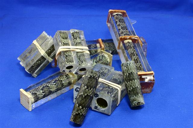

Embedding: like snake skins, labels, circuit boards, or other stuff wrapped around the tube and embedded in some type of resin. For me the choice is polyester resin and others use Alumilite.
Do a good turn daily!
Don
Sorry for this stupid question, what do you mean by embedding?

rjwolfe3
Feb 12, 2008
8,352
Mansfield, Ohio, USA.
I believe (and I am no expert) that most of the snakeskin are done on the thicker kits. Of course I could be wrong, I just haven't seen a slimline snakeskin yet, lol.

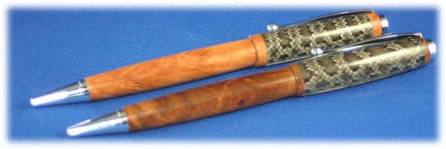

I make my snakeskin blanks for most of the kits. My favorite is the Sierra (not the sierra vista), the baron, and cigar. In addition to the ones mentioned, I've made blanks for the elagant beauty, jr gent and statesman, gent and statesman, the 7mm euro, slimlines, patriot, zen, and probably others I've forgotten. A 7mm euro was posted last week by alex Chapa from a set of blanks I made. I do make slimlines but I don't (personally) like snake skin on the top and bottom, so here is how I do slimlines.
The skins on these rattlesnakes are not tissue paper thin but they are not super thic either. I very seldom cut into the skin and if I do it is usually on the end of a sierra. I've wanted to try the sierra vista but I don't really have problems with the sierra. I don't remember the last skin I cut into.
