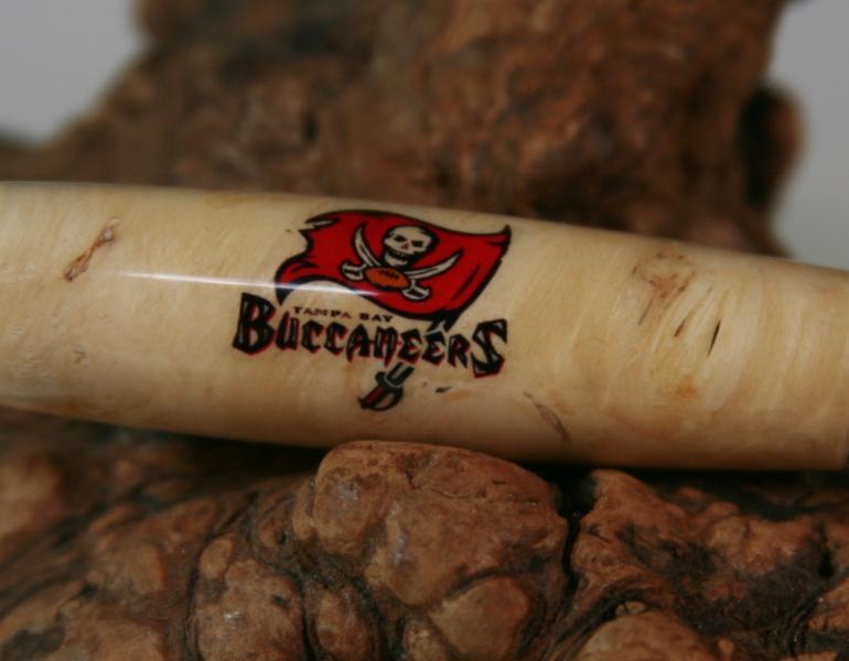

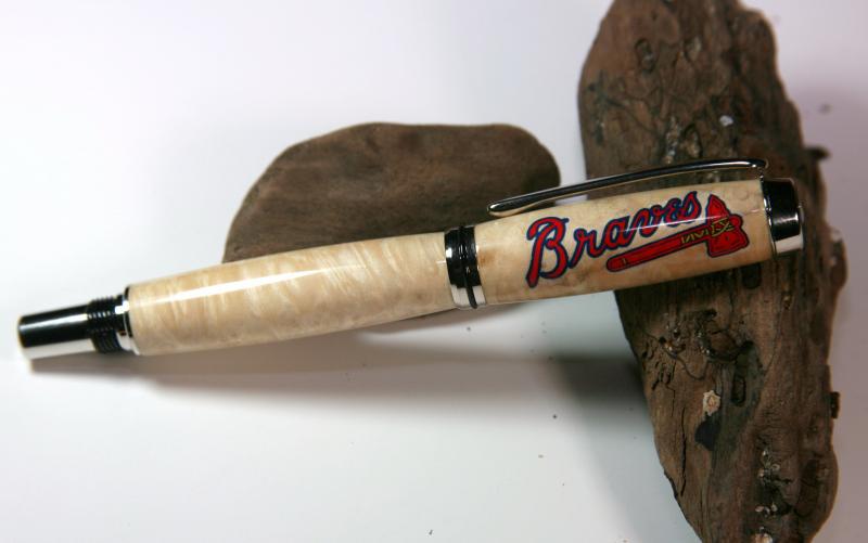

How about trying waterslide decals inder a CA finish, just another option.
I have been doing that for a while with great success.+/_ two years
I am using the waterslide decals on Semi finished barrel to give it a good finished surface and then used CA to finish.
It truly works for me. Here are some I did for customers.
If any one need some advice on this I would be glad to help.

^Very nice looking. I'm assuming that you seal the wood first? Seems you'd have to be careful making sure the wood was fully dry before CAing over it.
