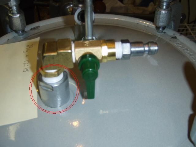

This is the part that broke off the tank. I don't have a clue how to fix that. I guess I'm at a loss to think of how I'm going to attach my air line to the tank now. What is that part called? I can't imagine I wouldn't be able to find something to replace it.

Are you saying the inner thread broke off from the inner fitting (the one with the rubber "O" ring)?

How about a pic of the thing while it's broken, maybe we'll be more clear as to what piece you're talking about.
I assumed you meant the threaded part with the teflon is what broke off inside the bare metal piece.

So the inner and outer fittings broke broke on the threading that goes through the aperature in the pot lid? Or is it a fitting that is welded to the lid? HF has 2 different pot types. The earlier manufacture were the welded ones. The new ones are all the threaded ones.
If this is the threaded one, then you can use black iron fittings from the Lowes or Home Depot and a steel threaded nipple with a gasket to create the same fitting arrangment.

Extract the thread and insert a new male fitting. I believe the thread size is standard, you don't necessarily need the exact same Teflon nut with thread. In theory you could use an oversize hex nut with an O ring.
That's it!!! Thank you very much.

Well, I tried some black iron fittings, but they didn't go together so well. So, I tried some brass fittings. Those worked much better. The hole in the lid is about 3/4" in diameter and 1/2" fittings fit almost perfect. At first, I tried o-rings, but they didn't seal well at all. I ended up using some gasket maker silicone to seal it and it works like a charm! I think I still have a small leak somewhere, but it should hold enough of a seal long enough to do what I need it to.
