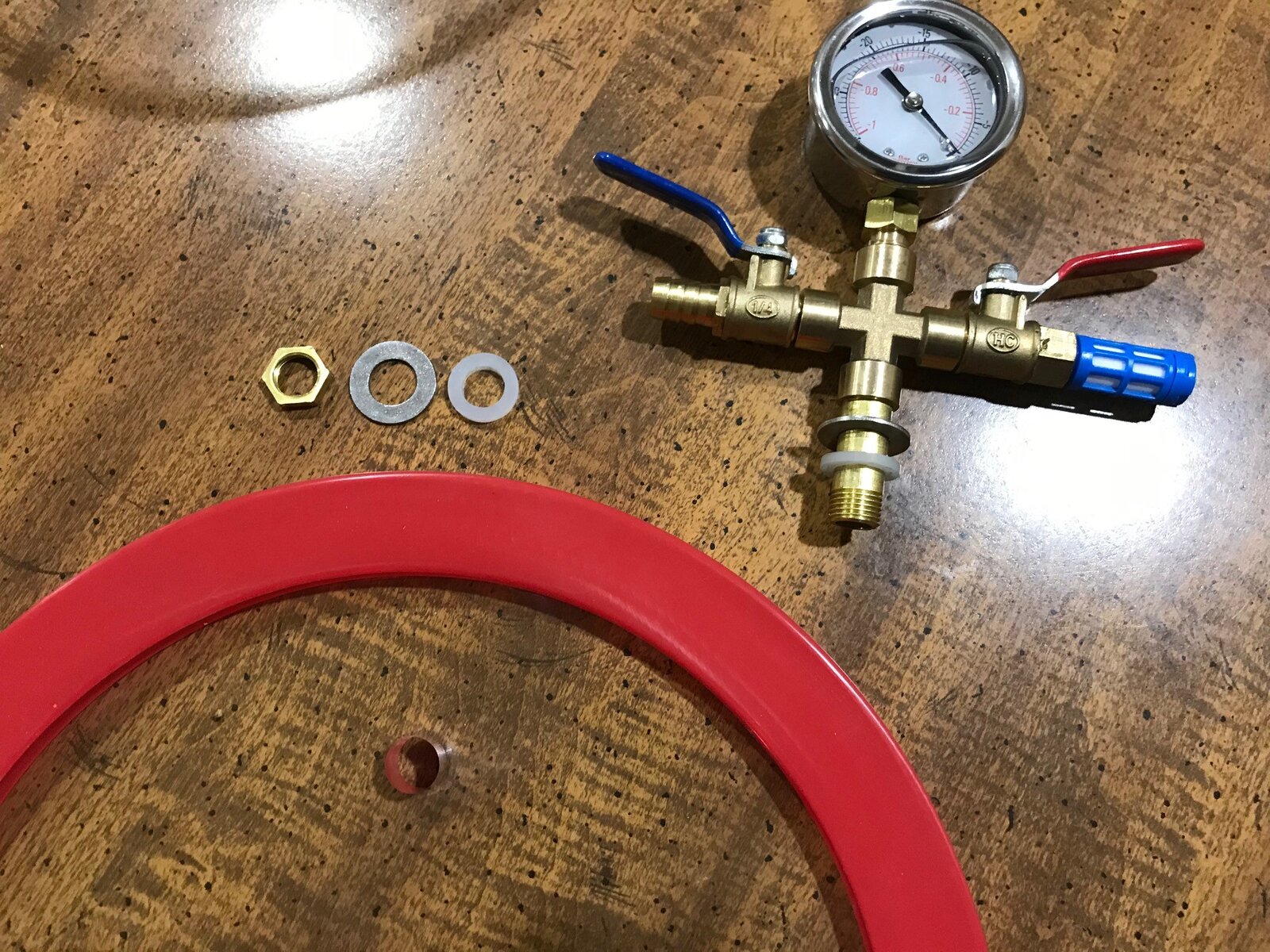

Hello everyone,
Wanted to see if someone could give me a "sanity check" on something. Got my new vacuum pot in the mail today and was going about setting it up. Like expected, has a small hole in the top for the vacuum line/gauge to go through into the pot. It came with 2 steel washers and 2 rubber washers and a nut for on the underside. From the bottom up, it is..... Nut, steel washer, rubber washer, LID, rubber washer, Steel washer. When I tighten the nut, it does not have enough threads to cinch up tight. Wondering if this is supposed to fit tight or if the vacuum, once running would pull it down enough. There were also 4 small black rubber washers that do not seem to fit over the shaft of the vacuum pipe extending into the pot. Not sure where those would go.

It has to fit tight or you won`t be able to pull a vaccuum . Are you concerned about stripping the threads if you really cinch it up ? Looks to me as though they penny pinched on the insert length . I would check with the supplier before doing anything . Smaller washers - replacement seals for gauge attacment ??
It looks like you bought the same one I did. There is a link to a video in the paperwork somewhere that shows you how to install the gage into the glass cover. it involves using the washers on the outer side of the glass cover and then making a twisted rope out of the Teflon tape included with the unit to seal the inner side.
I did the same thing you have done and that to think not enough hardware was provided but if you follow the video it all works.
If you cannot find the link in the paperwork here is link that shows the same basic technique but from a different manufacturer
Vacuum Gage install
I think I got it fixed. I went into Home Depot and got some nylon washers and stacked them in so the nut would tighten down. Seems to be holding. If not, I think I will just give it an attitude adjustment with some 2 part epoxy!!
I tried the same thing and could not hold a vacuum. I followed the video's instructions and it works like a charm. Giving something that is pulling an absolute vacuum an attitude adjustment is not something you want to tinker with.

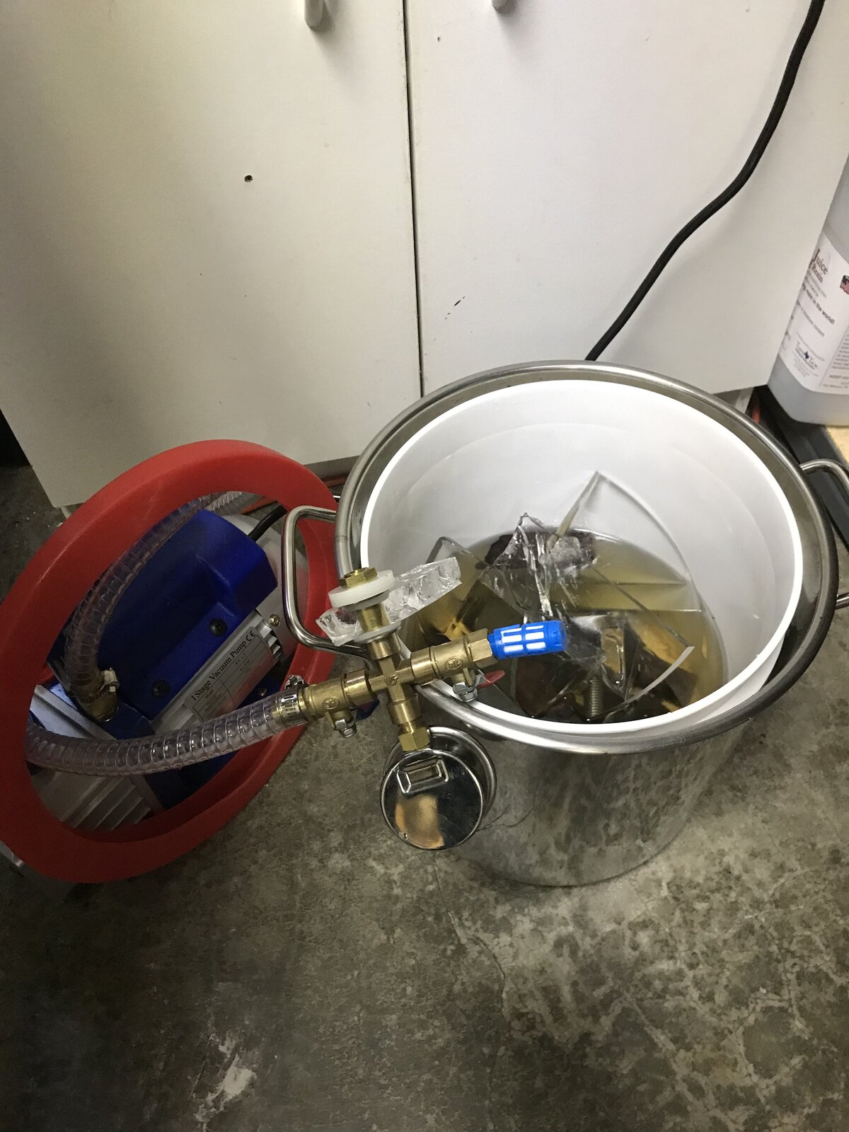

Thought I would post an update! Things have NOT BEEN GOOD! Finally got all the fittings tight and achieved a solid vacuum. 2 days later my lid caved in!! Came out in the morning and the plastic lid that came with the vacuum chamber was shattered in pieces. Luckily I didn't have the pump running (I'm too scared to leave anything unattended in my garage). Anyway, I got smart and ordered a 3/4 inch glass lid, modified my vacuum chamber by drilling a hole in the side near the top to mount my vacuum line and gauge. Put it all together and it now works like a champ! I'm on about my 10th load of stabilizing blanks and everything is going smooth!!!
