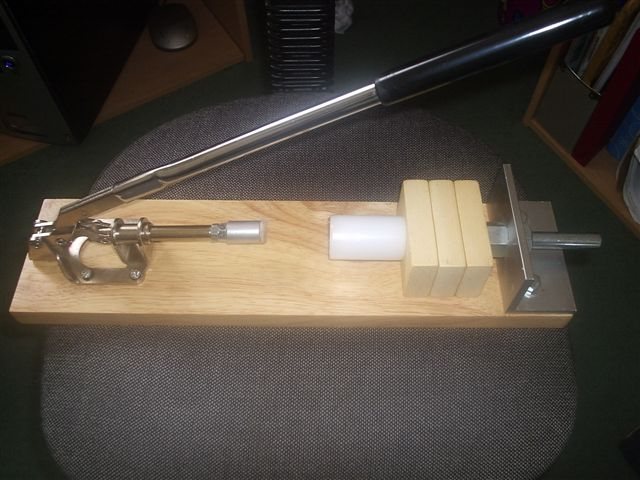

I thought I would try to start something. Showing off my favorite jigs. Well I did not make the press but used someone else’s idea of using the 1/2" ply shims instead of using the screw clamp adjustment. It is a lot easier then trying to get the screw clamp tight. Forgot to add that I screwed a piece of 2 x 2 to the bottom so it clams in my bench vice.

I have just received the "penpress 2", it does not have a lever just the wooden spacer blocks x 3 (as showm on the right of your picture).
Verdict so far, YABA DABA DOOOOO [:p][:p][:p]

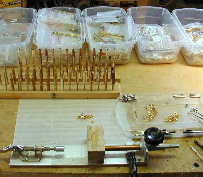

jrc
Jun 1, 2004
647
Bristol, Vermont, USA.
Here is my pen press and I use 1/2" copper tubing for my spacers. The wood block has a tapered hole for the tip, the tip is tight in the hole as it touches the shaft. Does not mark the pen tip. I flip the block over to another shaft hole to press the cap on.

Ligget
Jan 13, 2005
13,474
Bonnybridge, Scotland.
This is my new press. I think it came from PSI as I bought it through PoC. It has no tightening mechanism at all, just the spacer wooden blocks. It had "penpress 2" on the box.
