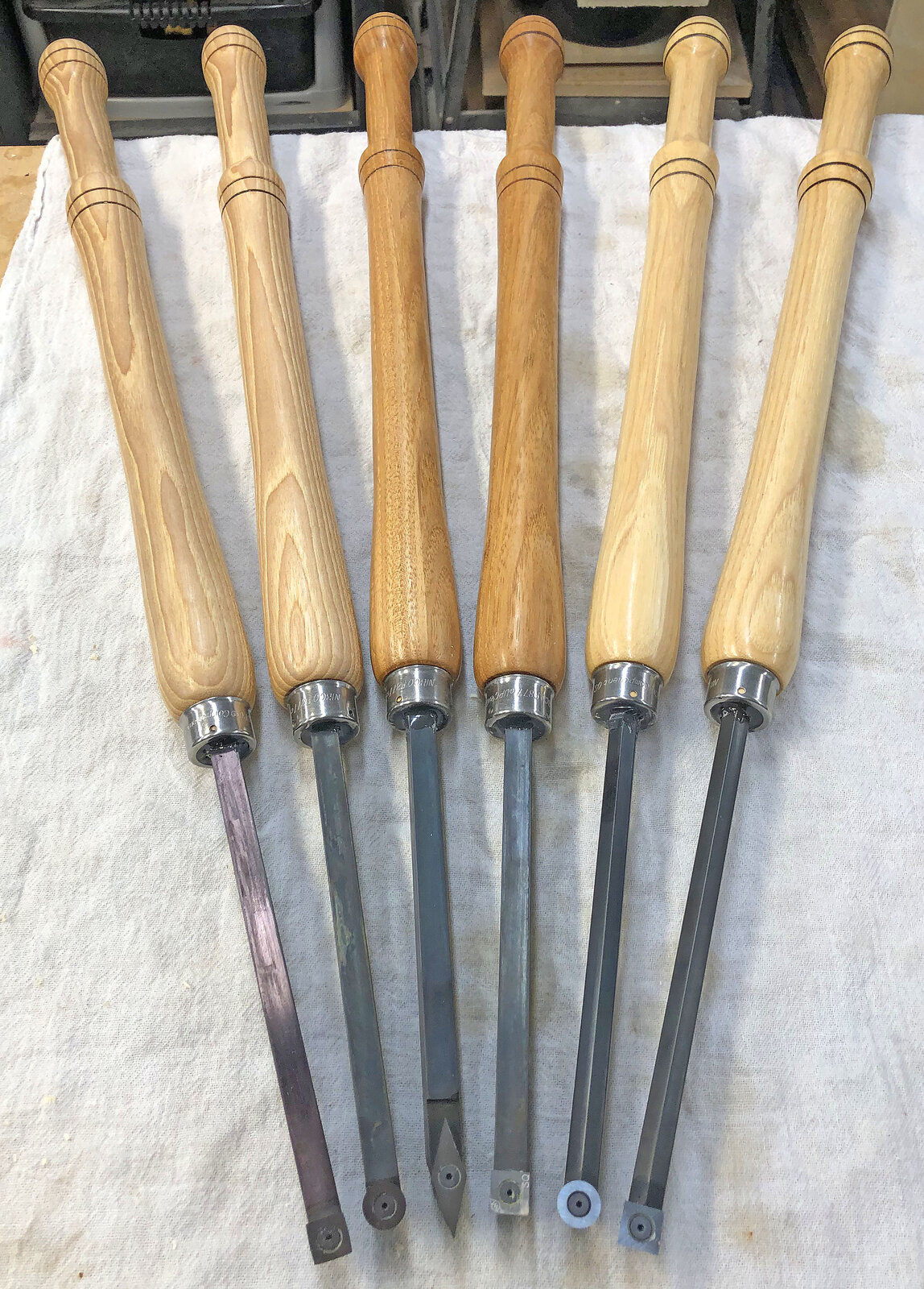

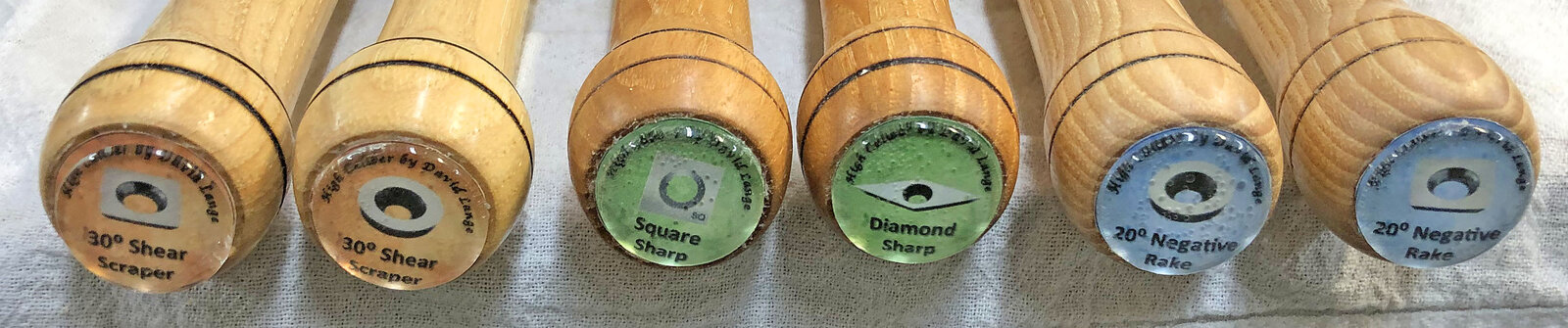

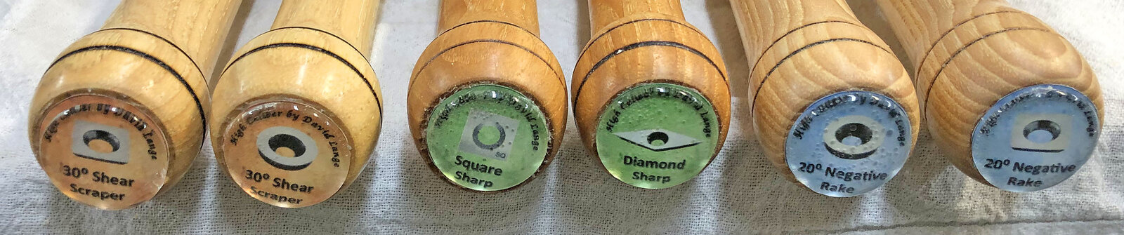

Making your own tools can bring a new level of satisfaction when you build something with them. I made my tool shafts out of 3/8-inch mild steel bar stock from McMaster-Carr. I patterned the handle shapes after some EZ Wood Tools that I purchased. I like tools that are a little heavier in the back, so I put about a dozen 38 caliber lead bullets in the back of each handle to get the job done. I make my handles by either cutting them in half or by just starting out with 1x2-inch pieces and gluing them together. Before gluing them together I route a 3/8 slot down the middle to accept the tool (and my weight) without having to try to bore straight and deep holes in the wood. I cover up the ugly hole on the back end of the handle where I glue the weights in first by filling it with epoxy to make a plug and then I glue on a label covered with a glass cabochon that I get from our Hobby Lobby store. I've attached a couple of pictures. I use 3/4-inch Stainless Steel PEX Crimp Ring Sleeves for the ferrules. I used to use pieces of 3/4 inch copper pipe, but I like the flared and rolled edges in the PEX fittings much better as they make a nice transition to the handles.
I'm sure you will find that next-level gratification when you use your own tools too. - Dave

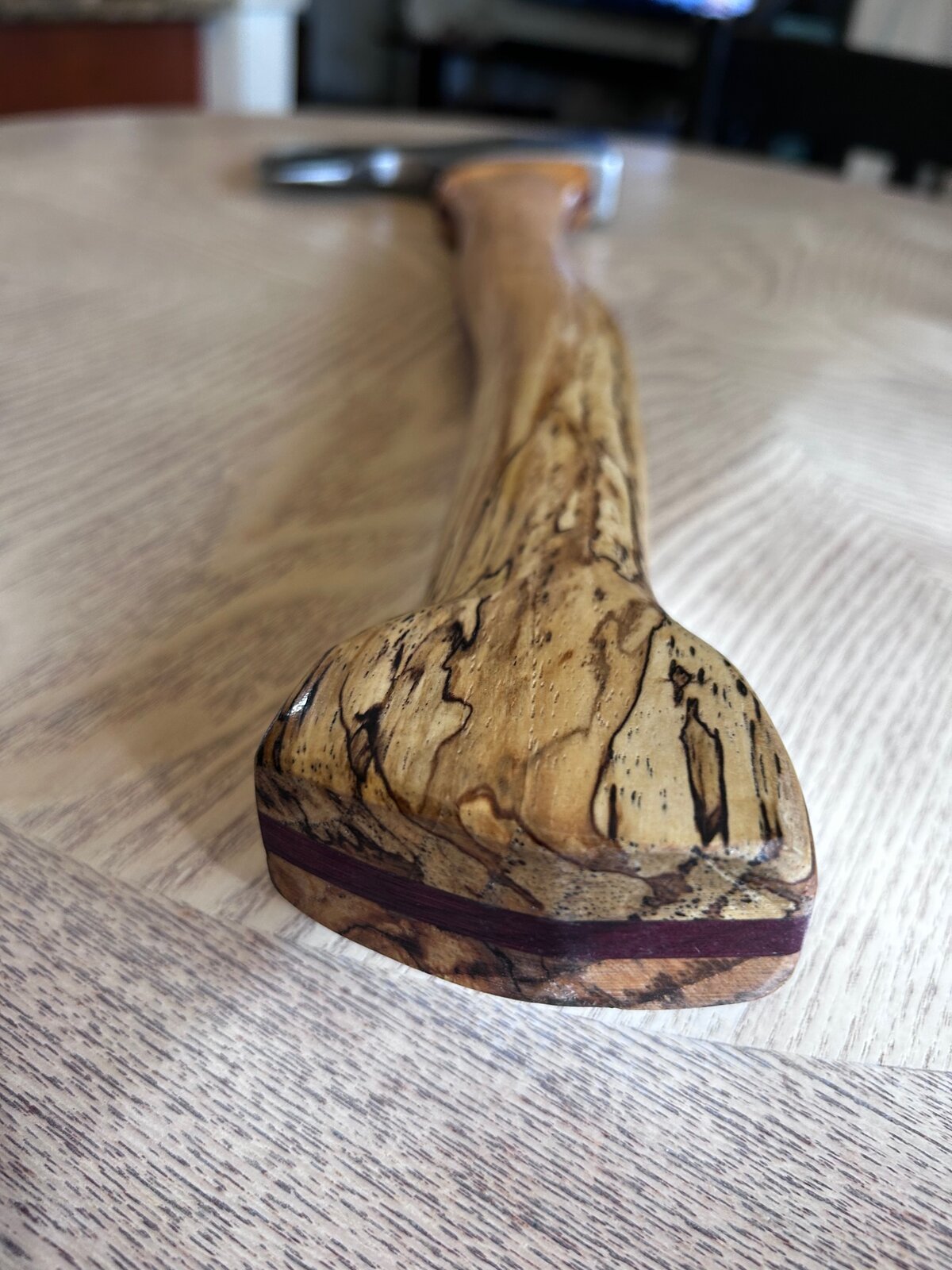

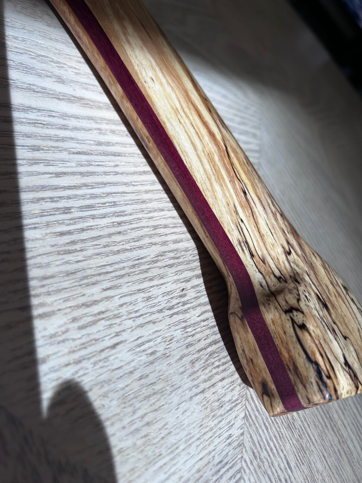

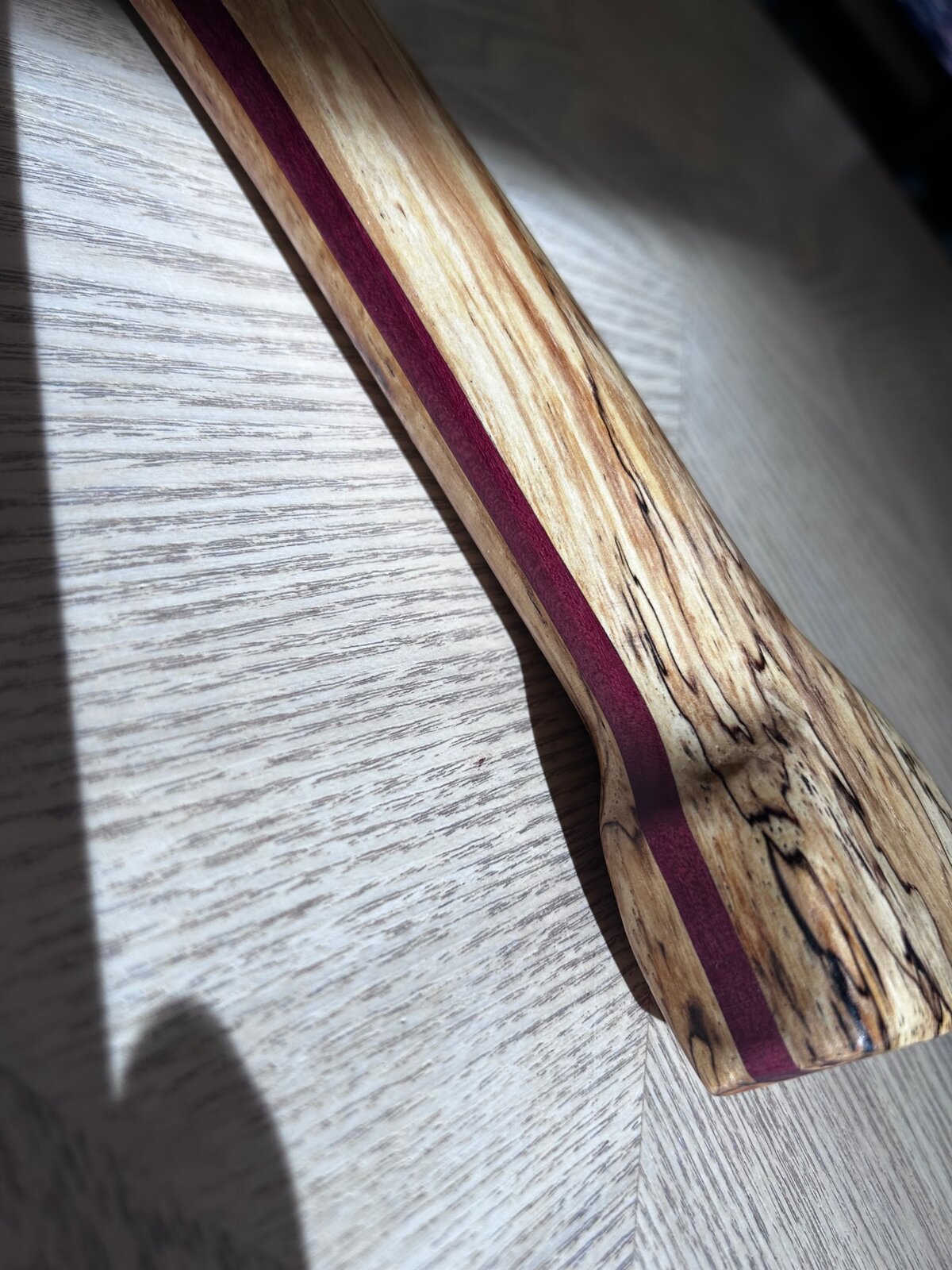

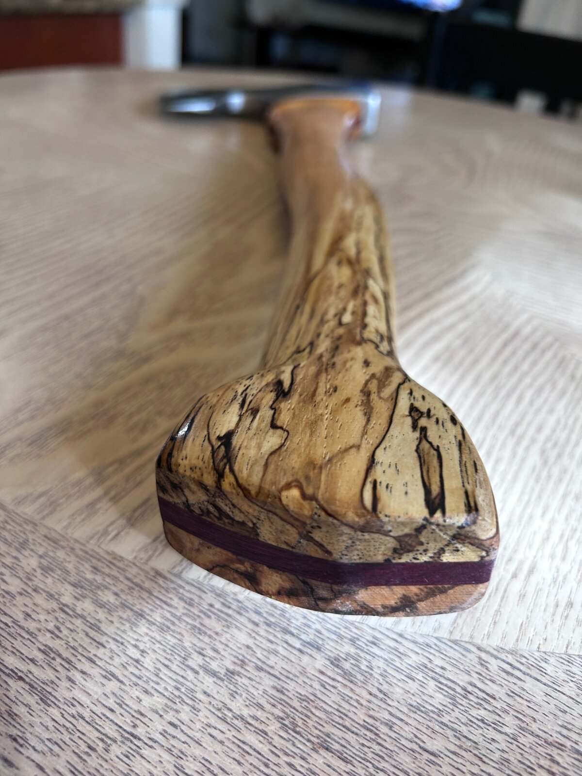

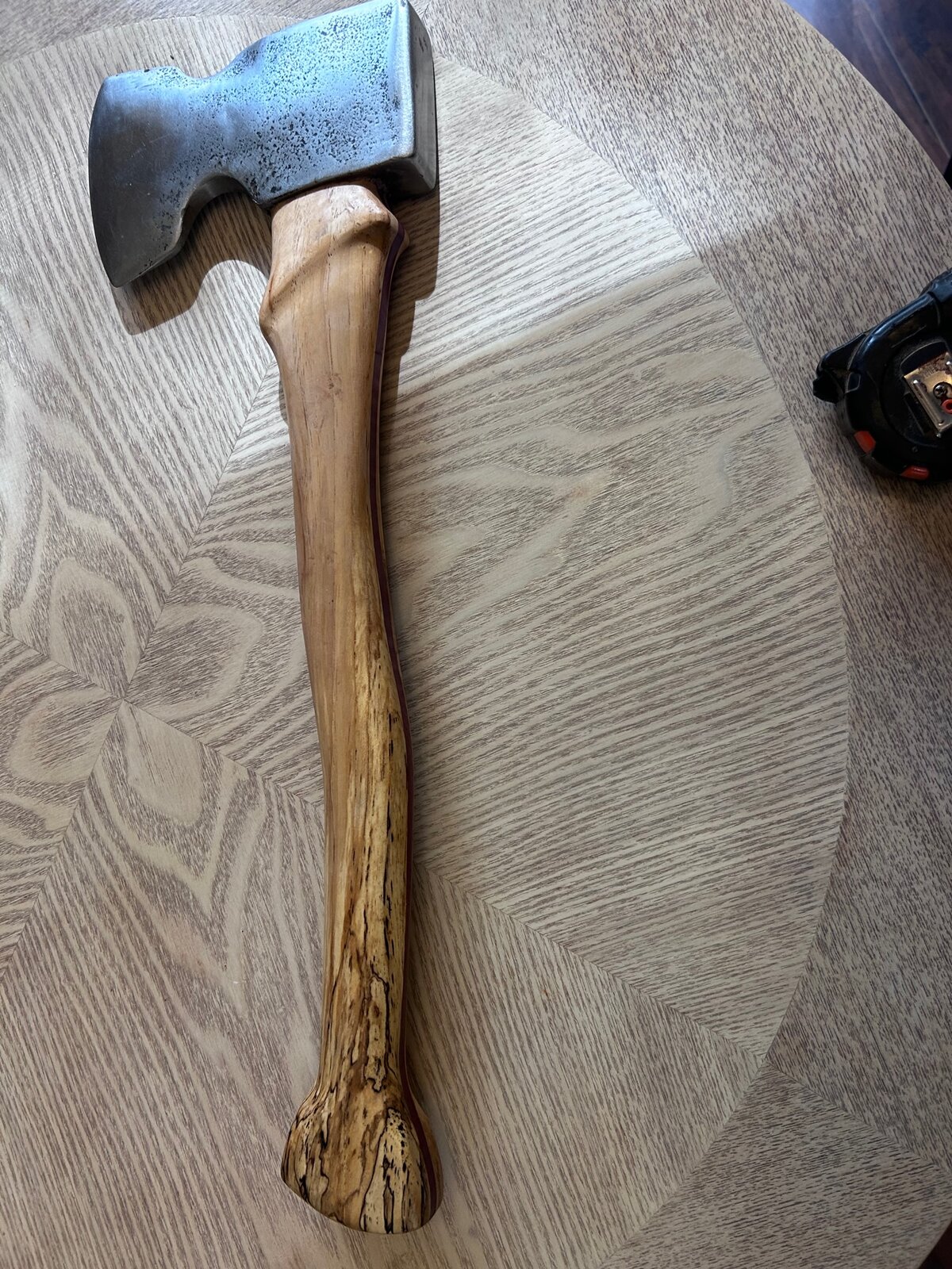

Pecan would be fine "If" it is hard pecan. Pecan and some types of hicory are near identical as far as properties eventhough they are not related. Even the floring industry uses each as the other. I made this pecan Axe and handle with a purpleheart as a center piece of a lamanent. This pecan came from a friends farm in Kentucky. Harder wood like osage orange is too hard and sends a unplesant recoil and you get all the sting. I'll post a hardness scale of most wood so everyone can know it's hardness.
