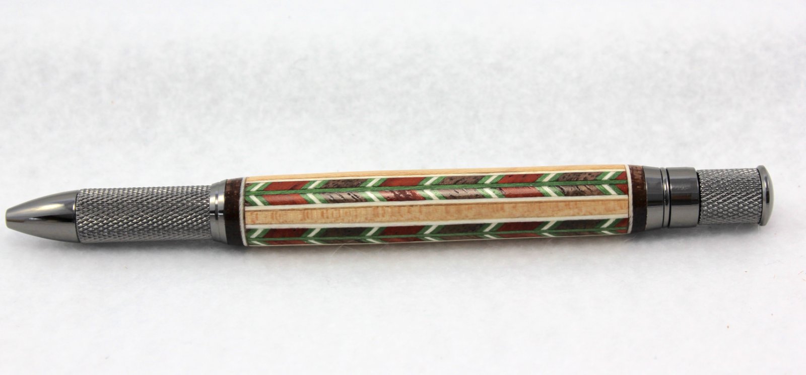

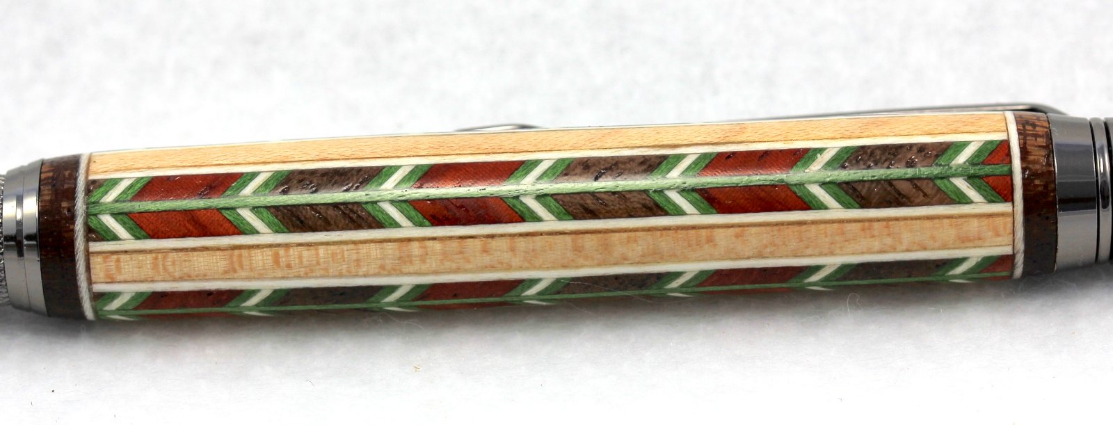

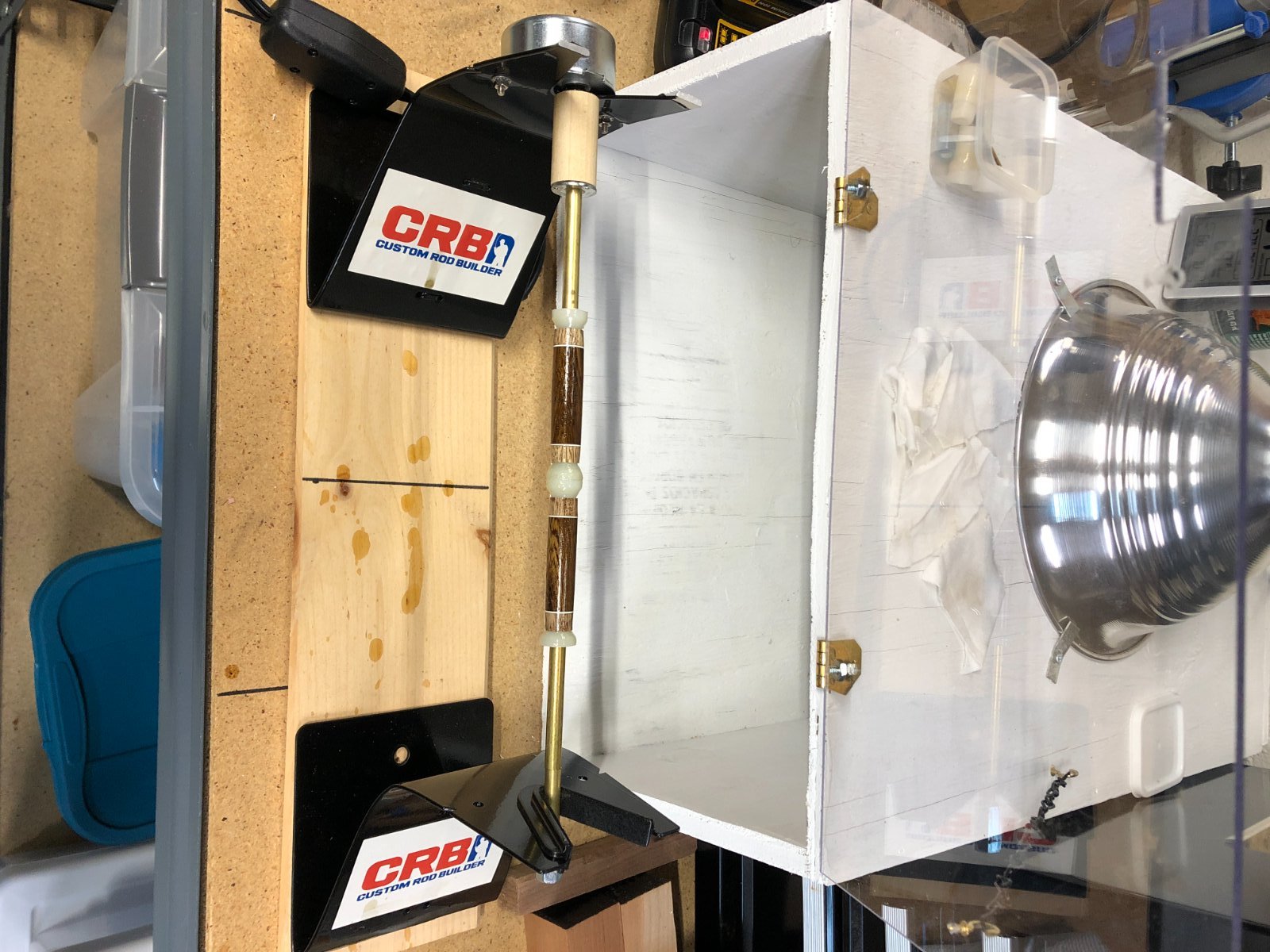

Wipe on Poly. I used this with good results for segmented blanks:
1. A slow speed spinner. 30-40 RPM.
2. Wipe on poly, thin coat.
3. Under a heat lamp for 45-60 minutes
4. Repeat 1-3 above. 4-6 times.
At times, I would let set for 24 hrs, then lightly sand, then repeat.
Sometimes I would repeat the Poly application every 1-2 hrs, for 5-6x. I went by feel vs instructions... ;)
This worked for me - your experience may be different.

Mark, thanks for sharing your technique. What grit sandpaper? Have used WOP on a couple of small turnings.
After applying several light coats, I would only want to eliminate any high spots. Usually 600 Abranet. After I got experienced with the slow speed spinner, I often did not need to do any final 'treatments' - polishing, buffing, etc. after the final coat. It was time consuming, but I usually liked the process as much as the end result; I was just having fun. This is also why many of my segmented pens were 'one offs'. OK, I figured that design out, onto something new.
This was where I got my spinner from: https://mudhole.com/collections/rod...6UP5nqyy1-rj_ULYAqBZnCvdzwT5HuGGVG2GJSe4pHHZR.
