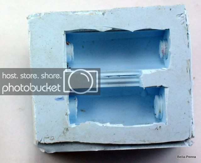

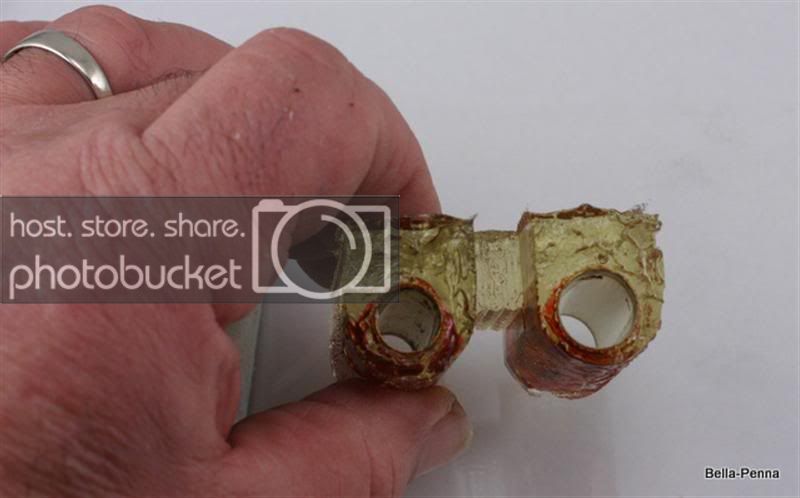

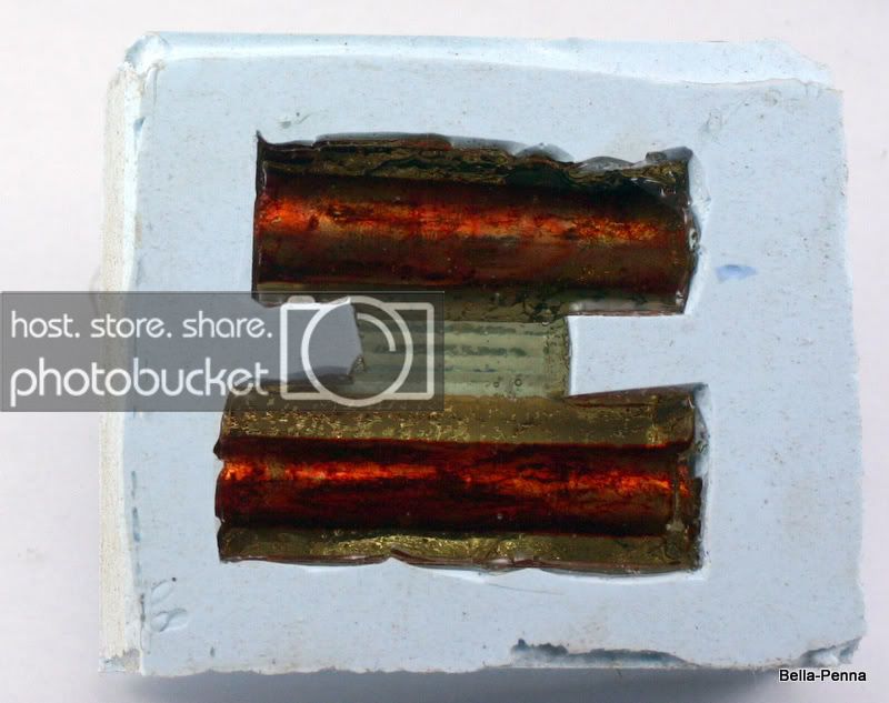

A few weeks ago Charlie (NewLondon88) wanted some Beta testers for his idea of a mold that you would not have to have to use corks, or stoppers, also would not have to fill with BB's or clay to keep the resin out of the tubes when casting skins, labels or any other tubed casting.
As everyone stepped backward one step I fell asleep and remained where I was so I received the mold a week or so ago and just now had a chance to test it.
This mold was a prototype and only held 2 tubes for one pen. It was not made for resale and was rough looking but functional.
I was skeptical that under pressure the built in stoppers would keep resin out of the tubes. I usually fill my tubes with clay and use corks glued to 1x1 thin strips of wood (cut up Paint stirrers). The mold eliminated the use of clay, corks and 1x1's and as a side benefit 50% or more PR.But would it work?
It's been a little cold the last few days so I heated the PR in my toaster oven to get it thin and pourable as water thinking that the thinner the pr the more chance that it would seep into the tubes under pressure.
Mixed my activator, poured and placed into the pot at 40PSI for 2 hrs. below are pictures of the final results. Not a drop of PR in the tubes.
Below are the results in pictures:
First the Mold:
Told you it's a prototype:wink:
Second, the pour:
Still not impressed?
3rd removal of the finished casting and looking down the tubes:
Not a drop in the tubes and ain't that a good looking hand? Now for the finished casting made into a pen:

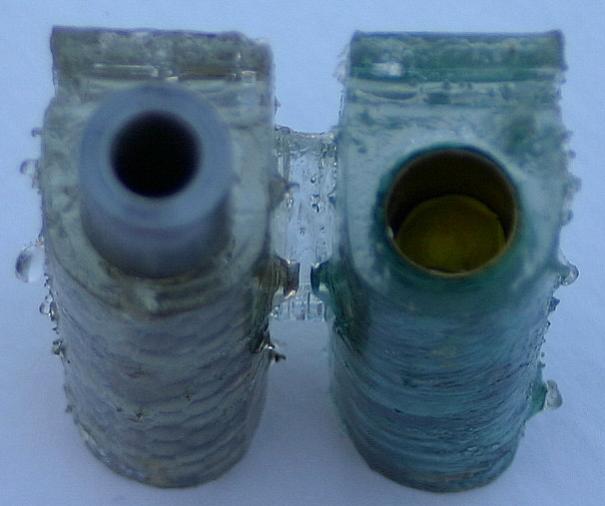

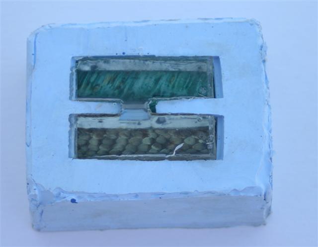

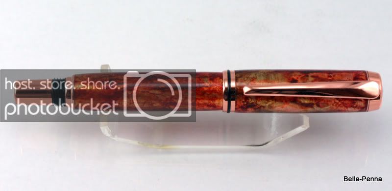

I also tested the molds ... the molds I tested were for the sierra and Jr's. I made two casts with each using snake skins, except for one sierra and I cast a dyed blank that had been turned previously. The molds worked fine. The entire concept will save me the time of (1) inserting corks and the wooden standoffs, (2) purchasing corks, (3) cutting the wooden standoffs. There is plenty of resin thickness as can be seen with the picture with the sierra bushing inserted. I liked the idea and await the molds with more capacity than just one pen. Thanks Charlie for working on these.
oooo .. another use I didn't think of .. like Neil's re-casting.
So .. you cast a dyed blank that was already turned..to give it a PR finish?

Don, did you overturn a dyed WOOD blank and then cast it? If so I'm intrigued how the heat of the PR as the MEK heated the resin affected the wood. It would make for a tough finish.....

I did over turn the wood...just below the bushing. I've done several this way. Some of my firsts casts were with wood "skins" instead of snake skins. The stronger the grain pattern the better the effect. We know how the curved surface of the polished resin magnifies the skin pattern...it does the same for the wood. The nice finish over the wood is an added treat. I've not had the curing heat adversely affect the wood. This particular blank was a stabilized blank that I found in my cutoff bucket. Give it a try sometime. I think you'll like what you get.

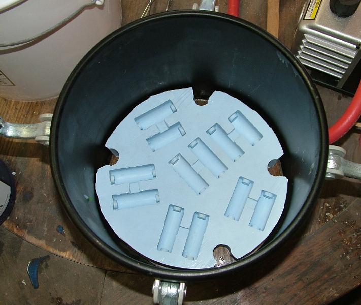

Getting closer..
Still need to work out a few refinements, but almost there

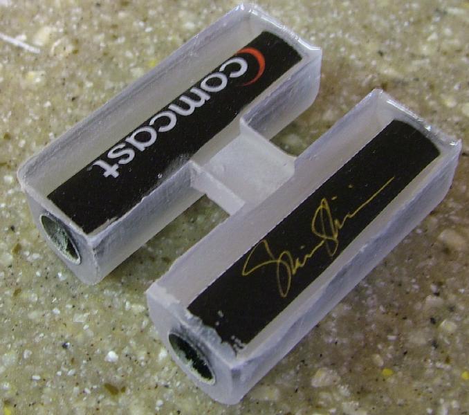

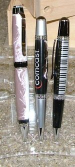

Tried my own mold..
Finally got to try out one of my own molds for a real pen instead of
just test casting. Worked fine and I didn't even get any bubbles.
Scanned a friend's signature to put it on the pen and that came out OK
.. tried a homebrew ,too. Kinda looks like chocolate milk..

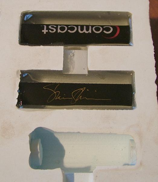

Got you on the list. I made some more this afternoon. Someone said to
dust the molds with talcum powder. Didn't make sense to me, but I had
some powdered marble that is pretty fine, so I used that.
The edges of the resin (where it touches the mold) have been coming
out with a rough surface, but with the powder they come out smooth.
No bubbles, either!

My thoughts:
Great idea.
Love the rounded bottoms- always thought the square corners on molds were a waste.
This is a quick brainstorm- the details may not work on some of
these ideas.
In your future molds, can you have text in them saying what kind of mold
and how many oz/ml of resin each cavity takes? (I've started doing this on my
molds - at least the oz part just because I don't cast often enough to keep
them straight otherwise)
I'd like a smaller (and cheaper) - more like the prototypes mold. Or would someone
be interested in splitting (literally) one of these?
Future molds could be laid out a little differently to make them easier to cut up.
Are the round cutouts in the mold edges just to reduce excess mold rubber,
or are they designed so you could stack multiple molds in the PP at once.
(I'm betting a stiff board of some kind would be needed as well, but you don't
want to stick layers together)
If not, would you consider such a feature for future molds? Maybe a semicircle
depressions at 3-4 points where a marble could rest. (marbles instead of legs
on the board because 1. flat boards store easier 2. you could put the marbles in
first and not have to worry about exactly lining up the legs )
Do you have a plug for the bridge between the two cavities?
I'm envisioning the case where I want to cast one half a pen w/ a label
and use something else for the other half, or do different colors for
the two halves. (and can't tell from the pictures if it'd be possible to
fill the cavities so they're deep enough but don't flow through the bridge)
NewLondon88
Local Chapter Leader
May 15, 2008
5,077
Claremont NH
My thoughts:
Great idea.
Yep .. wasted resin.
these ideas.
I've sent for an ID badge to be engraved. I didn't think about the oz, but
there's so many pen types that it would be impossible to keep them
straight if you had more than a couple. The ID badge would go into the
master so the mold would come out with the name and my info if you
needed it.
LOL .. I haven't even gotten my first check yet, and already
you're changing it. FWIW, I just made a smaller version this afternoon, it
holds 4 pen kits. The big round molds were made based on requests
from testers who do production runs.
Both. It reduces the silicone a little (and at silicone prices, anything I can
do to bring down the cost will help) but the main reason was so that users
can make a shelf to hold the molds and stack them in the pressure pot.
A piece of 1/2" plywood works fine for a shelf, and it IS necessary to have
at least one.. even if it is only for the rounded bottom of the pressure pot.
But by putting the cutouts on the sides, you can put something there
(dowels?) to stack them. I pictured the dowels going up to the top, where
they can connect to handles to lift them out of the pressure pot, similar
to the arrangement Curtis (MesquiteMan) made when he gave away a
complete setup for the Bash.
FWIW .. you wouldn't need this with Alumilite. It sets up so fast, you
wouldn't have time to pour and then stack molds before it set up. :eek:
(I'm betting a stiff board of some kind would be needed as well, but you don't want to stick layers together)
At almost 4 lbs per mold (empty) I don't think marbles would do any good
at supporting the molds .. or more accurately, I'm not sure the silicone
would support the weight of other molds on top of the marbles.. it might
just push it out of shape. But that's something I'll look at.
fill the cavities so they're deep enough but don't flow through the bridge)[/quote]
Frankly, with the amount of resin you save with this mold, the tiny bit
used to fill the other half is negligible. I just cast 4 Sierras this afternoon
and I used 52 grams of Alumilite. If I remember right (others who cast
often can correct me if I'm wrong) I was using around 2 ounces per pen
when pouring them in Tupperware containers with corks, BB's and wooden
stands to hold them up. So .. about 2 ounces for 4 pens compared to
8 ounces. To cast two pens, half of a bathroom Dixie cup is going to be
too much resin. Looks like about a 75% savings in resin. Not such a big
deal on PR, but on a polyurethane resin, it's significant $$
There's some good ideas here for the DOOHICKEY MOLDS. :biggrin: I'm still
working on my first customer order, I'm not really locked into anything yet.
