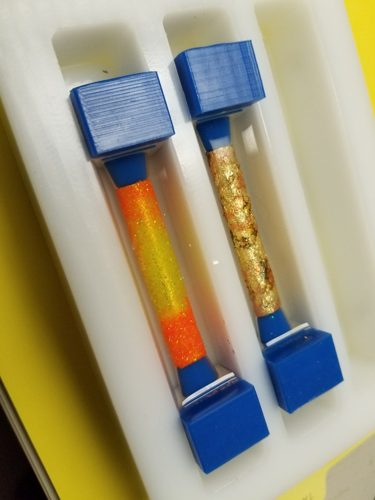

I've had a chance to cast maybe 30-40 blanks with these over the past week. I'm a big fan. I'm not doing tube-in casting but the way I create my blanks lends itself to single cavities rather than a big block mold. I have used them with and without mold release using Alumilite and have no issues getting the parts out. Though my method may be a bit unique... I pull the plugs out and tap on a tension rod from a drum into the hole there. I'm sure a wood dowel would work too but where's the fun in that?
The quality of these over a pink silicone mold is immediately apparent. I suspect we'll see CNC machined HDPE take over the marker for that reason alone. After 100 blanks or so I was getting curved blanks from my silicone and I know that won't be a problem here. My package included the 2 tier tray and I love it. I can say the round base plate fits just fine in the Grizzly paint pot.
Eventually I'll do some tube in casting but I've been so busy making my diamond cast blanks that I haven't gotten around to trying it yet. I think you'll be very happy when yours shows up!

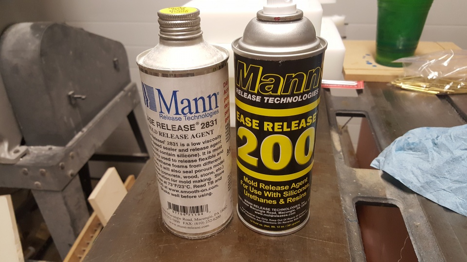

Got my package about five days ago. Cast my first blank with great results, your tube holders really save the PR and seal very well. I purchased a mold release spray at a local plastics company, is there a brand that you recommend, this one worked but was a little hard to remove from the mold.
On the road back home!!
I prefer Mann's Ease Release 205 or 200. 205 if casting with inserts because it is wax based and doesn't cause the inserts to become slippery.
Thanks!!
Tom
Dummy me. I sent this last night on the road. Ease Release 2831 is the wax based agent I recommend.

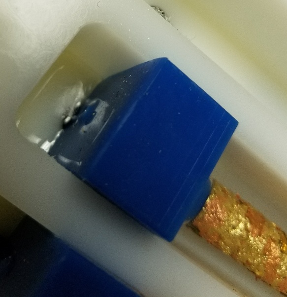

I did have some seepage, but I will try your suggested wax base release. Few raps on the back with a dead blow and the blanks fell right out.

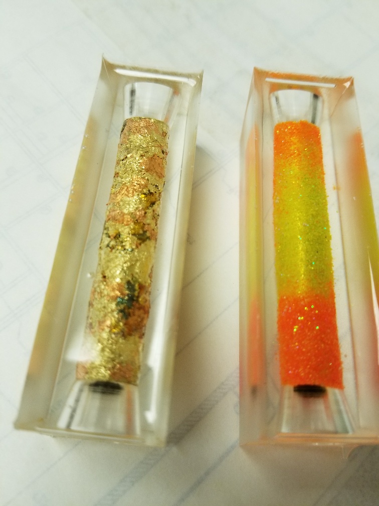

Hi,
The blanks look great.
Did you use a pressure pot?
