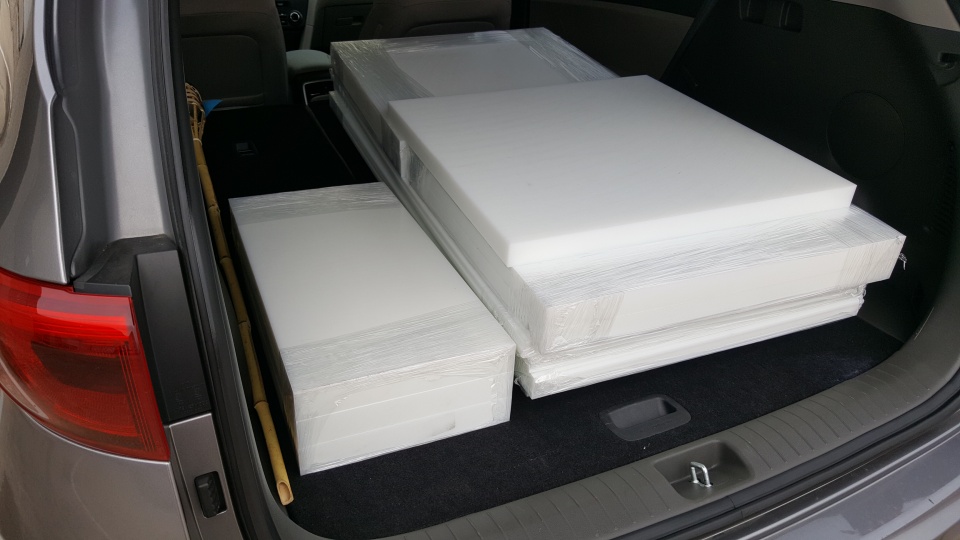

I picked up a big batch of HDPE yesterday. It doesn't look like a lot from the picture but there was enough added weight on those back tires to give me concern for the drive home!

OK, questions. I thought resin didn't stick to HDPE so why the strong recommendation of a mold release? Is it because of the machining marks?

Resin WILL stick to HDPE, it just won't bond to it. A release agent helps relieve the stress of demolding but more than anything it protects the silicone inserts and rubber plugs. Trust me, I've cast thousands of blanks in HDPE using mold release and compared to no mold release the experience is night and day (especially for full length blanks).
The machine marks won't cause much trouble for demolding, especially since the side walls have a slight taper. It's an aesthetic thing for me. I don't like them and want them gone as much as possible. Unfortunately I can't get rid of them all. They are a byproduct of CNC milling. Those aluminum injection molds you see don't come off the machine with mirror finishes. They have to be sanded and polished extensively, which is why they cost a fortune to make!
Thanks!!
Would it better to use a plastic that it doesn't stick too? Is it a cost or strength thing?
For doing a lot of full blanks I have been using the sandwich box from Sistema. Not sure what type of plastic it is, says PP on the bottom, but Alumilite pops right out, not fuss. I get about 6 5/8x5/8 blanks out of it. It's possible it is an entirely different type of plastic that can't be machined however.

I looked at other materials, including delrin, but HDPE by far offered the best bang for the buck. Delrin molds would be priced at least twice that of the HDPE molds and as a result would be less appealing to the average caster. My goal from the start was to make a something that would outlast silicone molds but it had to be priced at a point that most anyone could afford. Long term, HDPE molds will be much less expensive than silicone simply because they won't have to be replaced every few months.
There's a good chance that sandwich box is made from polyethylene. Keep in mind that sandwich box is also flexible and you take advantage of that flexibility when demolding, whether deliberate or not. HDPE molds are very rigid and thus require a bit more coaxing to remove the blanks.
Now, Alumilite is probably the easiest of the three major resin types to demold. You could get away without using a mold release if it weren't for the rubber plugs and silicone inserts. Any spillage between chambers or down the side of the mold can be peeled right off with a fingernail. Same goes for PR, easy to remove.
Some epoxy resins are a little more challenging. Liquid Diamonds is a perfect example. That stuff is really "sticky", which is a good thing. It bonds better than other epoxy resins I've used. Great for tube-in casts and bonds well to wood or bone. But, when you try removing spillage on top of the mold it takes twice the effort used with Alumilite.
Same goes for demolding the blanks. Full length Alumilite blanks will drop right out of the mold by lightly rapping the bottom a few times with a rubberized dead blow hammer. Full length Liquid Diamonds blanks will take a few extra more forceful raps.
