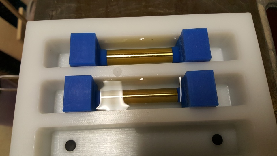

Tom, question.......Liquid Diamonds is extremely thin, I've had minor issues casting in silicone molds and I'm sure it's operator error. My question is when using Liquid Diamonds in your molds, are the stoppers tight enough to avoid leakage? I don't want the end up having 1/2 of a blank.
Yes! The inserts are precision designed for the mold chambers to avoid leakage. Here's a picture I just took using water along with 10.5 and 12.5 tubes. No mold release applied, I just dry fitted the inserts and poured water to the top. No leakage!!
