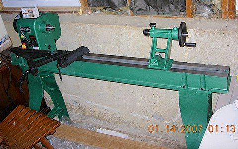

I can't believe I was able to get this much machine for such a low price. Jim set my lathe up for me today and it's an awesome brute. I had a Delta Rockwell 12-36 and I thought that was a good sized lathe, but this (it's a GO462, 16-43, with 2hp, with a rotating head stock and a lever controlled speed (not quite VS, but close enough for me) Grizzly erased any misconceptions I had about my Delta.
I just wanted to thank Jim, for setting it up for me. There's no way I could have done that myself. It was great hanging out with you today.
Also, thank you, to Bob Yost (thumbs), for telling me about this lathe and price. It's exactly what I was looking for.
Here's a lame shot of the lathe:
BTW, I won't be using that curly cherry board at the bottom, for a foot rest. It was just put there for perspective. This thing ia more than 6' long. Jim also gave me some great ideas for set-up and use. I've got a buffing system, that goes on the lathe and he had a good suggestion for that. This thing cost less than $500, delivered. I can't wait to use it. It even has an articulated tool rest and a speedometer, or whatever you call it).
The pic is taken in my new turning, finishing and assembly shop. I can't wait to use it. Thanks for looking.

I too think that is an awesome lathe for the price. I am curious about their 2HP claim and would like to hear what you think.
Re: the tool rest. Be careful using that extension arm...if you make a mistake, it can damage your banjo. Use it only if you have to. My (now sold) Jet 1236 have one and I never used it. Just FYI.

I got that lathe last year. Pretty cool, but the low end of the speed range is still a bit ovver 600 rpms. Also found that the tailstock needs to always be pushed/pulled in one direction as it is locked don to insure proper alignment with the headstock.
Wish I had a smaller rest. The one included is massive and I can't fit it in between the head and tailstock when doing pens.

Can you explain what you mean about the alighment a bit more. I'm a bit dense sometimes. Jim recommended that round bar 3 piece set of tool rests, that so many of the pros seem to use. I would love that, but it wouldn't be as good as a regular one, for hollow vessels, as it puts the support 1/2" back, or so. Still, I don't have any desire to do those, so it'll be perfect for me.

I wondered that myself, but it's 14 amps. My table saw is 3 hp and it's 18 amps, and it would rip my arm off, if I let it. It almost did once. Anyway, 14 amps seems to be plenty of amps for 2 hp. I was telling Jim, that I'm worried that it won't be enough power to turn anything bigger than a slimline.[:eek:)]

I forgot to mention, that I only put the extension on for the picture. Jim showed me how it comes apart and It works great for me without it. I also have a floor stand, that Jim figured would be great to rest my arm on. I always lean on the lathe and I'm constantly worrying that it'll grab my sleeve and suck me in. That happened to a friend of mine in Jersey last year. He keeps his shirt shreds tacked up on his wall, as a reminder.

Grizzly gets a lot of knocks because their products are made in China. News Flash, folks, a lot of companies have their stuff made in China, they just don't discuss that fact. Griz tools, IMHO, are the best value for the money anywhere. Your new lathe is super great for the price. At about $100.00 LESS than my older model Griz, the 1067Z is is a far better machine.
There was a discussion on Saw Mill Creek about the horse power rating. I got responses from Grizzly on that and am satisfied that it is a legitimate rating.
However, as mentioned, the slowest speed is 600 rpm making it risky to impossible for large, heavy out of round turning. For 99% of what most of us do, however, it is a WINNAH! Congrats Rob.

Jim showed me about the alighment problem. The head stock can twist a degree or so, if you don't lock it down the same way each time. I matched centers up, to align it, but there's a locking mechanism he told me about, that ensures it's done right. This is because the head stock rotates/swivels for outboard turning. It does have a click that says that it's set right, but I didn't find it the first time and I was 1/8" off.

I upgraded to this lathe just under a year ago after starting out with a Harbor freight 12X36 special. It's a great lathe for the money but it does have a couple of shortcomings.
1. As mentioned above headstock and tailstock alignment can be off a bit at times. If you know to watch for it you can correct it easily.
2. Also mentioned, the slowest speed is about 600 RPMs, way too fast for roughing 16" bowl blanks. There is a slight modification that can be made to reduce the minimum speed further, contact me for further information, but it's still an adventure roughing anything large or not quite balanced.
3. I've had to replace the tail spindle already. It was replaced under warranty with no questions asked.
4. I encountered a problem with my motor earlier this week. Grizzly has a replacement on it's way right now.
In addition to the modification for slower speed I mentioned above I also have the headstock legs bolted to the floor and have a 2X4 and plywood shelf running between the legs. This shelf currenly houses approx 400lb of playground sand.
The new G0632 looks tempting with the electronic variable speed and reversible switch but if i'm going to spend ~$1500 on a lathe I'd reather save a few more pennies and go with the Powermatic Mustard Monster.

Motors are of course just machines and all have different efficiencies. NEMA, (the USA National Electrical Manufacturers Assoc) state that motors upto 4HP need to be at least 79% efficient to be NEMA rated. No matter how good it is, it will never ever be 100%. There are electrical, magnetic and mechanical losses inherent in all motors, and that is before you get to the pulley gears!!!
Some basic maths using Ohm's Law show us that Volts X Amps = Watts.
(In Europe we use Watts more than Horsepower)
To convert Watts to Horsepower ; Watts X 0.00134
So if we have a 110Volt machine that draws 14Amps load from the supply ( Unloaded ) Then this motor is 1540Watts or 2 HP.
Now we have to assume that as these are domestic lathe motors and not some critical part in some hospital, then we can't expect more than 79% of the 2HP, which leaves us with 1.6HP, before we lose even more from the pulleys. Next we need to consider the source of the motor and the standard that was used to measure it's efficiency.
I doubt that it is as good as a NEMA rated one.
I'm not knocking the lathe in this thread, as it is ten times better than mine and I wish it was in MY workshop, just pointing out what the dealers don't tell you.
Like I said, probably useless, but maybe interesting[:)]
