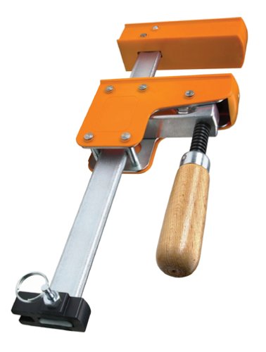

IMO, your better bet is to go with a small cabinet clamp. You can get a high quality 24" Jorgensen Cabinetmaster for $38 or so. You will have much more control since you will be using a screw mechanism, it will work for all pens you want to make, and it is usable for other things in your shop such as clamping up sgemented work if you get into that.
This is what I am talking about:

Curtis, i think that's what I saw when we were at your place then Icouldn't rember what it was. that's what youwere using. I ahve bunch of calmps like that ,but i was wonderig the one in the pic is more accurate than the HF and Stanly's I've got?

Phillip,
I was not aware the HF or even Stanley made a parallel jaw clamp like this. I know they make clamps but a parallel jaw is completely different than other clamps. That said, what you have will most likely work regardless.

Sorry,didn't notice the parallel jaws that i don't think I have. I have to look into that.

Hey Curtis, I've started using my Bessey DuoKlamp (or however it's spelled). I squeeze to apply pressure and can very precisely control it. Parallel faces like the one you showed, but IMHO easier to use than twisting the handle while trying to keep everything lined up. Either would work nicely. Some wood stuck to the jaws protects both the jaws and the pen's finish.
I have tried all kinds of things, but good ole clamps seem to do the job easily and painlessly.
