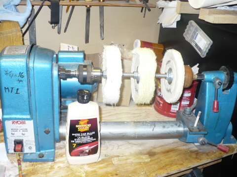

Yup. A 1/2 x 2 or 3 inch bolt & nut. Slide buffer wheel over bolt & tighten nut against it. If the buffer pad spins between the retainers, stick some CA glue in there. Use your scroll chuck or drill chuck. You will need to back it up with the tail stock to keep it from working out of the MT. After final assembly I usually buff the pen on it.

I posted a complete make your own Beall system a while back. Not very expensive but works really well.

bradh
Mar 9, 2005
688
Aurora, Ontario, Canada.

I use a old pen mandrel and three 4" buffing wheel. Cost me $13.00. Look under finishes I post how to do it step by step under another guys Buffing thread he just posted today. Its cheap eazy to build and works great.
