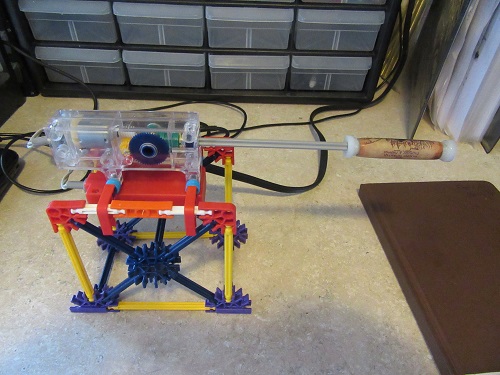

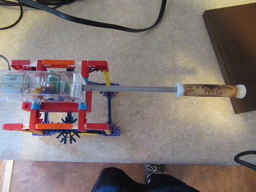

Out of everything I have learned and heard from the MPGS to the Hartville
meetings and on the forum people have a slow speed drying rack for finishing
Mark James was a excellent piece cheap and affordable.
This hit me last night or the day before. As a child i played with KNEX that
my parents got me fun stuff it also has a slow speed motor which goes
forward and reverse and a off switch. I was tyring to think of were you could
get these motors for cheap and I had one all along for free and the rods KNEX
use are exactly 7mm mandrel size so blanks work on them perfectly.
View in Gallery
View in Gallery
Who would of thought a childhood toy I played with would be a finishing tool
for pens
The blank was just to test the mandrel thats already done and ready for a
kit.

It would probally melt I would only use it for ca or laquer finish because knex is plastic so i would not attempt it

I would tape the excess rod with any kind of tape to protect it
from any excess drip from the finish or if your messy
