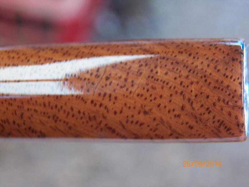

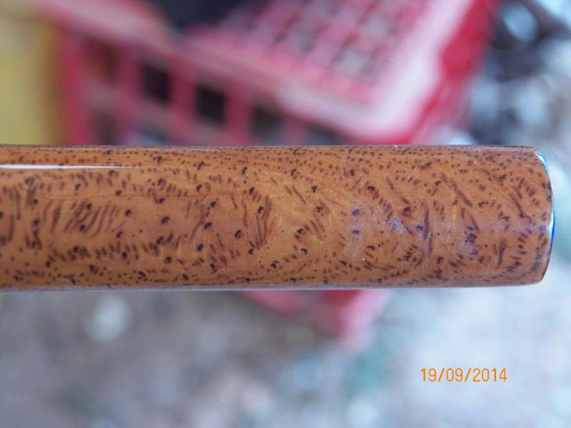

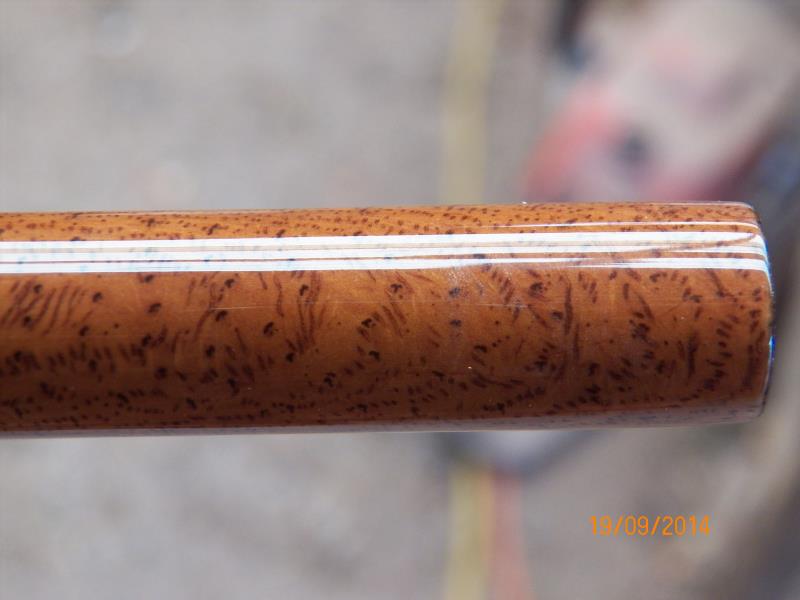

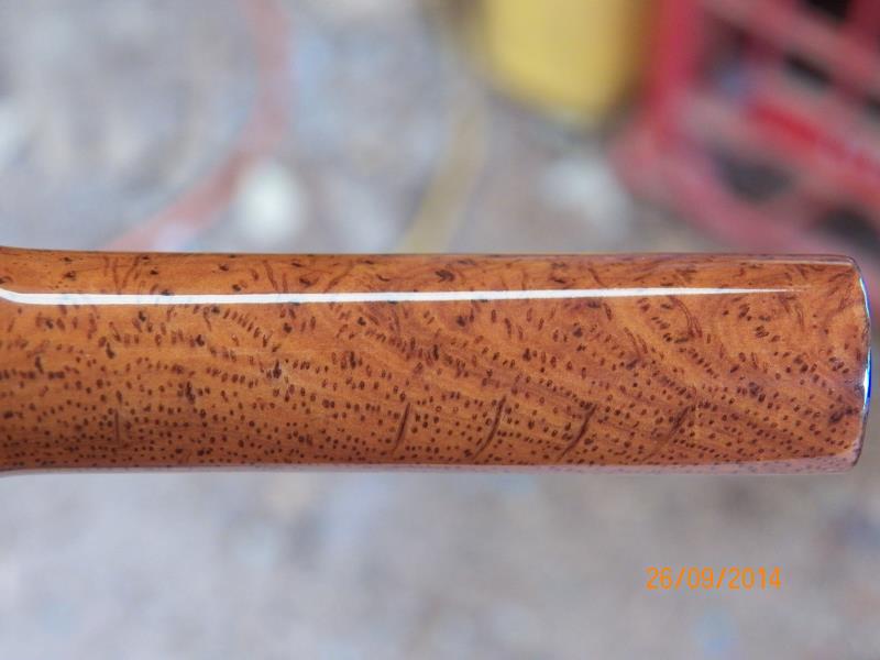

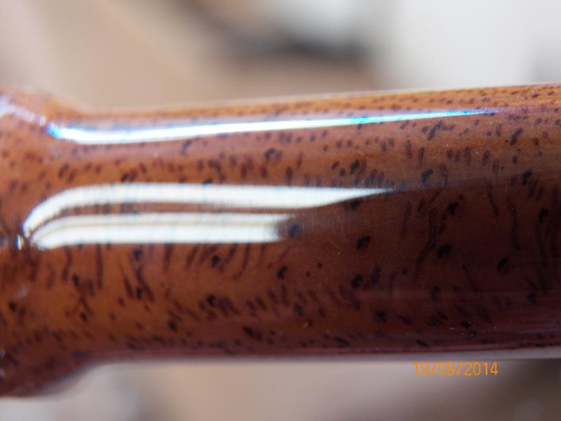

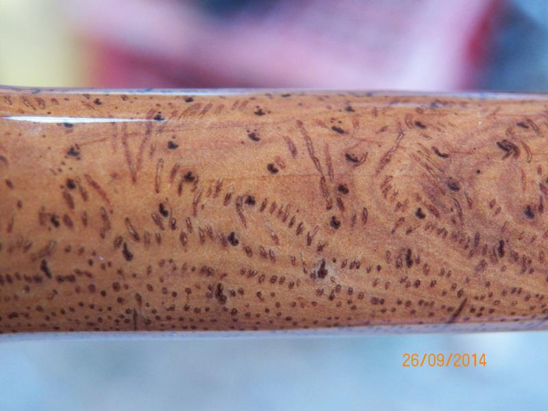

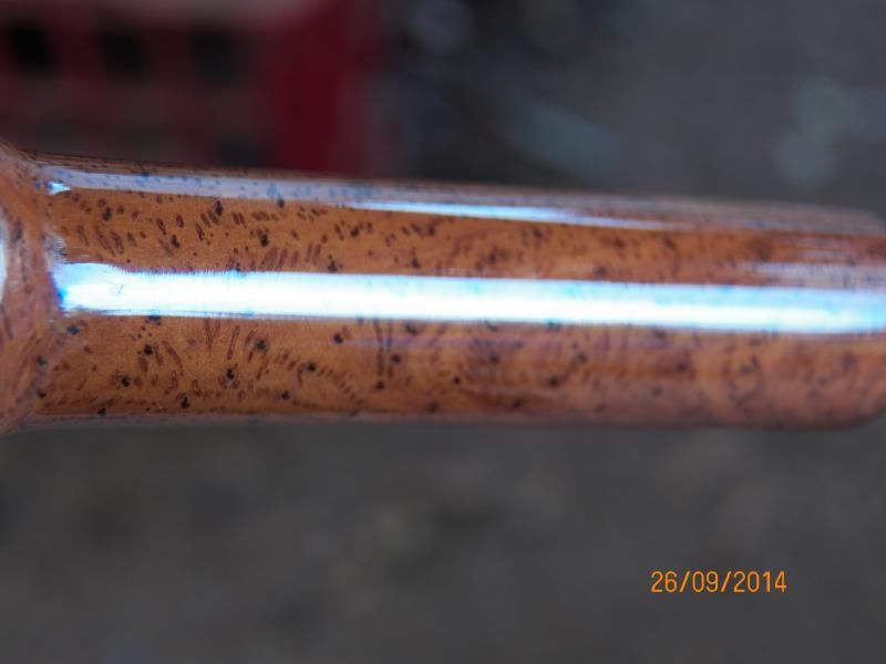

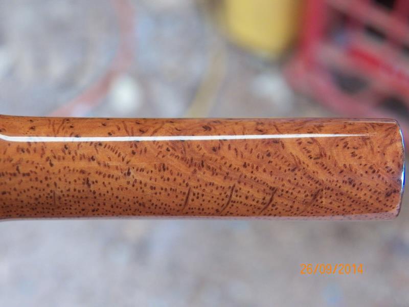

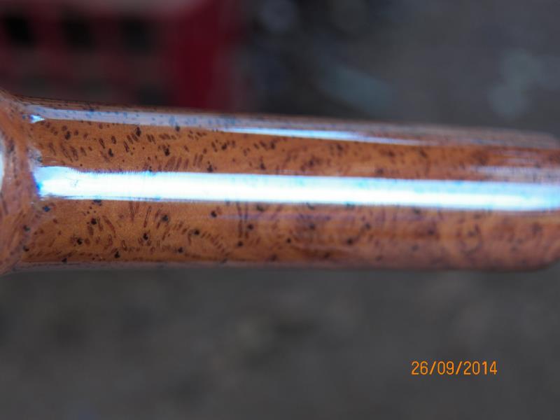

Well Bob, too late mate, I posted them (7) + a gift blank, this morning...!
I have left the turning of the sample a bit too late this afternoon and when I finished it, was almost dark so, I didn't have enough natural light to take a few close ups so, I will do it tomorrow...!
I was a bit surprised when I read your post, the sample that I made looks pretty good, in my eyes and surprisingly, the first 2 thin CA coats I apply to it, not with the applicator but with the lathe off and covering the area with the CA and then smooth it up with the finger while rotating the chuck manually, the wood soaked it quite fast and furious, a little sanding and 6 medium coats followed by 2 thin coats, sand and polish...!
I got the impression that, after I finished the first 2 coats and smooth it up with 600 wet sanding manually, the surface felt extremely hard and smooth, I felt that at that point, I should have give it one more thin coat, and polish, sometimes less is better but, I continued on as normal nevertheless I felt that I passed the ideal finish barrier, anything over, could change its adhesion and performance, with peeling or all the other things your experienced so, its done so, I can't go back, well I could but is not necessary...!
Lets see what this one does, the wood is beautiful and if if holds, you know you have another 7 workable blanks to use at some time...!
And if all goes to $#!t, at least we tried...!:biggrin:
Oh..., I have no doubt that the wood has some chemical component that bleeds out quite easily, that has been my claim from this testing's, sometimes I can reverse its negative results sometimes but rarely, I don't...!
