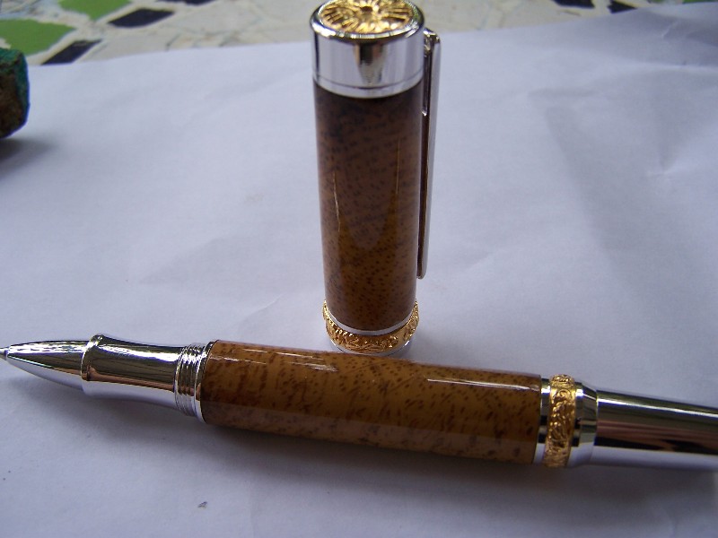

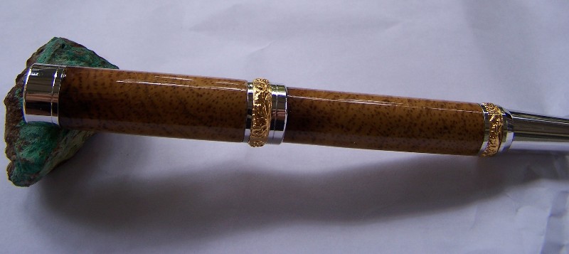

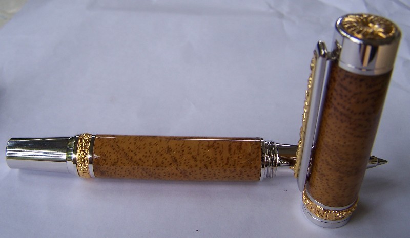

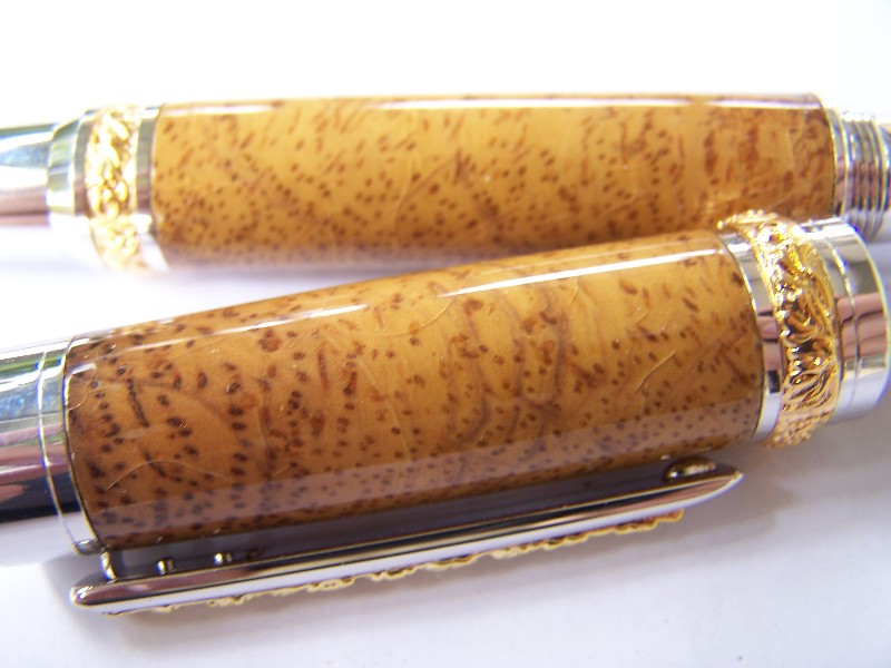

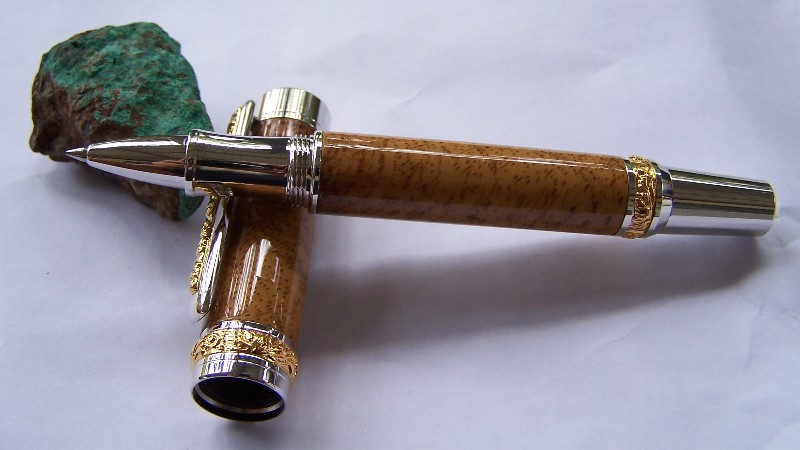

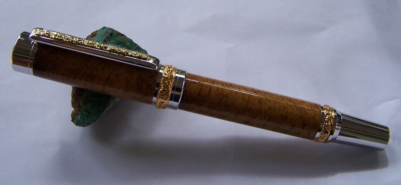

This started off so well, and I was really happy with the result. That is while it was sitting in the packet for several days. Then I decided that I would do the photograph thing and post it here.
Even after taking the close up photo I didn't notice what had happened since it was assembled.
When I loaded the photos onto my computer it was quite devastating to see all the cracks in the CA finish.:mad::mad::mad::mad::mad:
Oh well, I know that it has happened to many of you, but this is the first time for me, and now I know how you feel.
Oh well, take it all off and start again, but I will use a different wood this time.
As usual C&C welcome.
Thanks for looking,
Bob.

That's a real bummer Bob. It's amazing how things like that can happen when you least want them to. It is a shame, because it would have made a nice looking pen.
Have you had trouble with Grasstree before ?
I am doing a commissioned pen set as well at the moment, I have had to recast three blanks so far, I think I have got it beat now thank goodness, but it was starting to get annoying for a while there
Do you think those cracks could be from assembly pressure? I barely have any experience with CA finishing, so I may be way off. I am just guessing.
That's such an awesome pen it would be a shame to dump it. Refinishing is an option. I did it when I had cracking issues. Turns out my issue was "old" CA. Suggest you get a fresh batch.
I doubt that the cracks are from the assembly. You can see them all through the cap piece with no connection to the fittings on the end.
Bob, I have no experience using that timber (although I'd like to). Have you used it before? About the only thing I can think of is a big change in temperature. I know it's cold where you are now, and I wonder if was left out in a cold shop after the CA was applied. That is just a guess though. So far I've never had this happen with a CA finish (knock on wood).
An additional thought Bob... If this commission is going International, with changes in temperature, you may want to consider a different finish.
Many folks appreciate the feel of wood vs a CA, and many "woodturner's finishes" will stand up to changes in the wood swelling and shrinking with changes in temperature and humidity (I suspect you knew all this already!).
Just a consideration. :wink:
Hi Bob,
You are correct, there is nothing to do with assembly, but I have only done one other pen with Blackboy and CA and I looked tonight and that is cracked also.
So the possibilities are old CA, and the wood, which is quite soft. I applied one coat of thin CA and then 12 coats of Med. CA and then sanded to 2400 and buffed with Tripoli and white diamond.
Bob.
Hi Mark,
Yes this was intended for International purposes.:smile:
Thanks for the thought.
Bob.:smile:
Bob,
Tough luck on the finish. I just had an Alt Ivory blank blow up on me (first time ever!) and the pen I was making was the most expensive commission I have had to date, for what is a (rather impatient) doctor and return customer. I felt awful telling him there would be a delay.
I know that many here use medium CA for their finish, but I have had much better luck with thin only and I put about 5 or 6 coats on, then sand level and do another 6 or so. My finishes aren't going to be as thick as yours but they look good and I wonder if that, combined with the potential of old CA, might be contributing to your problem.
Best of luck,
Think I agree with Eric . A thick CA layer takes a long time to fully cure . The cracks may be just shrinkage cracks occurring as the CA off gases and contracts , with the cracks showing up at places where adhesion of the CA to the wood is a bit poorer .
If you want to experiment , try a thin finish and your current finish , both taken to high gloss , on two pieces of the same wood , and check them out every week , for a month .
Thanks for the helpful hints guys, They are much appreciated.
I also made a "Snakewood" pen on the same day as this one, the finish method is identical on both pens and the Snakewood has not cracked yet. I also made a Walnut pen at the same time as the first "Blackboy" one and that has not cracked either, so that tells me that it is the "Blackboy" that is the problem.
Temperature range has been in the vicinity of Min. 55 - 60F and Max. 75 - 85F over the last week or so. So I don't think that has anything to do with it either.
Looks like a different finish to me.

George, I'll do this here rather than by email, so everyone can benefit.
The wood is quite soft and powdery, all I did was drill and glue in the tubes with thick CA. Turned them down to size and sanded to 600 gr.
Then I applied a good thin CA coat to seal the wood. Then I proceeded to apply the 12 coats of med CA and then sand and polish as described.
I did not allow any time for any of the CA coats to cure?????????
Just applied one after the other with accelerator in between.
The Blackboy wood is only about 1mm thick so there was not a lot of wood to move etc.
What do you think?????
Bob.:smile:

George,
I noticed the cracks after only 3 days.
The CA is about 18 months to 2 years old.
The wood was very dusty, so it was dry, but could have had some moisture in it.
The other problem that I have discovered is that CA is the only process that leaves the wood in its natural colour. The bowls and other things I have made using WOP or Lacquer or Shellawax as a finish, have all resulted in a big degree of colour change, making the wood quite dark.
CA does not change the colour at all.
Even if worked and left in the open atmosphere for a week or so, it starts to go darker. I have no idea what will happen with the stabilisation process but I guess we had better give it a try.

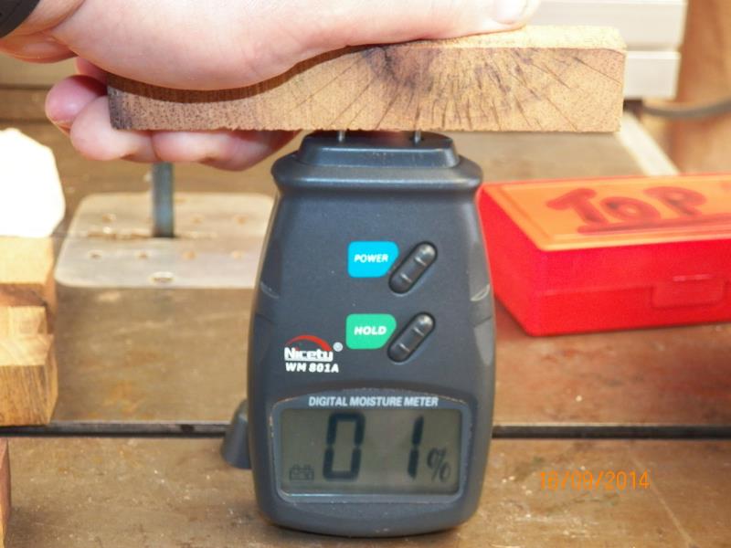

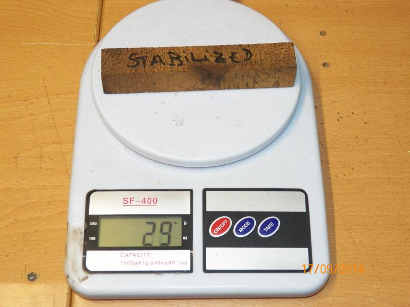

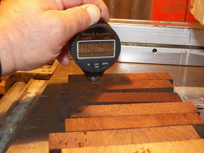

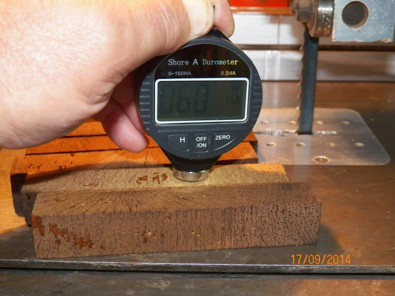

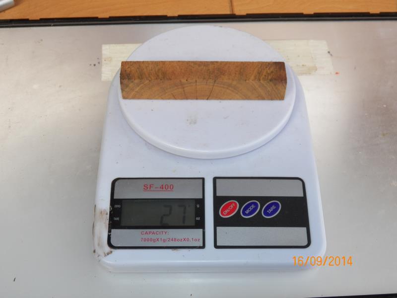

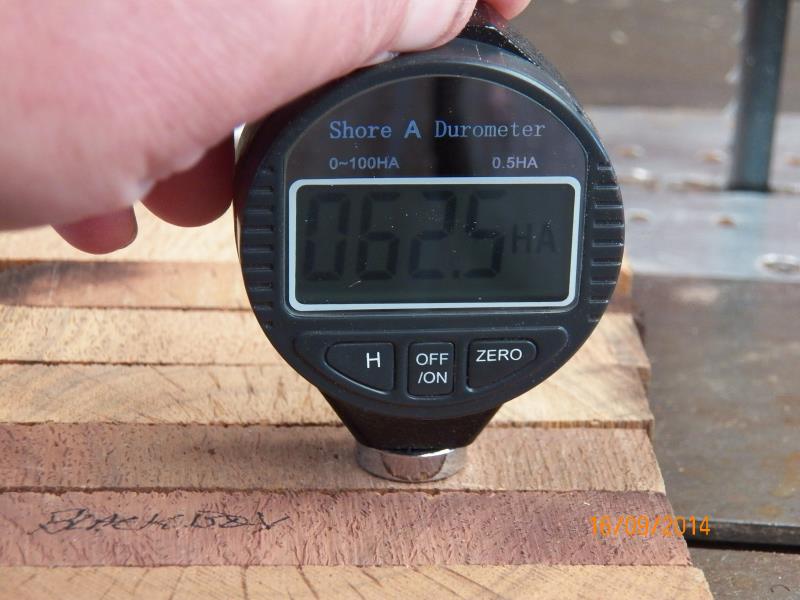

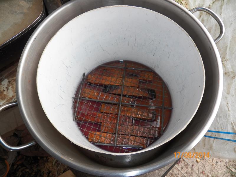

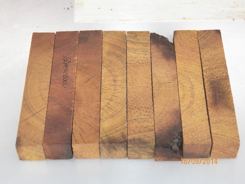

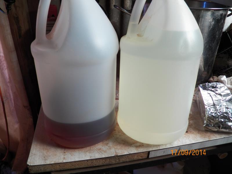

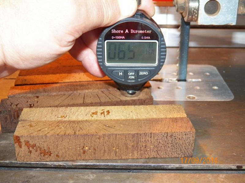

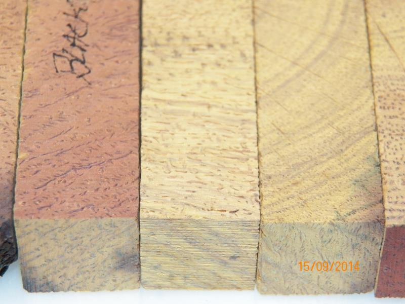

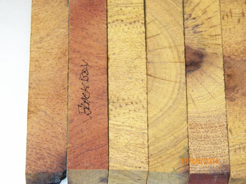

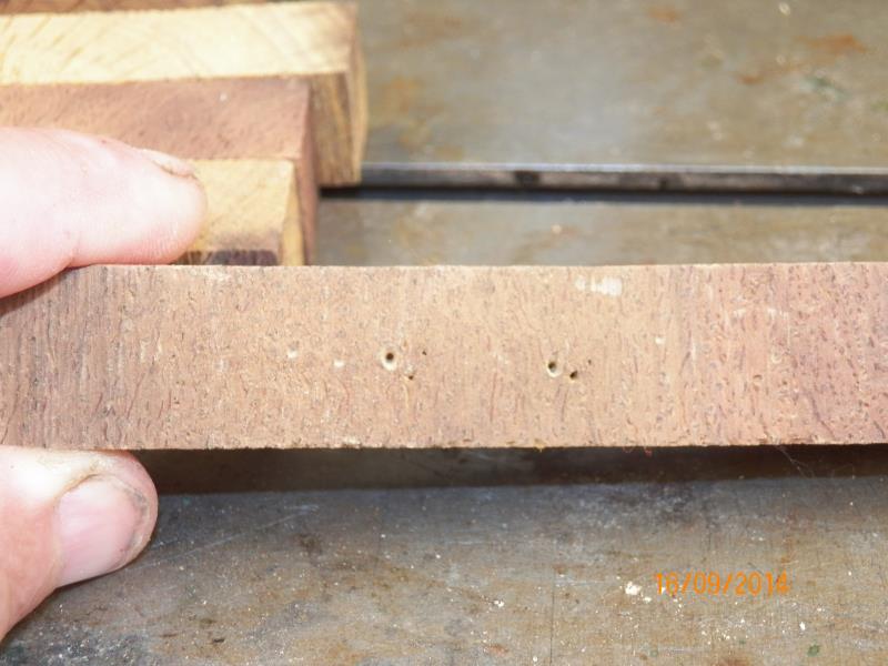

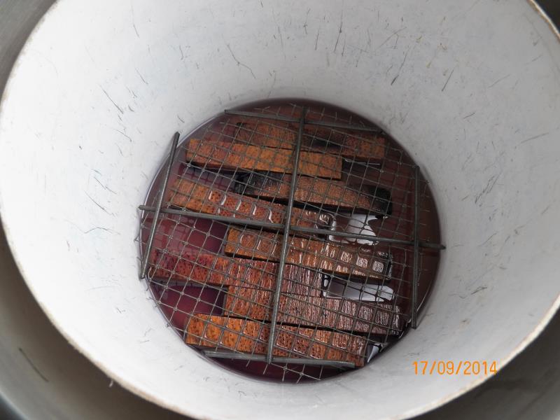

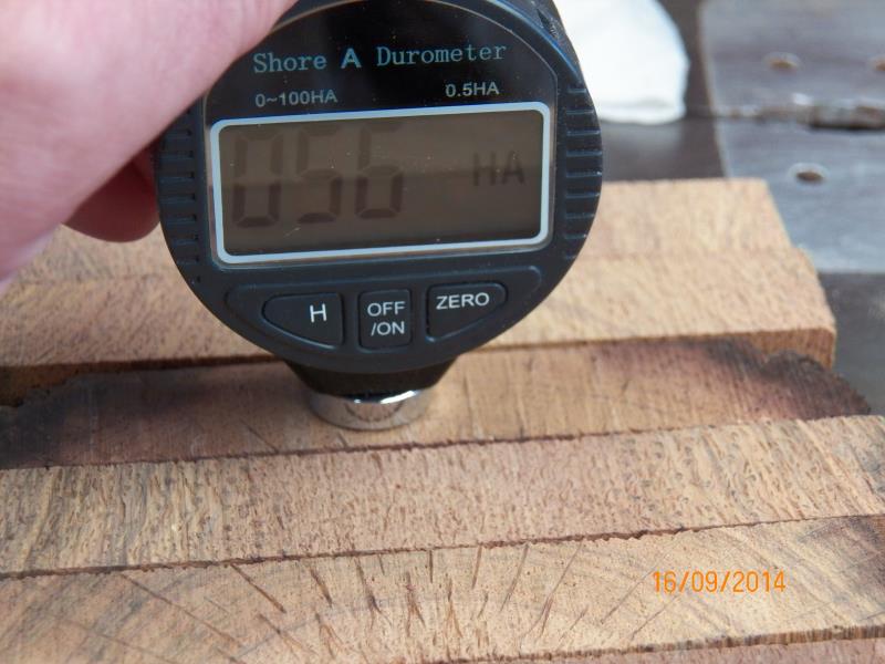

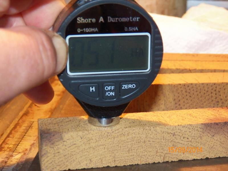

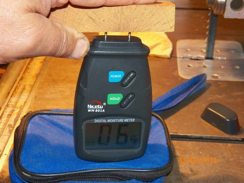

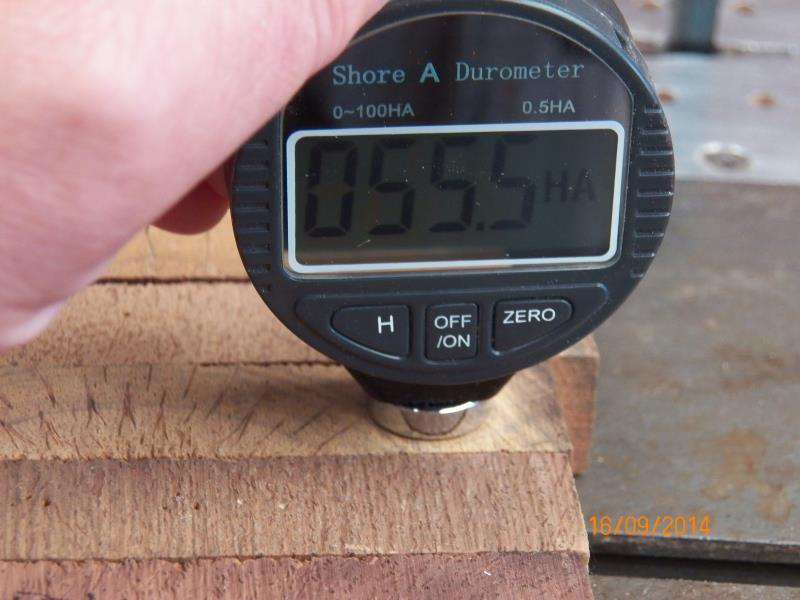

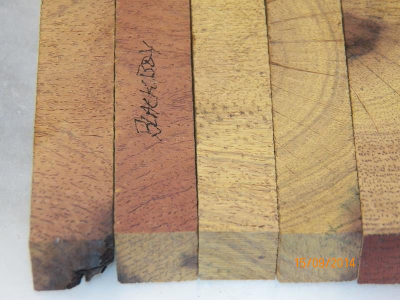

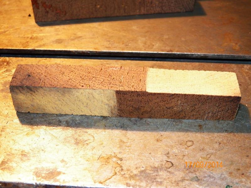

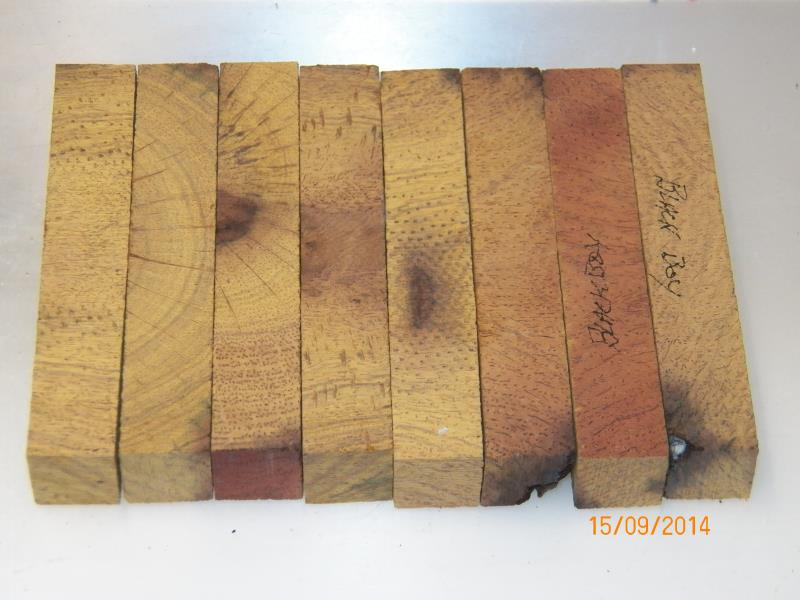

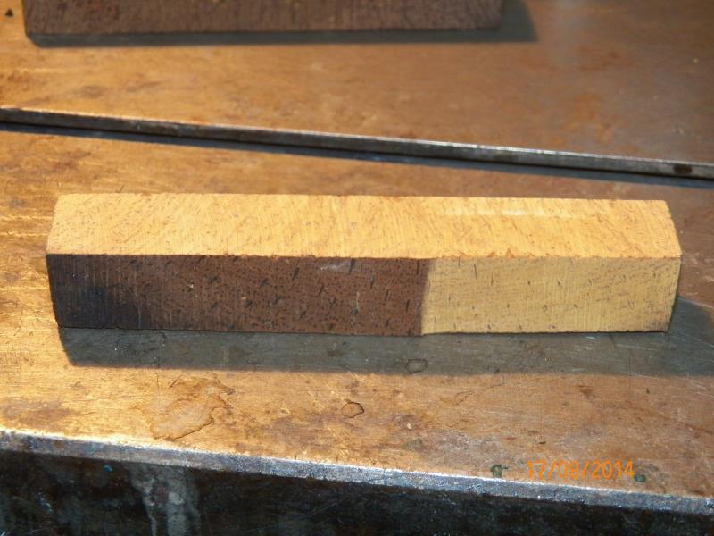

OK Bob, the blanks (8) arrived yesterday and I already done some checking before I put them in the oven, where they still are...!
I took good note of the colour change you mentioned and to allow me to compare, I took some pics before I done anything to them. I could see that, this wood darkens like the Mulberry wood does, exposed to light and air, it darkens quite considerably so, I took pics of some side that already show that darkness and them some pics from the "fresh" cuts...!

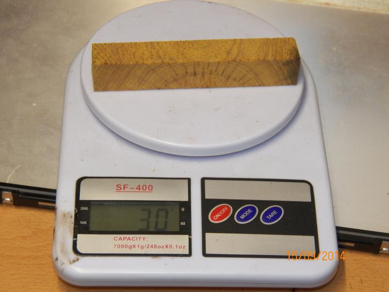

I then weigh them and there is a small variation in between then, a couple of grams either way, 007.JPG

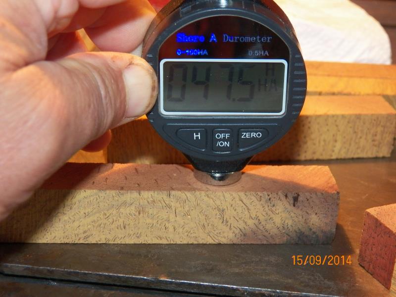

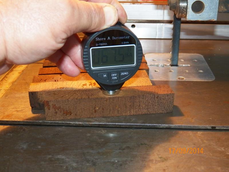

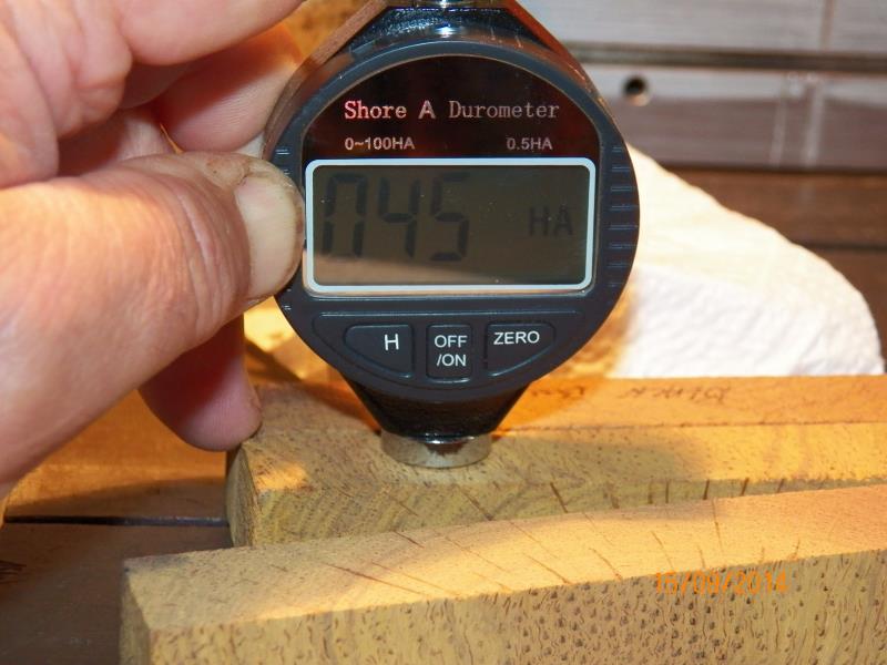

I then checked what my durometer (it says Shore A but is a B) readings were on its softness, I tested it in 3 different locations and this is the result, 018.JPG 019.JPG 021.JPG
In general, the wood is dry, and felt that way but that, we already know, huh...??? so, lets see what happens to the next stages.
The blanks had already 2 runs of 90 minutes each @ 80° celsius, and 2 runs this morning, I will give them another 2 runs this afternoon and then straight to the stabilising chamber, as soon as they get a little cooler/less hoter...!
The blanks are covered (not wrapped) with foil paper to prevent any direct burns to the wood...!

Test, part - 2
OK, the blanks were taken from the oven this afternoon after 6 runs of 90 minutes at 80° celsius so a 9 hours of oven time. The first thing I did was to weight them and see it was any loss of weight 013.JPG,
a small loss but a loss, 3gr average from 30 to 27gr so, what was that they lost..???, as they were looking pretty dry at 7%MC right..??? this is what they lost, 008.JPG 6%MC (moisture content). Where that come from...??? environment/air moisture...!
The blank probed was the very same as before and you can see from the indentations I made on the the second time around, the pins were indeed making deep contact, 011.JPG
Now, the colour comparison test seem to show that, the roasting of the blanks did not affect the colour, thanks to the foil protection, this is the pic taken of the group after coming out of the oven, 001.JPG
Before I put them in the stabilisation chamber, I took the readings again with the Durometer, why...??? because I knew that, when wood is toasted to almost 0% MC, the wood cells harden slightly, did this happen...??? you be the judge 004.JPG
I have so far, validated every single expected event, as I mention before a few times, the blanks are now under full vacuum, have started at 3:50pm and will be turned off about about midnight, the blanks will stay submerged until tomorrow morning, after of which they will be drained and let drain for the rest of the day, I should cook them sometime tomorrow evening.
The next day I will do a few simple surface colour tests to measure any difference, after that I will select the worse blank of the batch and I will turn it round halfway and then proceed with my normal CA finish, 2 thin + 6 medium + 2 thin, sand, polish it and see what comes up.
The time of turning/completing the sample will be recorded, along with ambient temp. and humidity, this first pic will be taken immediately and shown on this thread, I will use the super Macro function to provide clear details of the finished surface.
The blank will have an identical pic taken every 2 days, while the treated blanks (7) will be returned to Bob immediately. There will be about 1 week before he gets them back, in the mean time he and all of us, we can see the sample every 2 days and look for any signs of cracking, if by the time Bob get his blanks back, the sample performs as I expect it to, Bob will be safe to make is important commissioned pen and any others he may wish to do so...!:smile:
My commissioned pen is waiting for the kit to arrive from the USA (PSI), I couldn't find what I wanted on any of the Australian suppliers, not that is something unique, you guys have been using these kits for some time but, the correct plating, wasn't available here.
A simple kit with a couple of spare tubes + shipping AU$70.90 :eek:, I better cast something for the tubes that will make it worthwhile otherwise, I will get pretty wild...!:smile:
Anyway, we wait and see...!
Cheers
George
Test part-3
Well Bob, I don't think that my news are that good, it look promising but, the results are a little confusing and at the same time, a indication of something that isn't right with this wood.
After all those hours in the oven, I put them in the vacuum chamber and I deliberately use fresh Cactus Juice to see if the wood would stain it and how much. Why that, you would ask....! well, is a smell associated to the raw wood that resembles a small log that I found years ago and that, I also had problems with the finish I was using at that time, it wasn't CA but some gloss varnish, the varnish after dried, just cracked and peeled like a banana, this would be expected with oily woods in no preparation to the wood was made, the wood didn't have natural oils but, it had a natural sap that would come to the surface if the surface of the wood was sealed with anything, I didn't have the stabilization at that time so, I don't know how it would go...!
The first thing that I noticed when I poured the juice into the vacuum pot, the blanks were buoyant, and after being under vacuum for 6 or 7 hours, they were still buoyant (I had a weight pushing the blanks down while the pump was going) and that normally means trouble.
The colour of the Juice did start changing, as soon as the blanks were inserted on it but, after the stabilization done, my concerns were realised and the juice was well contaminate, and this is many times worse that the results I get with other woods, after the first use of fresh juice. I poor the unused juice in a container and put it side by side with a new container, and that was the colour I started with...!
Unwrapping the blanks from the foil, revealed another disappointment, the blanks didn't seem to have taken any juice so, I done the softness test again with the durometer to see if there was any difference, and some how, it was a small improvement of the wood hardness,
With the exception of 1 blank, all others seemed to have darken with the roasting, that was expected to a point, and if the roasting was done well, the wood would maintain its natural colour underneath while, if the good gets burt, the darkness is seen straight through the wood but, that wasn't the case here so Bob, you will get your blanks back with its natural colour preserved...!:wink:
And finally, I need to find out if the wood has taken on any juice at all, and this was the most disappointing result of them all, it didn't...!:mad:
Well, this is all I could do for today (well, is 1:00 am so, I started yesterday):smile:
The next step is to turn half blank and finish it as I will do on a pen (steps already described before). These Georgenized blanks, may not get the results I was expecting, too early yet to make a conclusive decision nevertheless, if there will be no improvements is because I didn't gave it a good shot...!
One not always get what they want...!:smile:
We will see...!
Cheers
George
