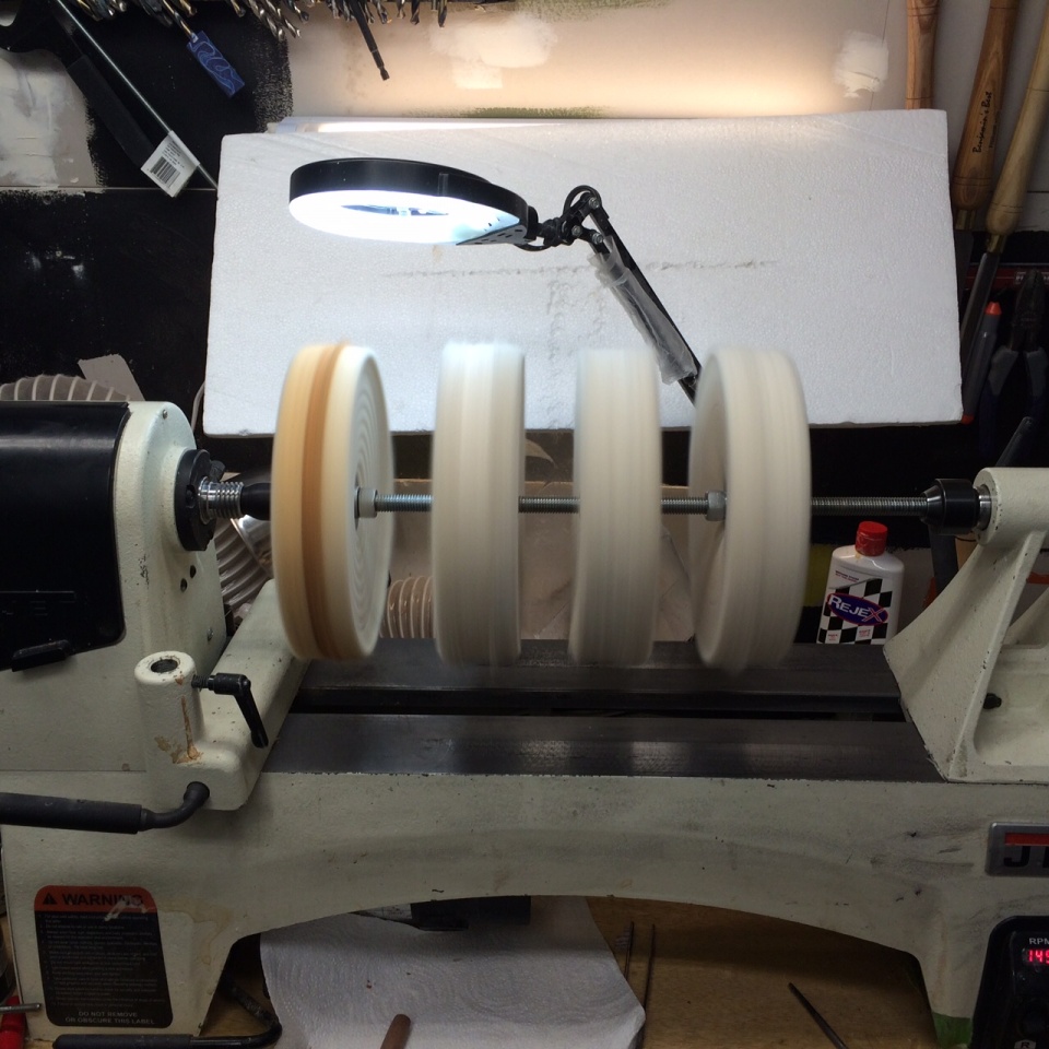

Left to right:
  1. Tripoli
  2. White Diamond
  3. Caswell 6163
  4. Caswell 6165
Then Meguiars 205 for residual compound removal, followed by Rejex synthetic wax.
I used this on all materials with excellent results.
I hope this helps someone.
Some asked for more details:
Turn pen to size.
Dry sand 320 (or lower if needed) to 600: reverse 500 rpm with Abranet or AO.
Go to Buffing Station: All 1500 to 1800 rpms (forwrad).
Left to right:
Tripoli: Fast Cut Greasy Tripoli Compound T-12 - Caswell Inc
White Diamond: Everyone has WD
Caswell 6163: Search results for: '6163' - Caswell Inc
Caswell 6165: Search results for: '6165' - Caswell Inc
12 Buffs (3 per compound): Canton Flannel Wheel 8" x 1/2" - Caswell Inc
I substitute 2 cotton sewn buffs around 1 canton flannel for the Tripoli compound. Spiral Sewn Cotton Wheel - 8" x 1/2" - Caswell Inc
I am sure there are another thousands ways to approach this. This is just what I happen to try.
Used 1/2 inch All Thread, 1/2 inch by 2 inch fender washers, split lock washers, and 1/2 inch hex bolts.
Made a wooded 2MT and drilled a 1/2 hole about an inch deep. Epoxied the ALL Thread into the hole. On the tail stock side, I removed the spur on the live center than came with my lathe.
I buff on the tripoli wheel until the surface produces a light orange peel finish. Everyone will have their own approach.

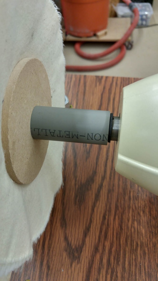

Have you though about how you are going to mount the wheel? I made a wooden 2MT with 1/2 inch female thread in the center about 3/4 inch deep. Then I used gorilla glue epoxy to glue in the 1/2 inch all thread. I was hoping a craftsman like Rick H would make a 2MT with 1/2 inch female thread.
Anyway, enjoy!
My buffer has a tapered threaded mandrel on each side that should work with a 1/2" center hole. If not, I'll use some 1/2" all thread and make a mandrel to fit in place of the tapered ones.

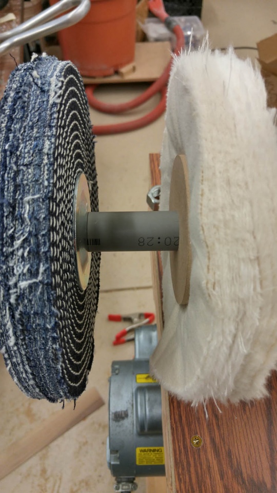

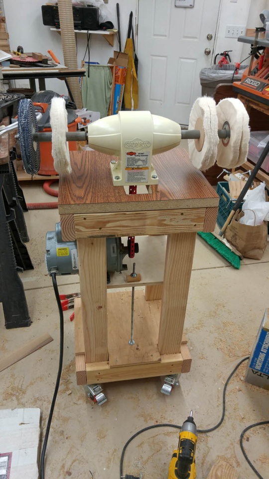

Realize this thread is a little old, but it inspired me in my buffer set up. I had decided to go with some Caswell buffs and the plastic polishes, but wanted to be set up for just about anything, not just pens. So I ordered the Shop Fox buffer arbor and picked up a used 1 HP motor from Craigs list.
Originally thought I could just have 2 buffs on at a time, then realized that with a little inginuity, I could set this up for 4 buffs like Tony's set in the OP. This will be great for pens, and I can easily swap down to a single buff on each arbor end for doing larger pieces or whatever.

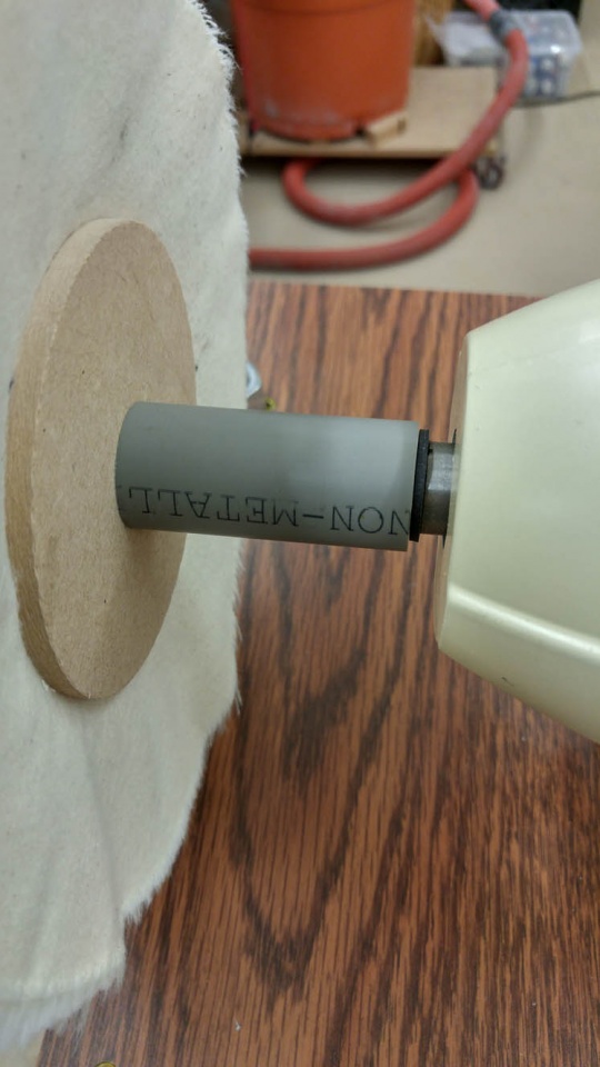

I found that by reaming out the inside of a piece of 3/4" pvc schedule 80 electrical conduit (just happened to have some laying around)with a 3/4" drill bit, it made perfect spacers on the 3/4" arbor. The spacers snug right up against the split rings next to the housing. I then made some extra washers to hold the buffs using some 1/4" MDF.
Still need to make some storage hangers for the buffs not in use and a place to store buffing compounds and stuff, but I'm excited to try my hand at buffing out pen finishes.

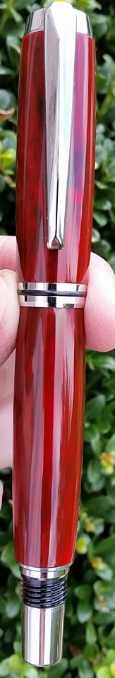

Hi Larry. I just finished 2 CA pens and one Hut Resin pen with it. I did experiment with a different brand of 3rd and final stage compounds, but that was it. The Caswell compounds are fine though. Here's the Castellar that I just finished and photographed 20 minutes ago.
Therefore, the answer is "no" for all intents and purposes.
"My" system is nothing more than added two finer compounds to the Bealle system.
I am using the same mops/buffs from a year ago.
PS. CA, I run at 1200 to 1400 rpms; PR, Alum..etc., I run at 1600.
