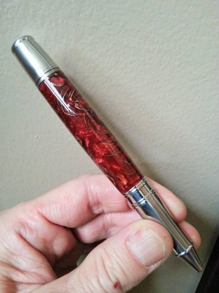

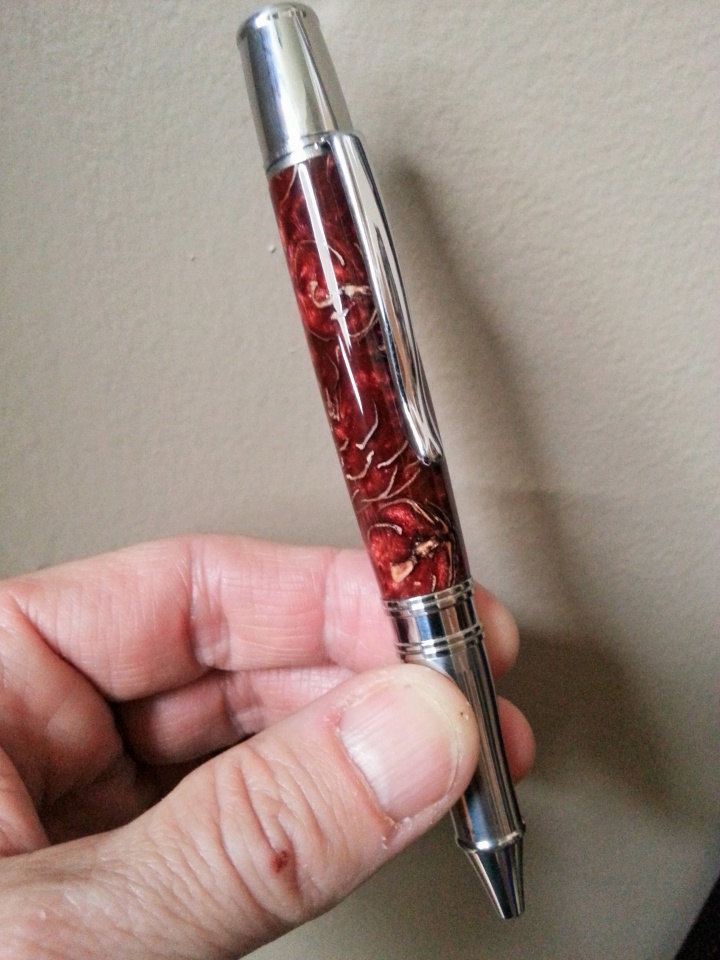

Here's one finished with plexi (per Chris' instructions) over a year ago. Once I got the viscosity right it was very fast and easy.
