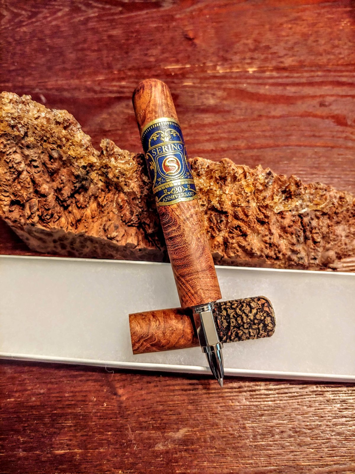

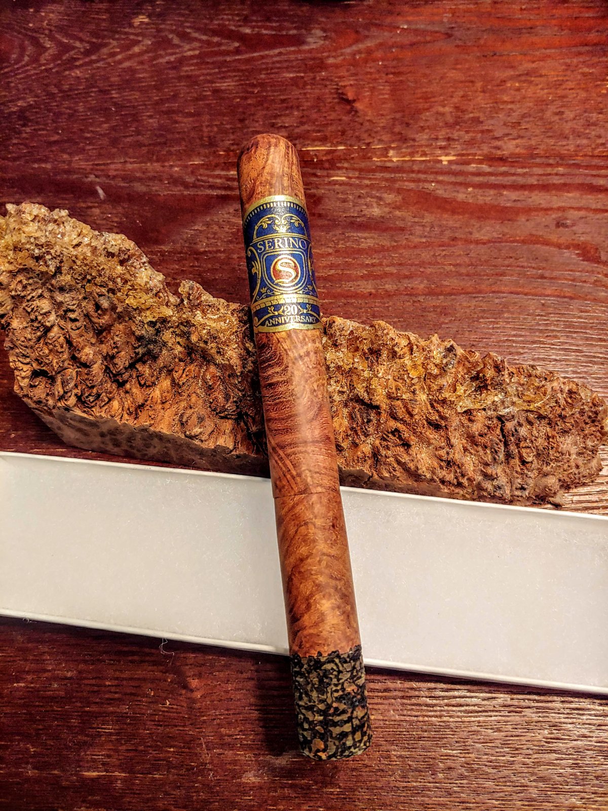

Here is the most recent "Cigar" pen that I finished. I used mesquite burl and dyed oak for the ash. I did the ash detail with my laser engraver. Would love to hear fee
dback.

Very Nice. I do have a question. I've built a few of those and I chose to make the cap the end with the label. I guy that helped me get started making them put the label on the pen just as you did. I'm not saying who's right or wrong or better than the other I'm asking your opinion. Do you have any particular reason for making the ash end the cap and the label on the pen? I liked the label on the cap so hat if the pen is used to write with the label won't wear from being used. My friend said he just liked it better. Just wondering what your thoughts were. Thanks
Joey that cigar pen is really realistic! If I can ask I would like to make them and would you explain the kit, the blank, dimensions, and how you did the ash. Sorry you said everything but the dimensions and the kit that I could see. And thanks for sharing this.

I have done a couple the other way and found that for some of the larger bands the best positioning for looks fell where the cap would separate, so I started doing it the other way.

The kit is the magnetic vertex. The blank size for the mesquite is around 6"...you can get away with a little shorter and a minimum of 3/4 in sq. I generally use a piece about 1 1/2 long for the ash. For the ash detail I held it under my laser and just moved it around by hand.
