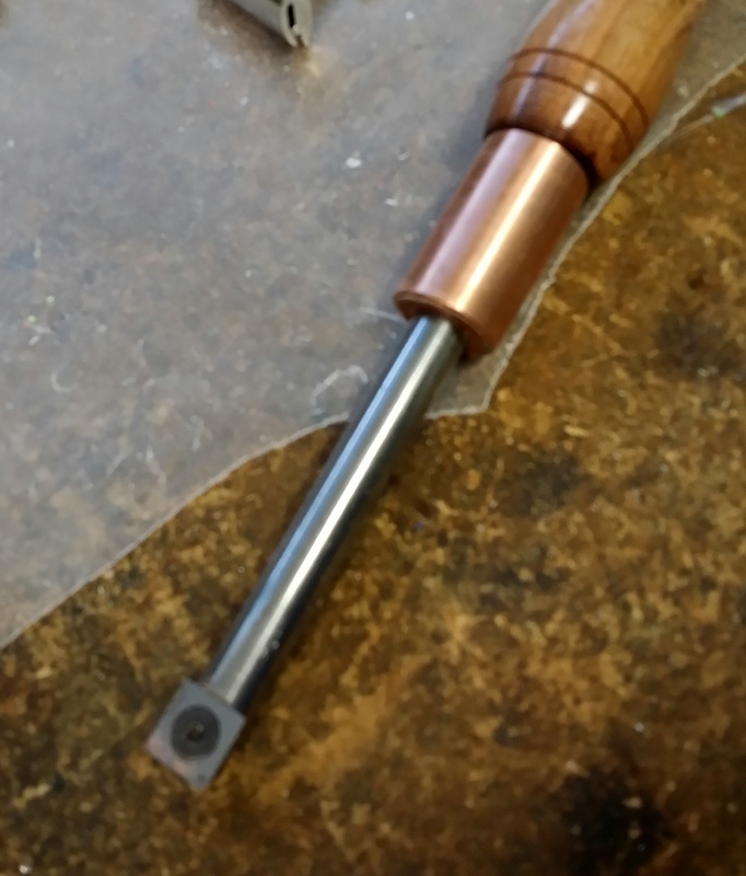

I agree. I use both hss gouges as well as carbide. I use the 3/4 inch gouge for rounding up blanks and carbide for general turning. The attached photo shows a 15mm carbide insert. It is mounted on a round half inch shaft. The round shaft allows the cutter to be used as kind of skew. I will be changing my ETW gouges over to round shafts. In addition the round tools slide across my tool rest more smoothly.
