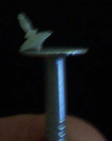

wanted to see what I could do with the end of a pen blank.
trying to create as mini unique things that as I can;
yeah; a little off center, the end was not straight but it gives it character.

I bet that was difficult. How did you mount it to turn? One thing I noticed is the base is larger in diameter than the cup, should be the other way around or equal.

it was mounted in a set of Nova Pin Jaws. However, there wasn't much for it to hold onto. My son, said; "Dad, your crazy it's going to fly out of there". With it not being very straight the vibration was crazy.

Good job on the mini! Are you trying to mount the whole pen blank? I turn mini's a lot and I use the nova 4 jaw chuck to hold the blank and just have enough sticking out that I need for the piece. www.mwwoodworks.com
Also, when I turn a pen, I usually have a little chunk left over. I superglue that chunk to a piece of corian that I mount in the chuck and turn. I have also found that I can make better tools for mini's than I can buy. (From nails and dental picks sharpened with the dremel.) I have just started experimenting with sub miniature spinning tops. the smallest one I have thus far is (crap! was) 7mm tall and 5mm in diameter. It even spun. :( The last time I spun it, I timed how long it turned and I got about 20 seconds out of it. Not bad for something that tiny! LOL (Notice the change to past tense. I just broke it trying to take a good picture of it.)
