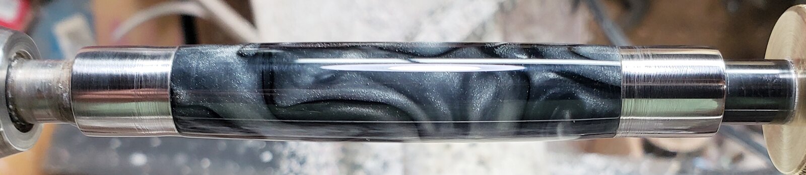

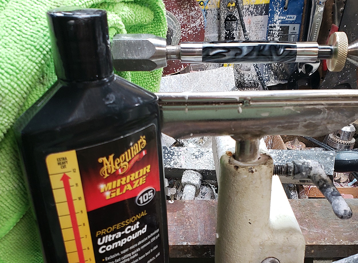

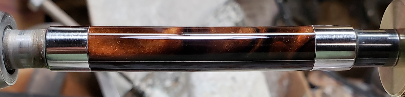

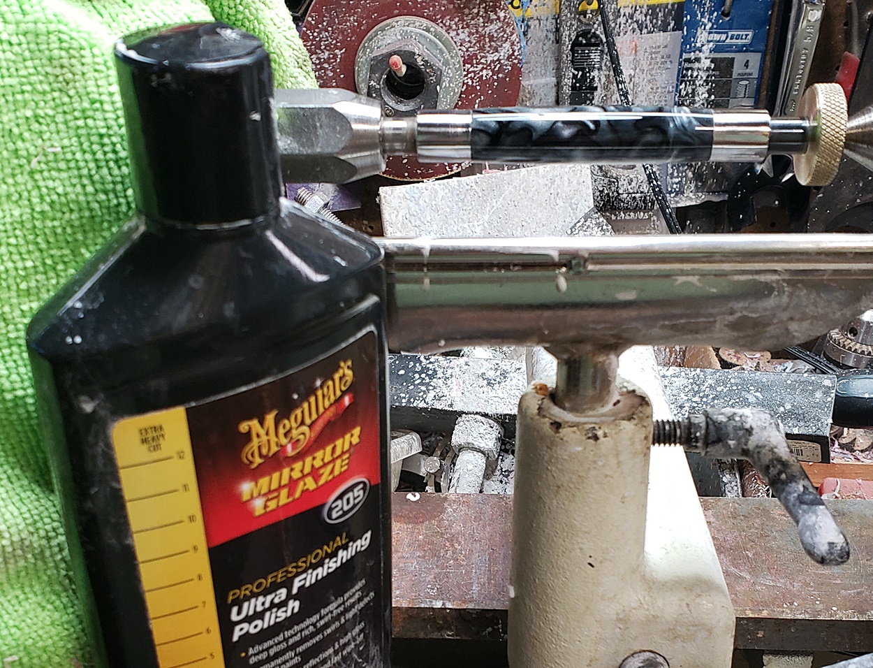

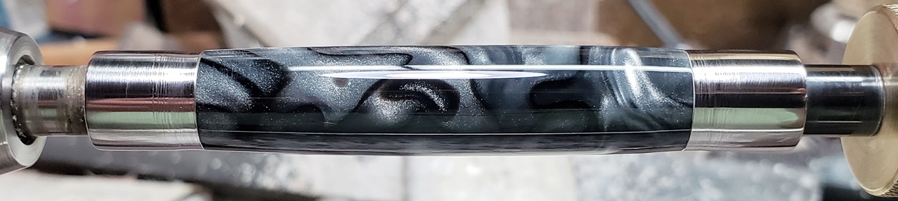

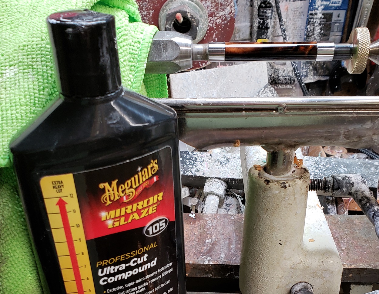

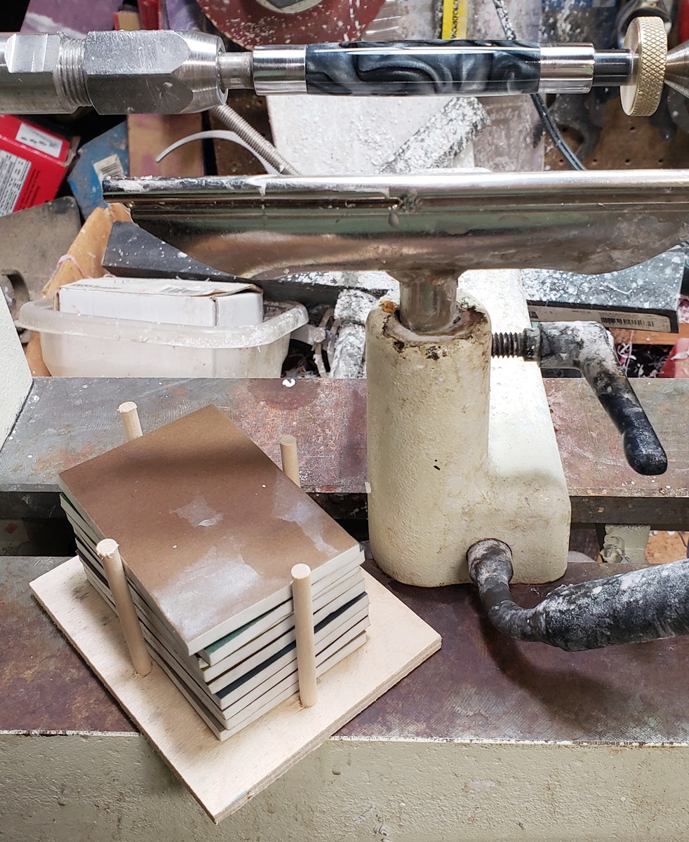

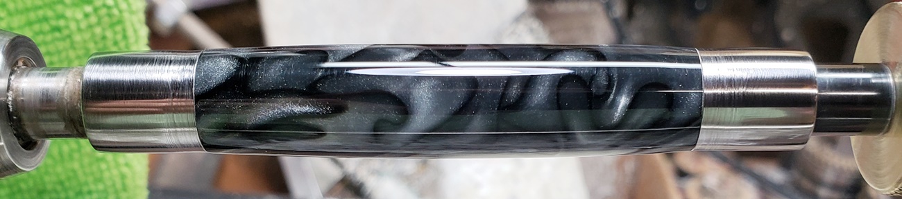

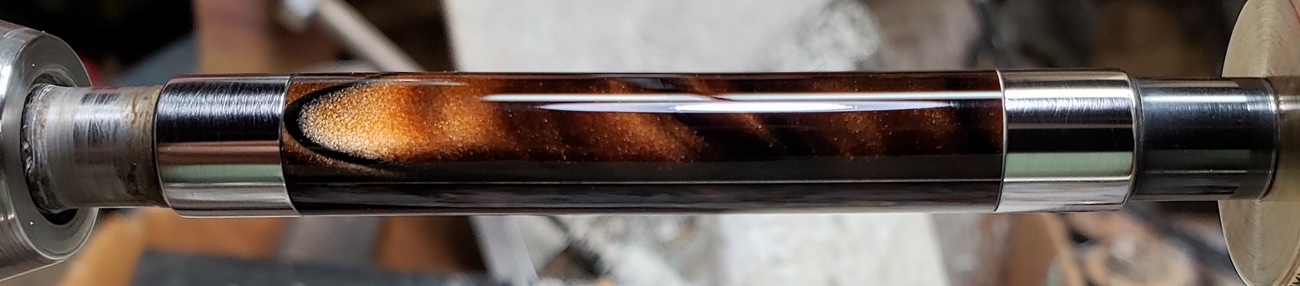

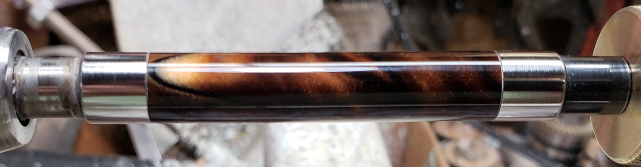

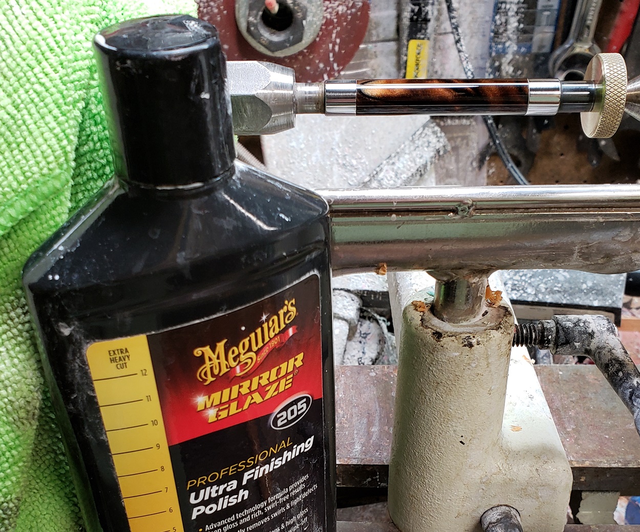

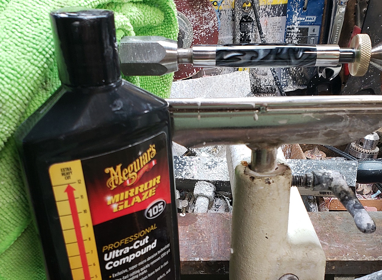

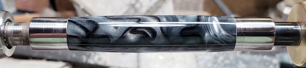

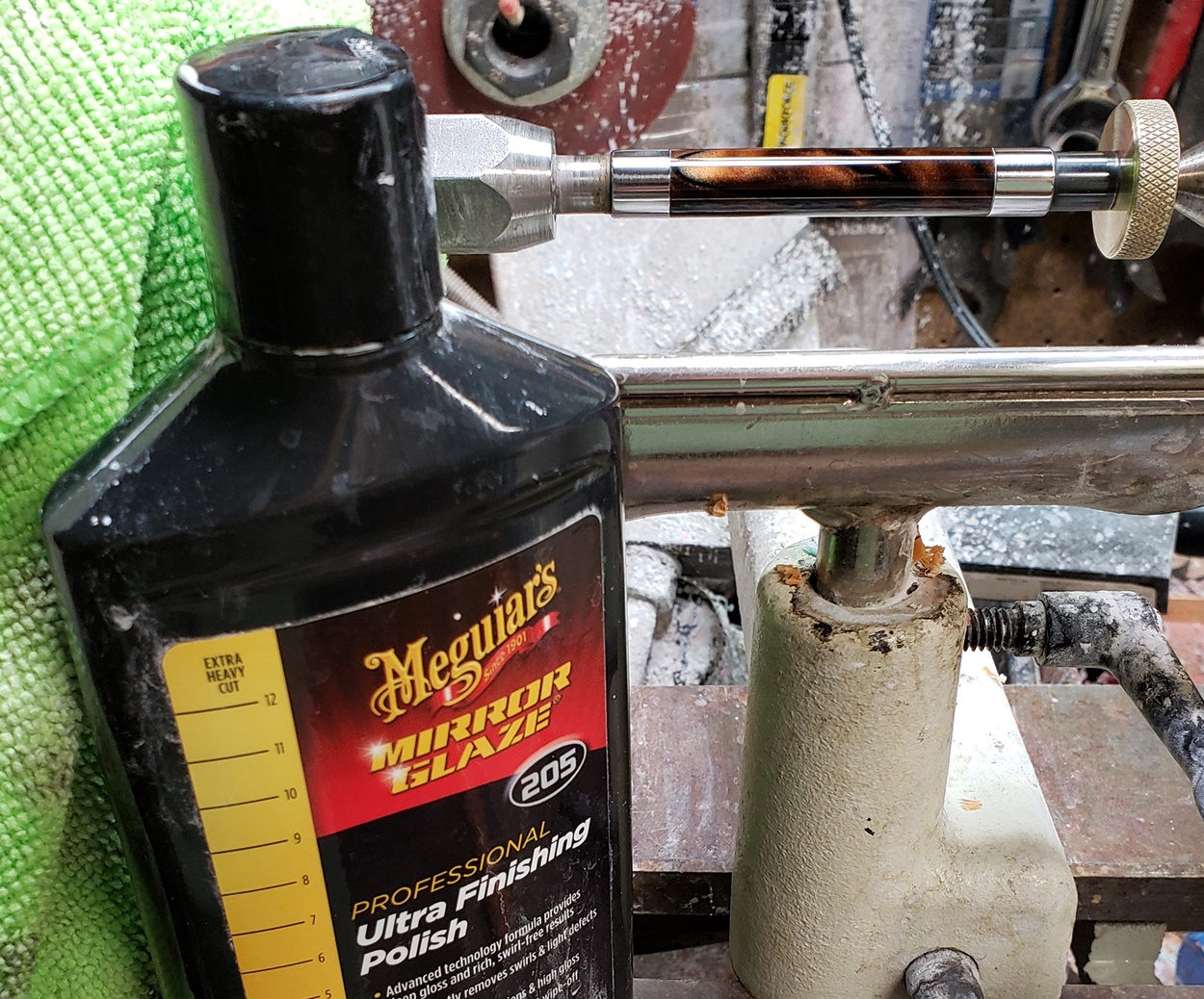

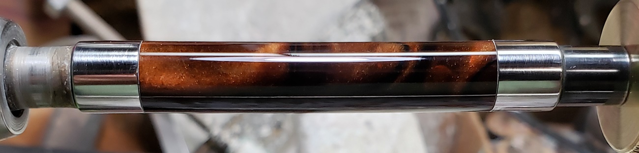

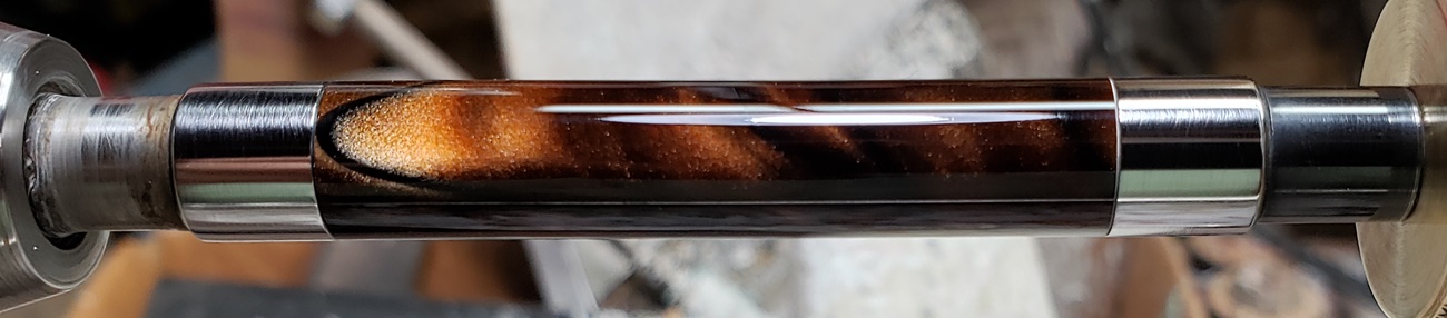

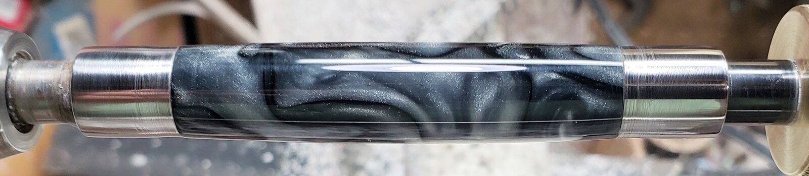

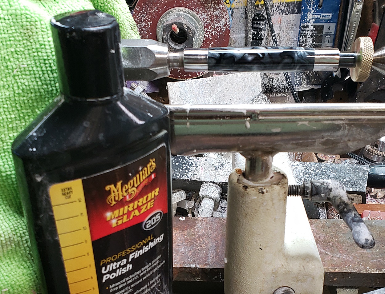

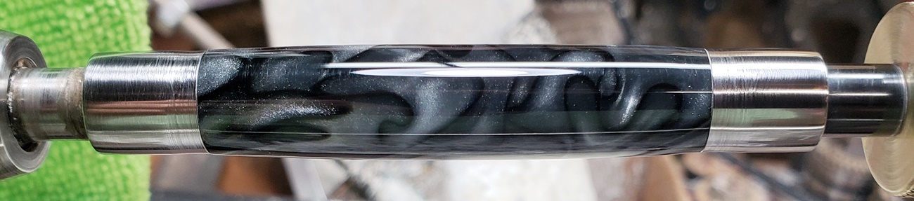

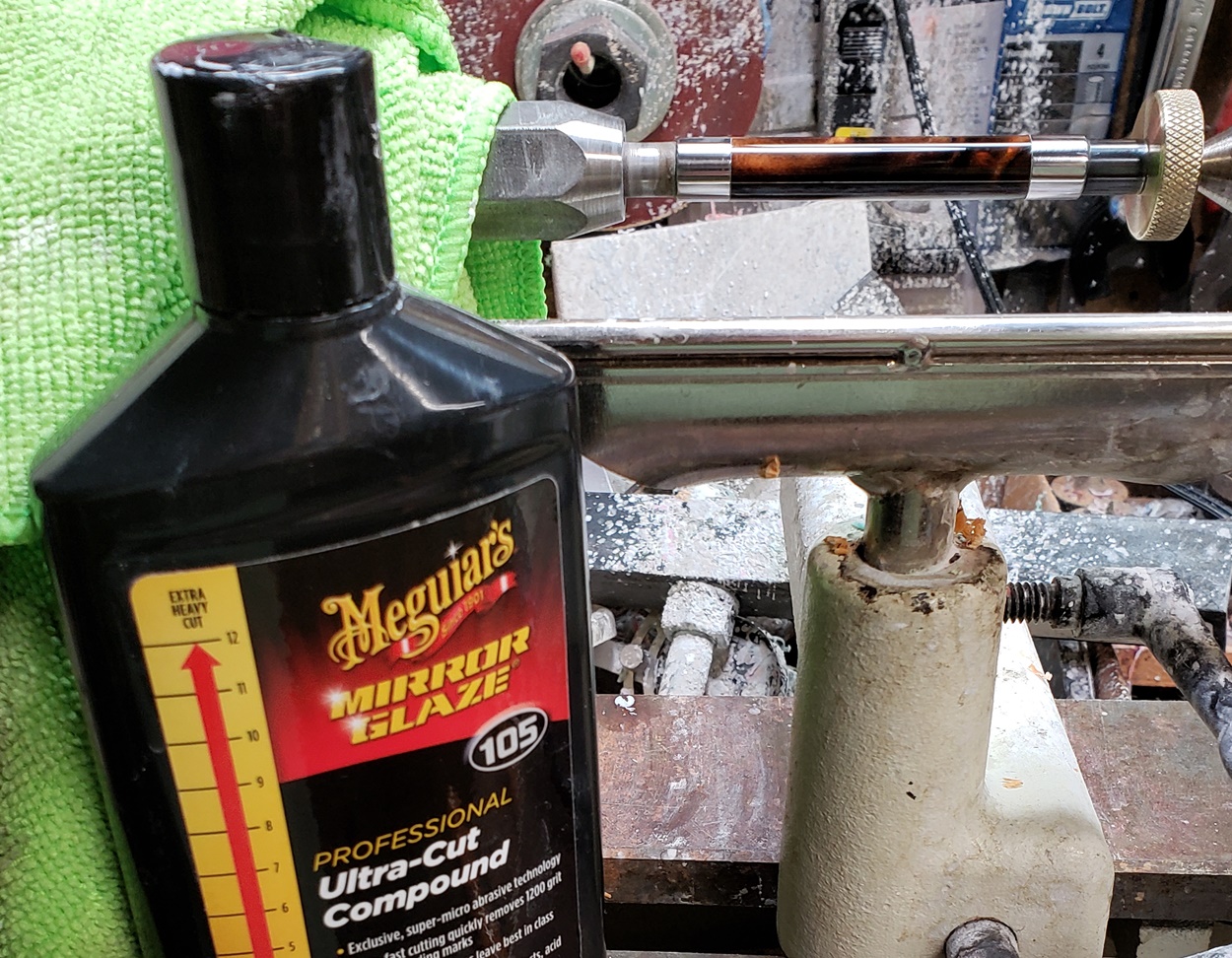

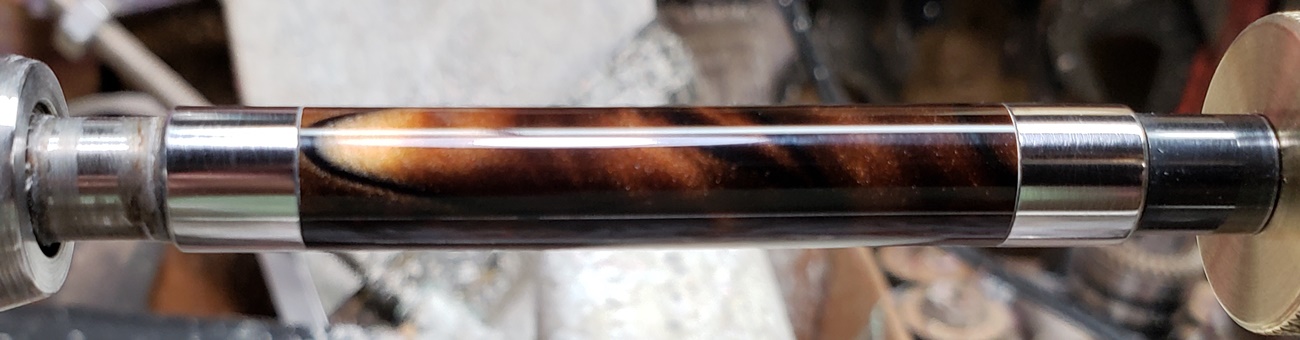

Lately I've been using 3M Tri-M-Ite polishing paper, and been getting good results. There are six grades. Just for fun, I decided to try Micro Mesh again, but only using every other pad, for a total of five grades. I think the MM is giving as good results as the 3M, maybe slightly better. With both, I finish them with Meguiar's 105 then 205.

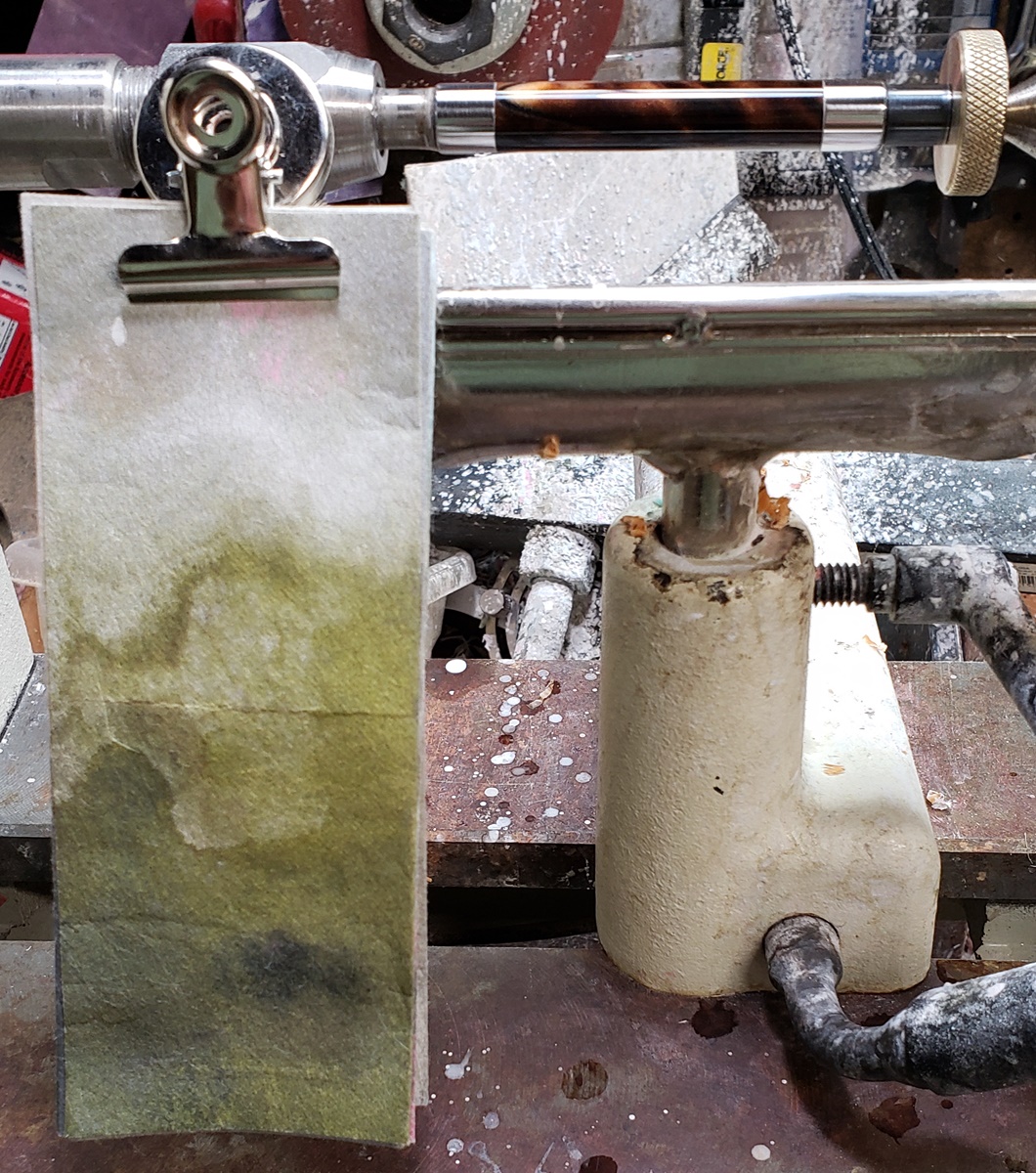

I've tried both and chosen to make the transition from Micromesh to Tri-M-ite for pens.
This is not because I can tell the difference between the results I get using *new* Micromesh and *new* Tri-M-ite paper - it's because I could never bring myself to use those expensive Micromesh pads once and once only.
I cut the Tri-M-ite into strips about 3/4" wide and 2" long and use them once, then straight into the trash. Always have a new cutting face, don't get the ebony dust from the previous pen smudged into the holly of the next one, etcetera, etcetera, etcetera.

Looks like everyone misunderstood what I wrote, so for clarity: I never threw out a set of Micromesh pads after using them once.
Like everyone else, I used them and washed them "until the finish starts to suffer" - my entire point being that's too late. By switching to Tri-Mite, I never reach the point where the finish suffers.
