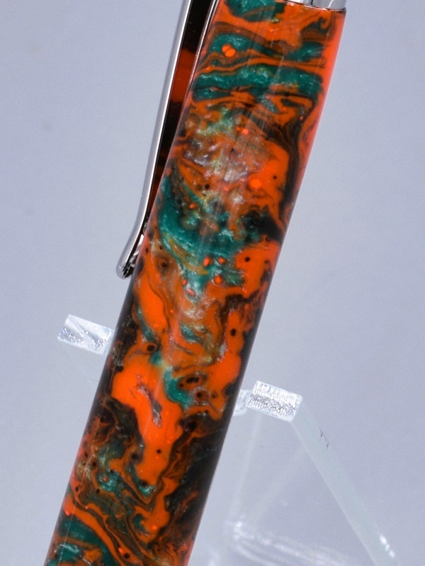

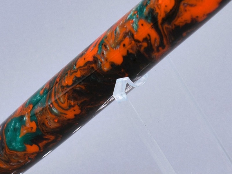

Thank you a for your replies. I've attached a couple of pics so you can see what I was talking about. You can see the orange and black dots that look to me like unmixed mica.
