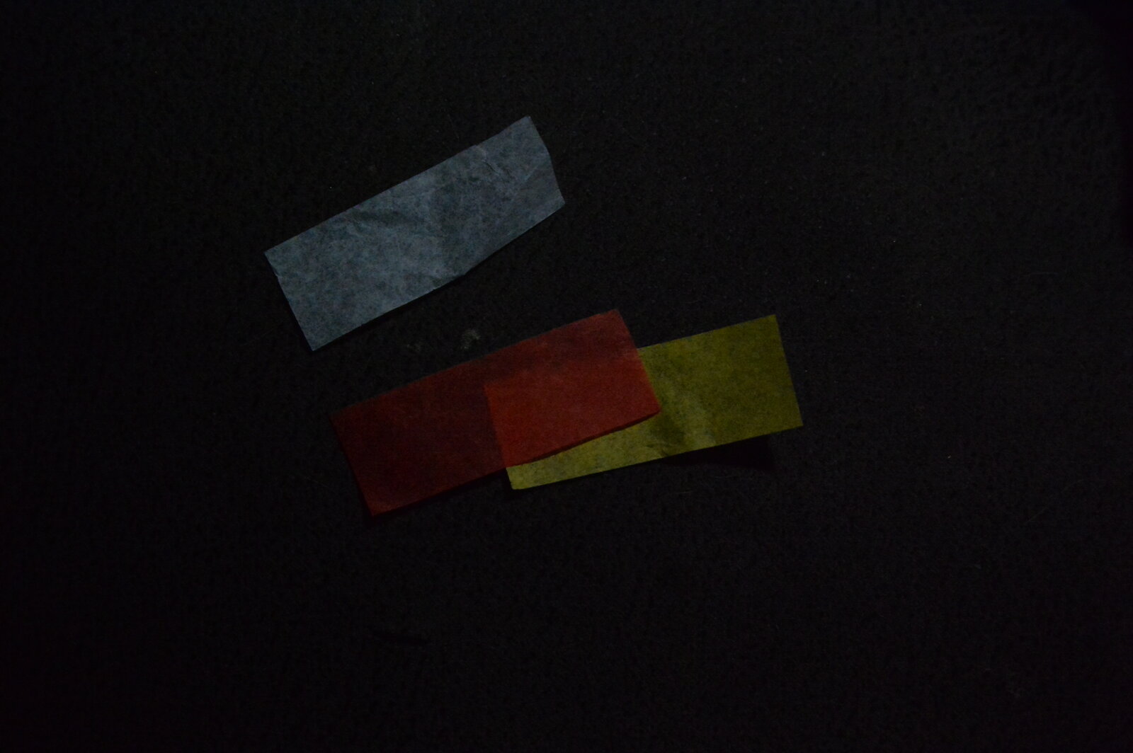

These are red, yellow, and white tissue-type paper 3/4 wide 2", how would you cast this

just to show size and color I have more of this, 1/4 grocery bag, I like what you said about cutting it up, I will try a couple of strips with a quick spray of lacquer let it dry then cut them up?

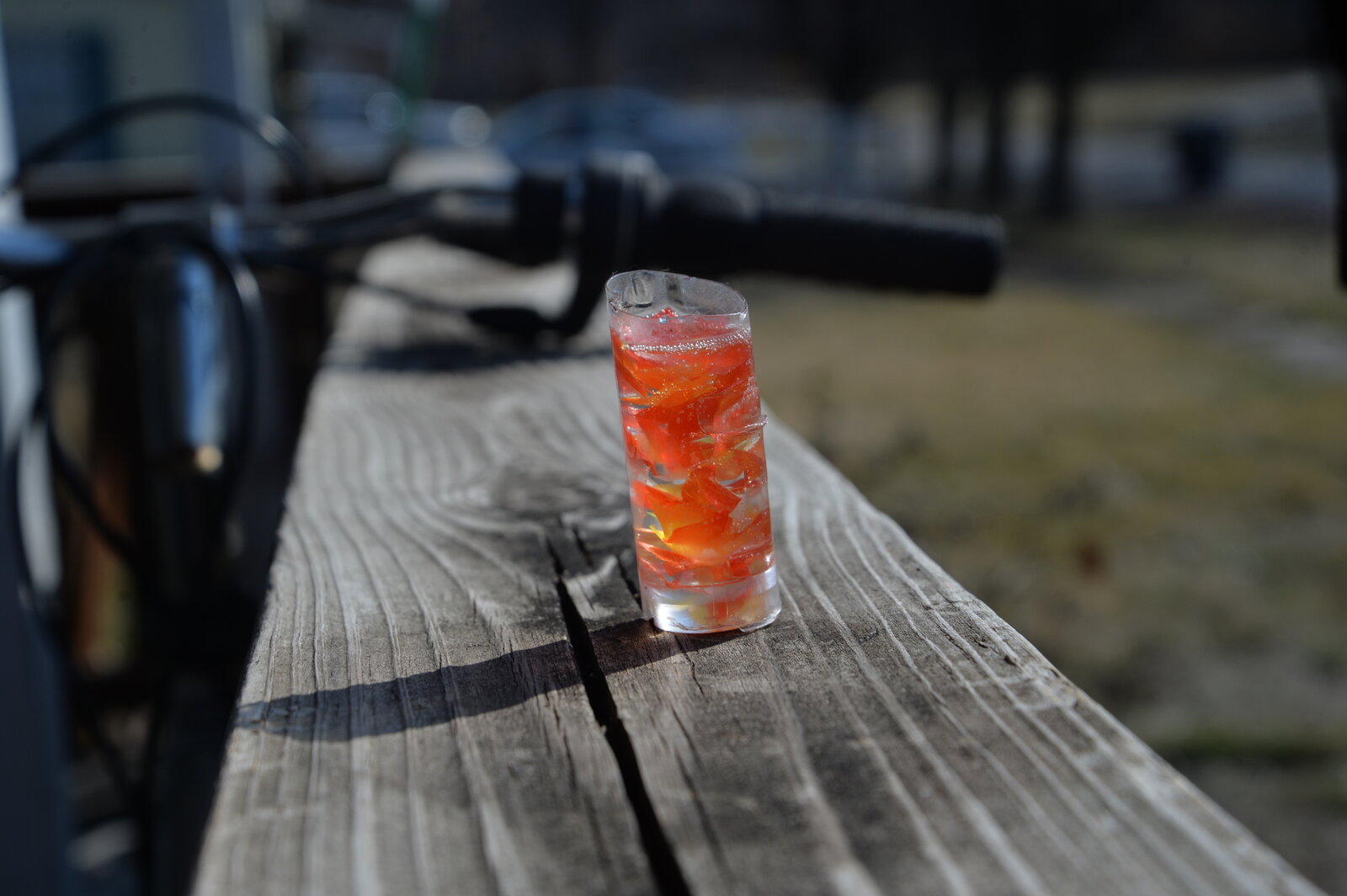

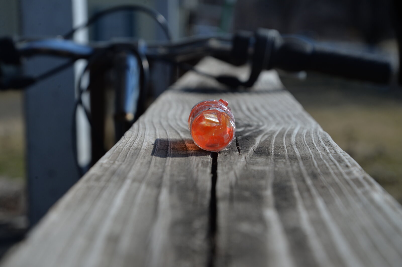

here is a sample pour, some were coated with lacquer, and some were not, 50 lbs in the pot still have some air bubbles

I like the look. I am interested in what you are going to do with the tube going through the middle.
