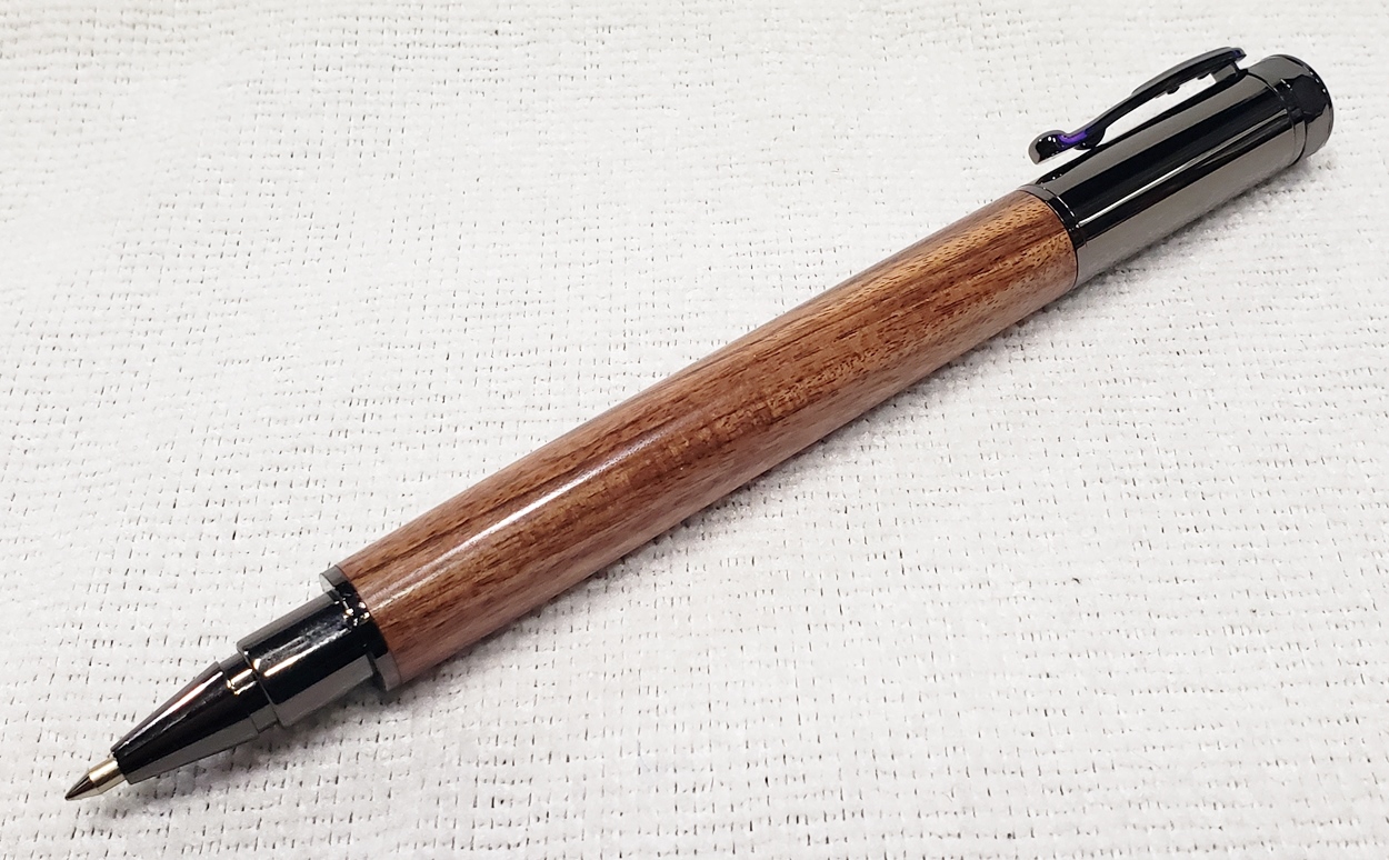

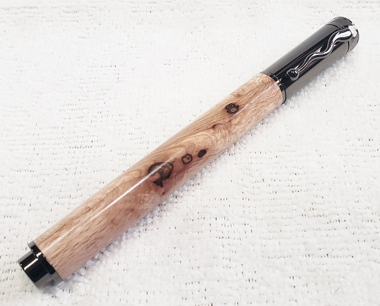

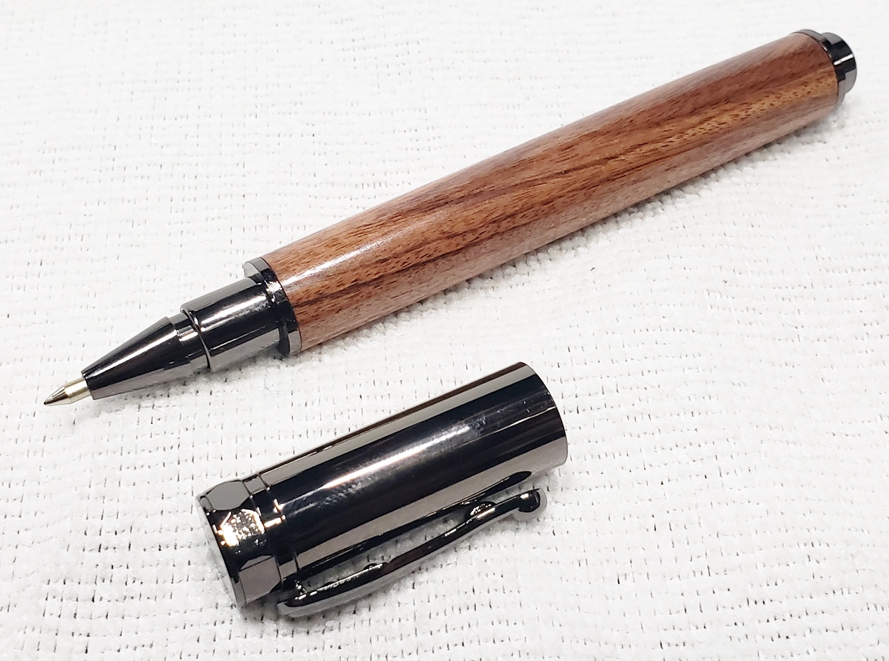

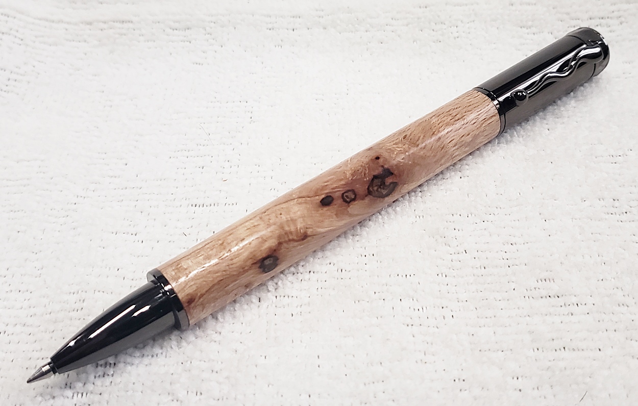

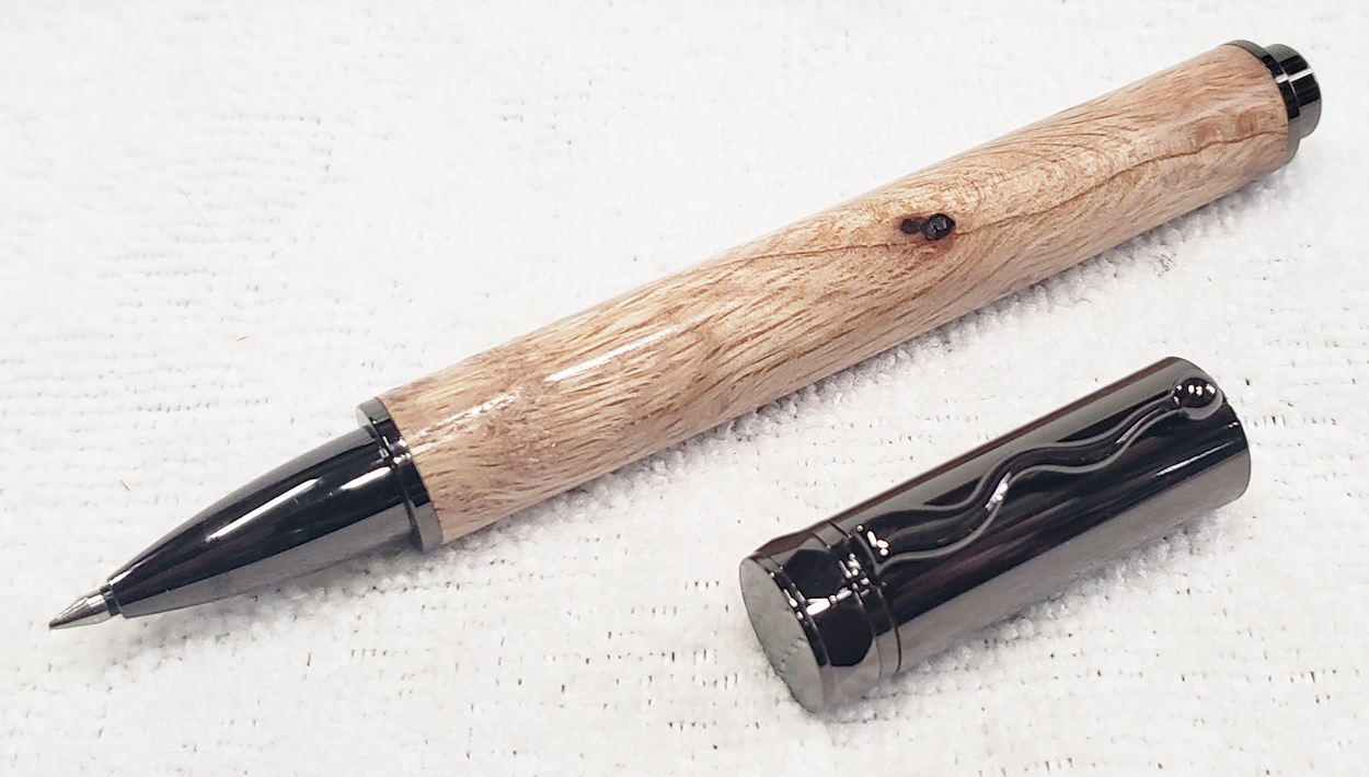

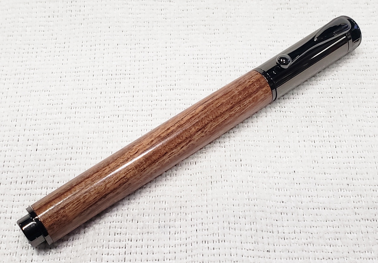

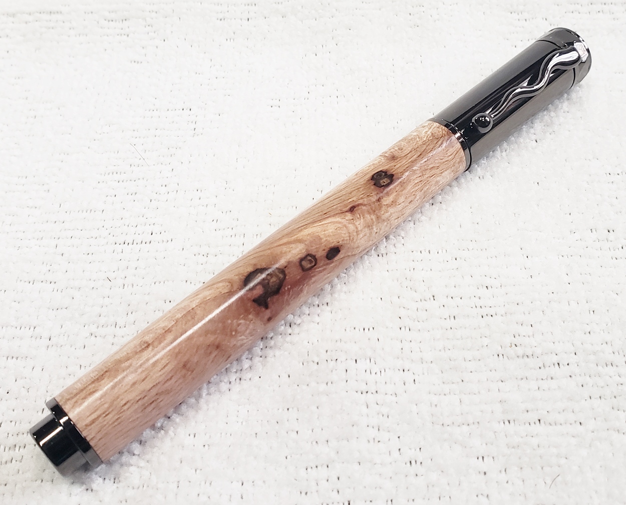

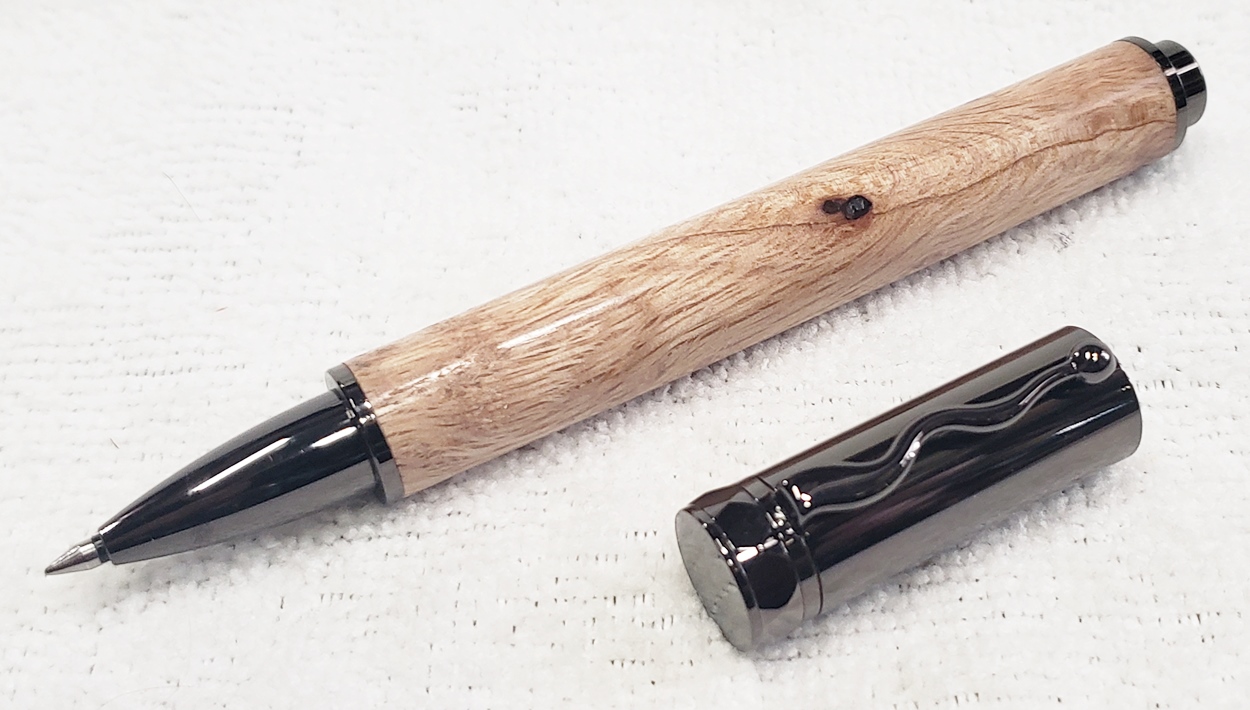

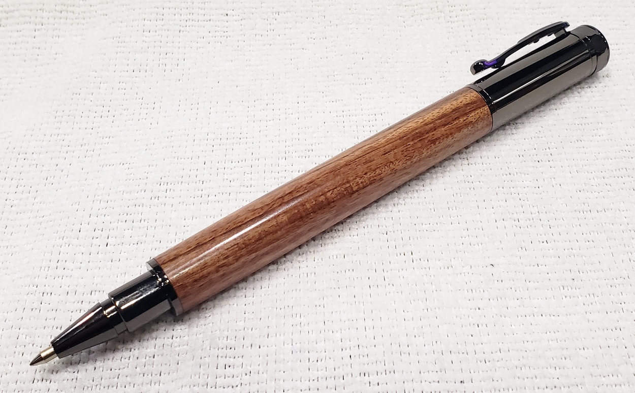

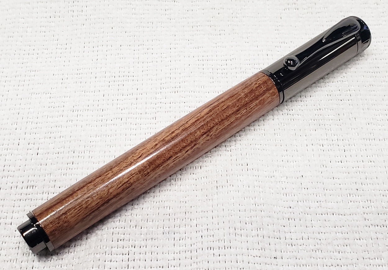

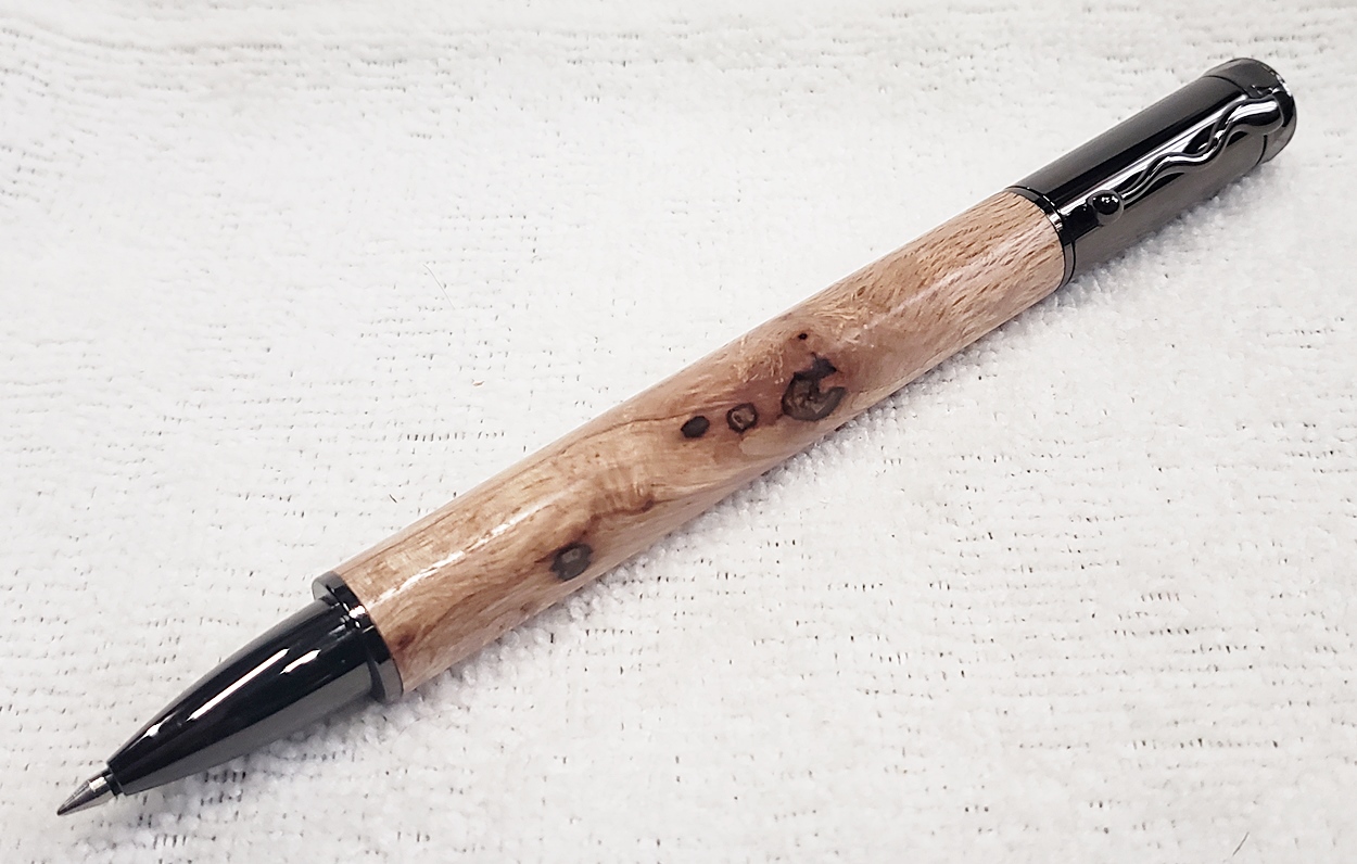

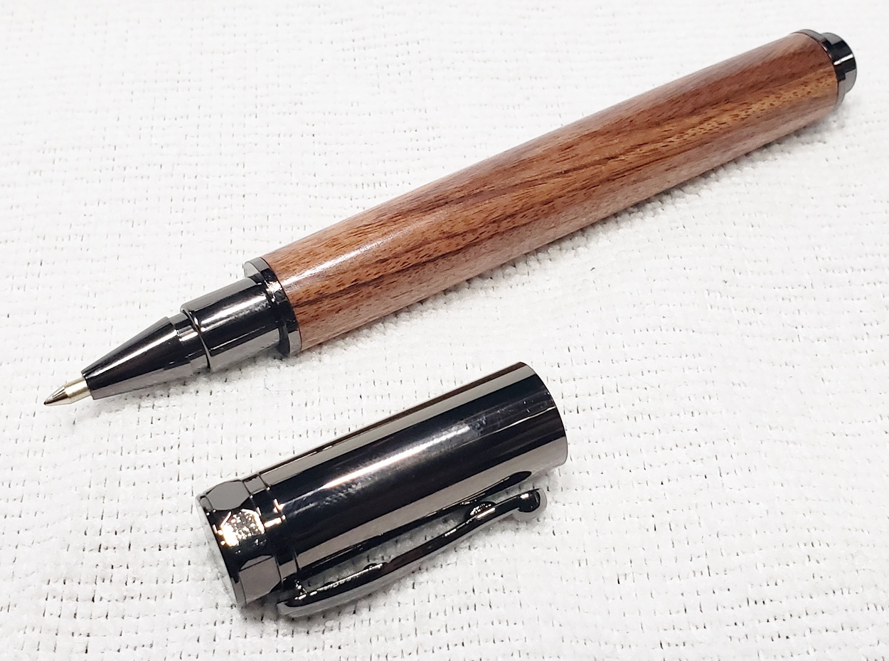

I've turned several of the Crooked Mill magnetic, in both the straight and "crooked" clip versions. I like them.
