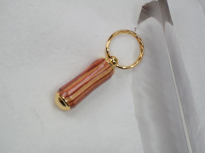

Here's a pillbox in tulipwood I did the other night.

Tony your photo shows one of the questions I am asking. The bottom of the ring shows an exact match to the brass. How did you achieve that??? Is there a bushing the size of the brass or do you do this with calipers???

John, the key rings I used to make {woodcraft} used the slimline bushings & made it the same way you would for one end of the kit. The actual key ring can be a little larger than the end caps & still look ok.

The pill box has a set of bushings. Look on the Penn State site and they will list the bushings with the key ring kits. Another good source is http://woodnwhimsies.com/ - even if you don't order you can see the bushings they list.
The 7mm key rings use the standard slimline bushing. The 10mm (not 100 mm as I wrote above) use the same bushings as the PSI traditional pen and the top and yo-yo kits.
