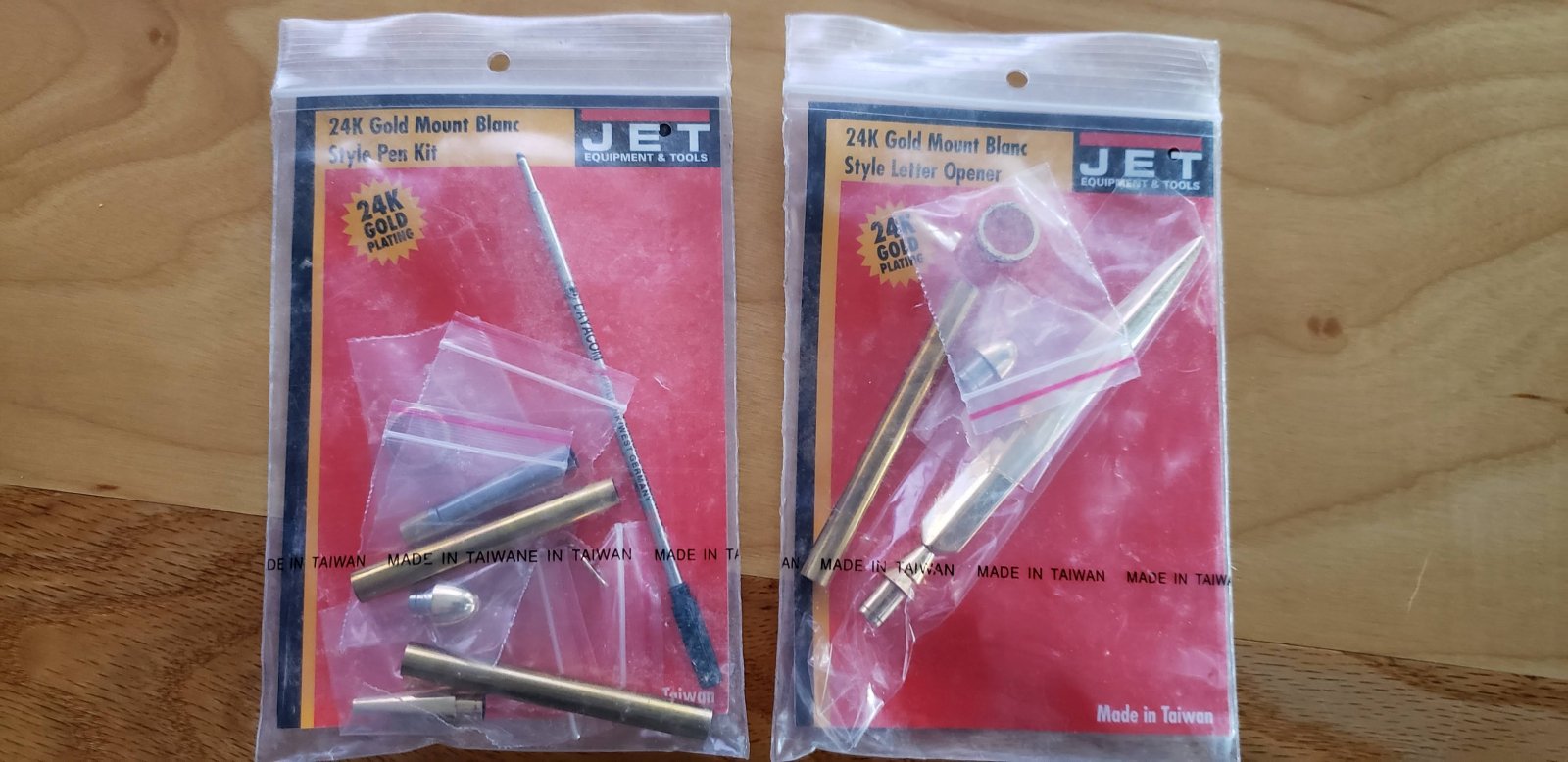

I started turning a few years ago after I inherited my lathes and tools from my dad. I recently came across a few turning kits seemingly manufactured (or at least branded) by Jet. I would love to make these but don't have the bushings. Does anyone have any experience with these kits or know what kind of bushings I would need? I tried searching through the reference guides but couldn't find anything about Jet kits.
I'm guessing here, but the pen looks like a standard slimline-style pen (Cross refill, recognizable twist transmission, etc). Plus, the instructions (photo 2) say to use a 7mm drill. So, use 7mm straight bushings (the kind most use as "spacers").
You are correct, they use standard 7mm tubes and accessories but these particular kits are "Mount Blanc Style" so the bushings are different. There were a few other kits i founf that were purely slimline style that use the "spacer" bushings, but these two don't.

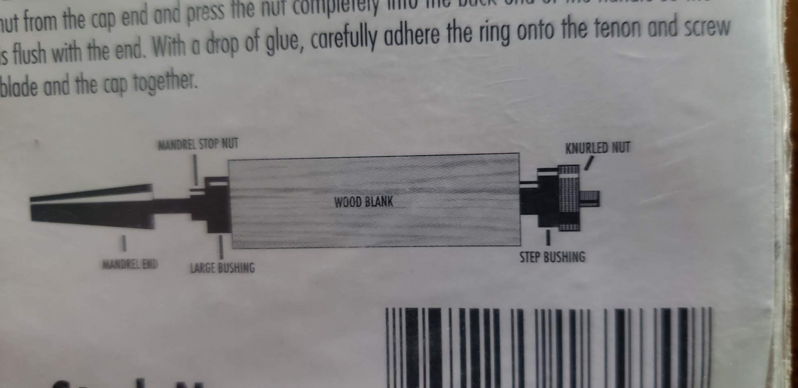

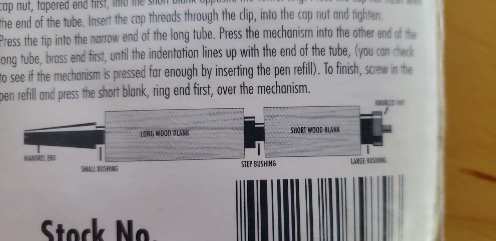

Here are some closer pictures that show the diagram where the bushings are more visible.
You will have to measure the metal component diameters at the points closest to where they meet the pen blank ends.
You could do without bushings by using calipers to monitor the blank diameter as you turn it down.
To find compatible bushings, I would suggest searching for kits with names like "Round Top Streamline".

They look like old 7mm European style kits to me.
The European one looks similar. I think I am going to measure the tip, middle and cap with my calipers. Penn State has detailed sizes of each of their bushings so I might find one that fits.
You would be much better advised to measure the parts and MAKE bushings that fit your kit.
The "Euro" design was not patented, there were a half dozen "knock offs"--all the early ones used 7 mm tubes, but some required a tenon, some just took off material down to the tube. And the centerbands were not all the exact same measurement, nor were all the cap top pieces.
You have the components, make your bushings to fit them.
Edit in: Yours will require you to turn a tenon, the centerband goes over that tenon and is glued in place--a very early design.
