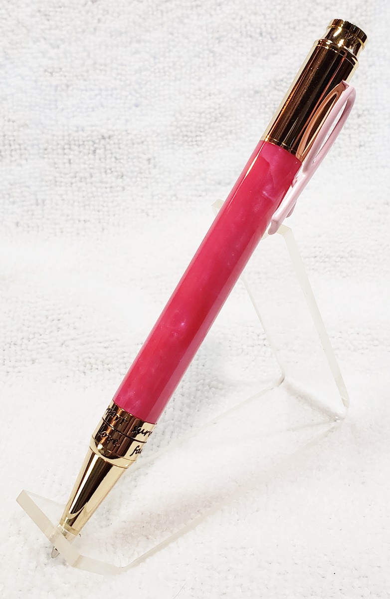

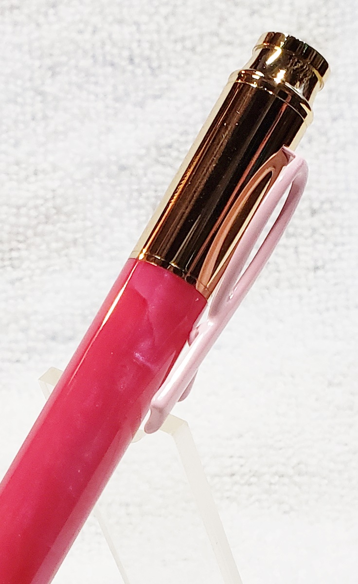

This must have happened when I pressed the finial into the tube. The blank is an inlace, so is more brittle than some. It's not all that bad, but you can feel it with your finger. Shame, it was a nice looking blank. I'll redo it with an AA blank.

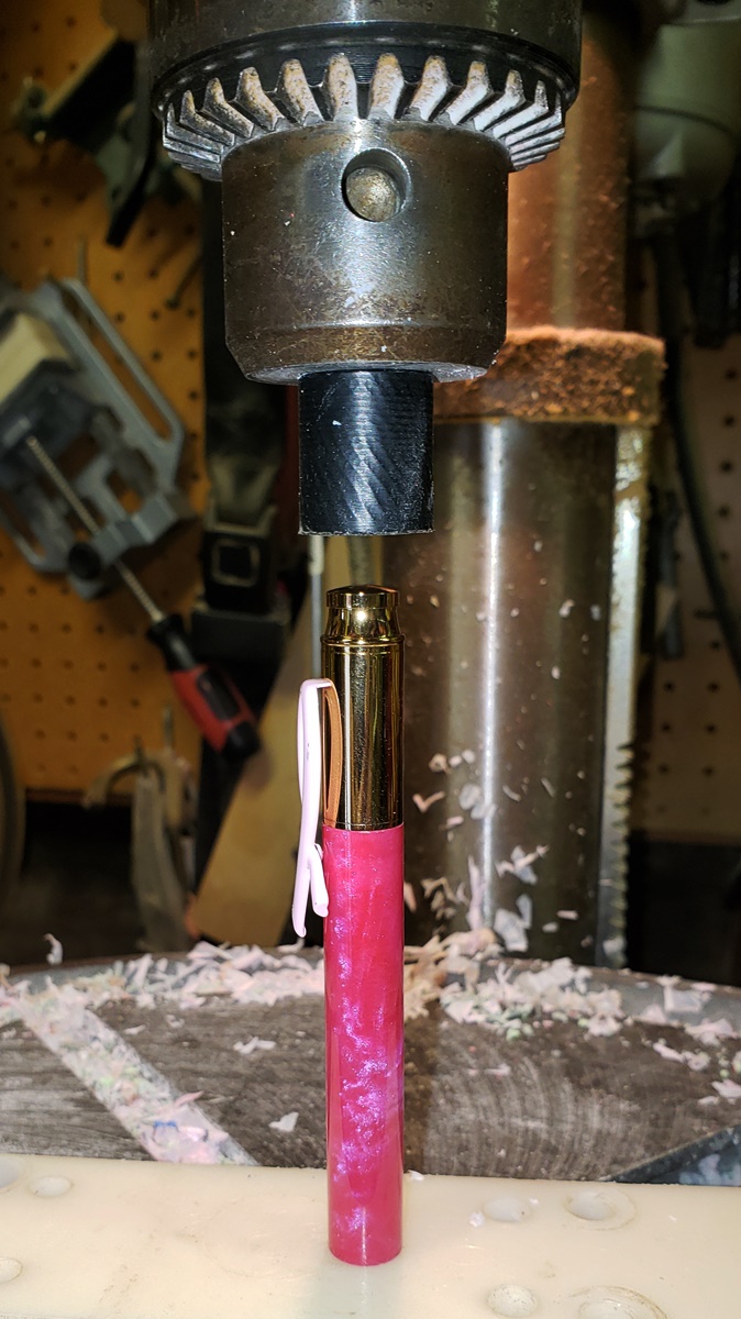

I use my drill press as an arbor press. Been doing it that way for 20 years. Very rarely have a problem.
