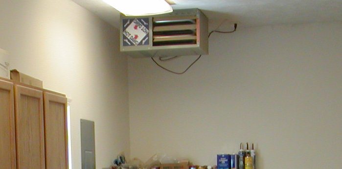

I have a hot dawg heater installed in my shop - and it really does a great job. It runs right off of the gas to the house, and it is externally vented on it's own - through the roof of the shop.
Best,
Roger Garrett
