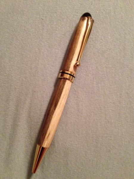

Ok, so I finally got out to my shop and gave some of this a try. To start, I still used a bit of BLO before my CA application so I could raise the grain and sand with 600 then go to the CA from there. For application I used some foam (as was recommended) put on 5 coats and then sanded thru MM 12000 grit. After that did a white diamond buff and applied HUT polish as a finale. I realized where I went wrong so many times and that was that here was not as much CA on the pen as I thought, and I also (since I have no accelerant) did not allow the CA to fully cure on a few attempts. Add in some patients and time and here is the pen I turned. (was some wood donated to me by a neighbor. Unsure of the type, but great for practicing my finishing technique)
