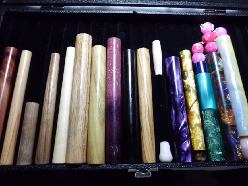

This is a picture of my Samples box. You'll notice that I turn a lot of blanks round, and then sand, finish, and polish them while they are still full length blanks. This helps my potential customers see what a finished pen may look like, and also helps me to streamline the process of making a pen ... it's already round, I just need to chuck it, cut to length, drill, ect ... I turn all my barrels round before cutting and drilling, so this does save me some time as well.
You'll see the finish results I get here from merely sanding up to 1000 grit (dry, bare wood), cleaning the wood (you see I didn't clean the one third from the left at all, I was in a hurry), applying my finish (minwax + ONE COAT of CA), wet sanding at 1000 grit (very lightly, under 5 seconds), polish with Plast-X.
The beads in the top right are all off-cuts from Breast Cancer Awareness pens.

This makes alot of sense. I really appreciate your help. Im also going to look up this oil you are talking about. Thank you so much
