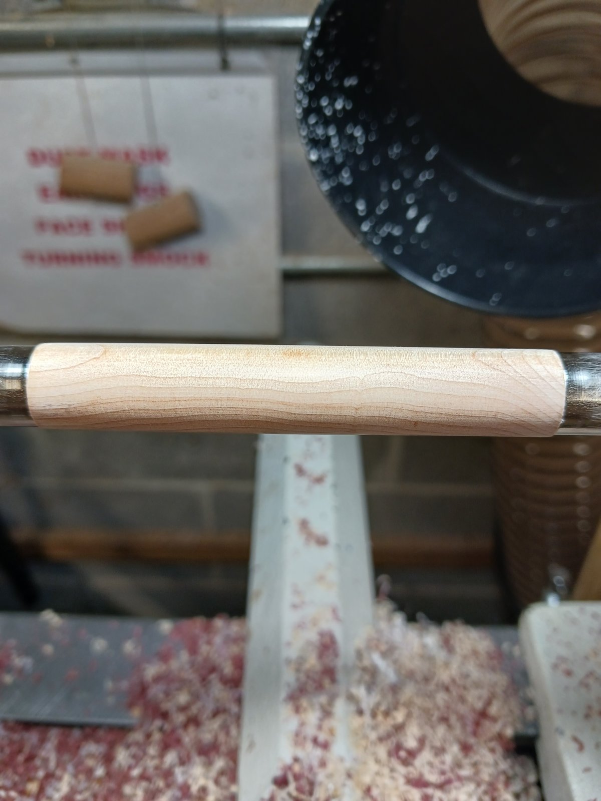

Working on finishing a blank of hard maple. Has light color and fine grain that is outstanding. Sanded to: 240, 320, 400, 600, 1000. Slick as glass; photo
. Have: CA, DIY friction polish, store bought friction polish. Your recommendations? No hurry as I want it to look good.

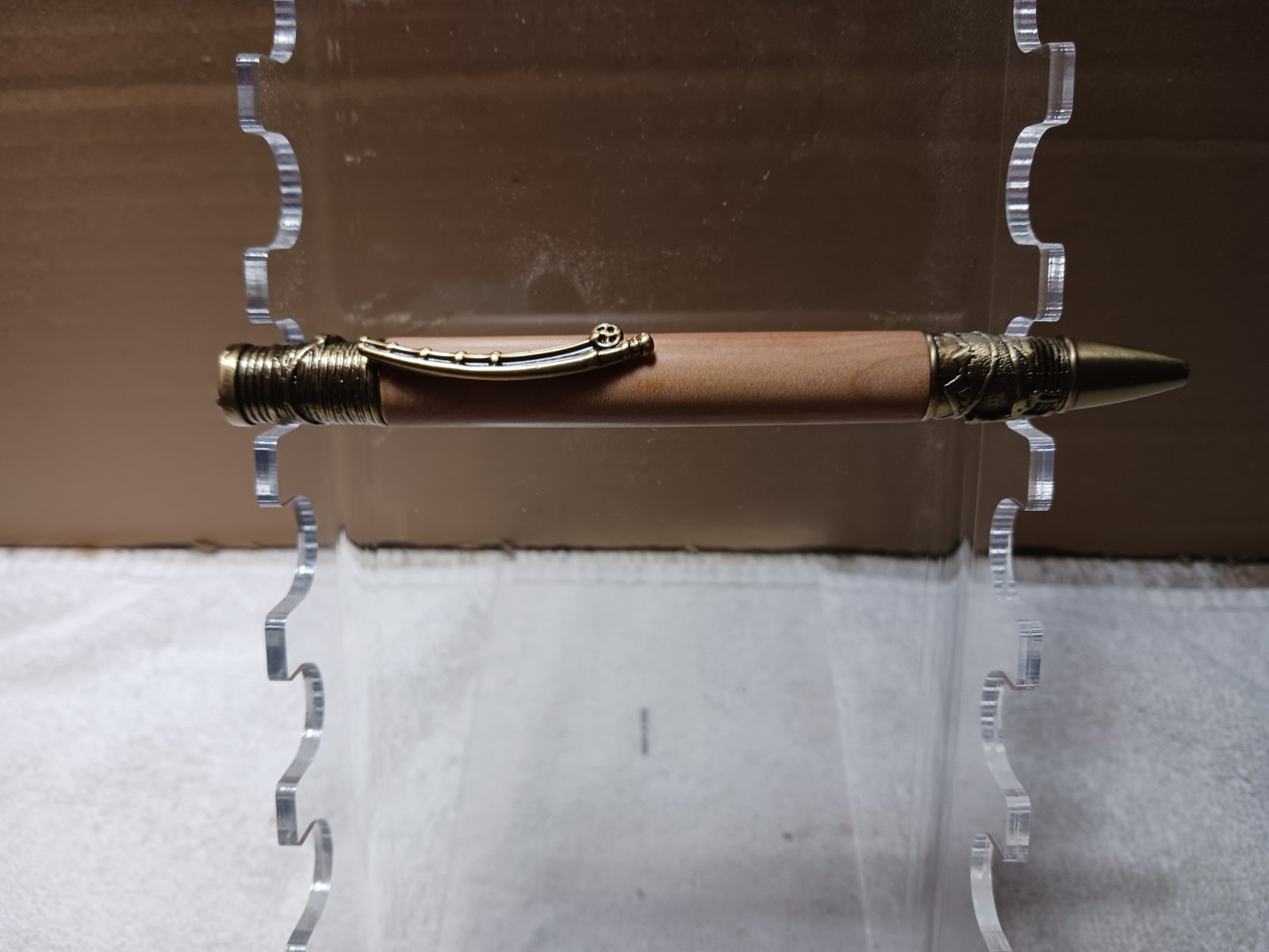

I used the two 60 degree centers but flared the tubes so parts were loosey-goosey. I have found that I have a number of bushings that fit the ID of the tube, not necessarily for that kit. Turn to a bit oversize and work from there. I'll post a photo later.
