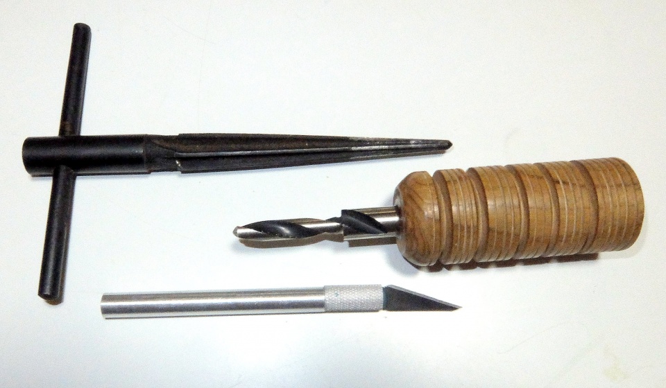

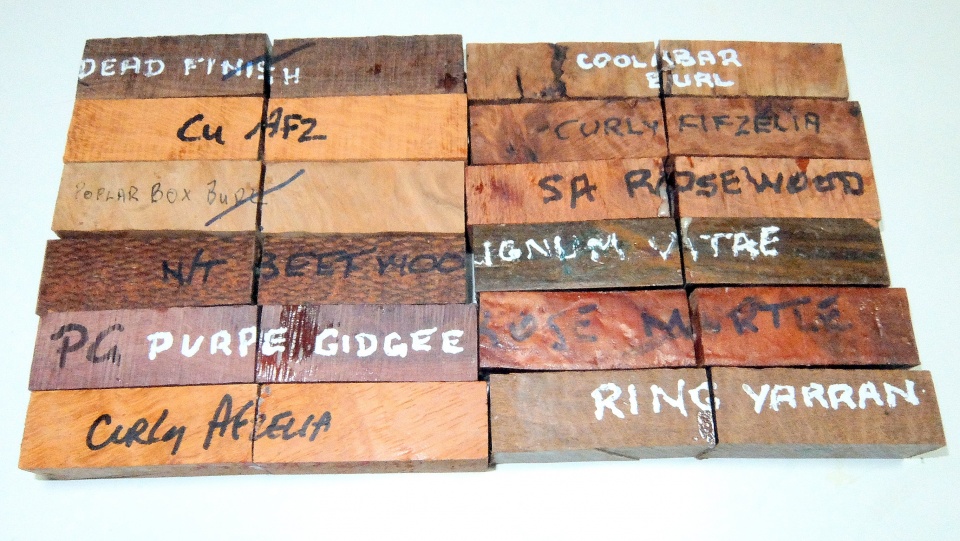

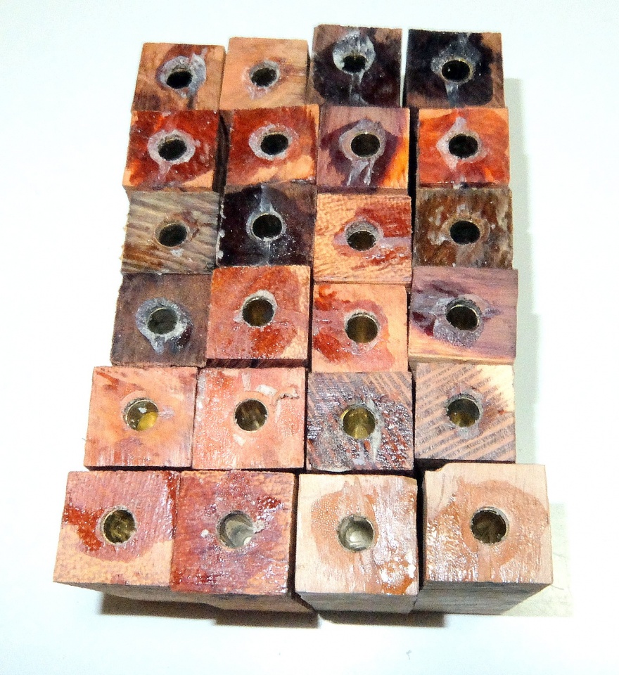

Coincidence in the middle of preparing 12 Aussie Slimlines with a few American timbers. Tools I use for clean up before squaring the ends and turning. Tools used old reamer for first entry,then step drill I have been using for at least 30 yrs snug fit in tubes,then the craft knife.
The Original Poly Gue used.
Kind regards Peter.
