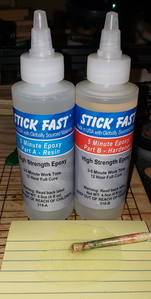

Two-part 5 minute epoxy, unless I'm gluing multiple kits at the same time. Then I'll use 15 or 30 minute. I never use CA or polyurethane glue.

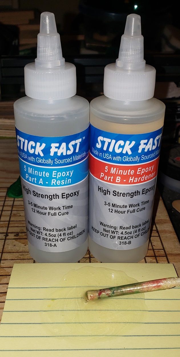

I assume you are using the stick-fast brand that you posted a picture of? I haven't tried that one yet.
Also, are you talking wood to wood, wood to metal, acrylic, etc? Also, are you doing this on a relatively simple 90 degree segment or something more complicated?
I would love to be able to start something 20 minutes after I set the epoxy.
I'm talking brass tubes to wood or acrylic. I don't do segmented pens.
