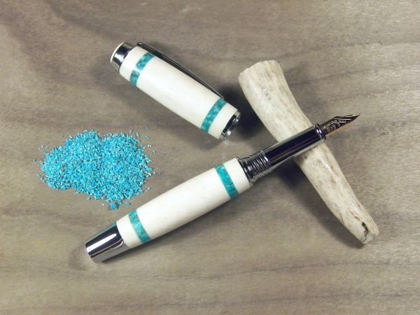

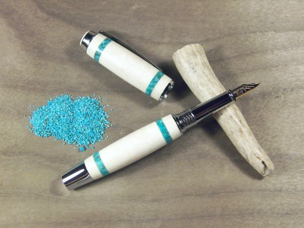

Crushed stone is of course not solid, but as a start it is cheap and easy to use. See this one in real turquoise:
I just wanted to say, I really LOVE this pen design. The white (is that holly??) and the turquoise go so well together! I hope you don't mind if I make a similar pen? Probably a different kit, but, I really do like this look/style.

I found that using a carbide cutter in a sheer cutting position helped a TON when turning wood blanks segmented with metals. I tried using just a negative rake cutter, but even that didn't work all that well. Either a normal or negative rake carbide cutter worked much better as a sheer cutter. It made it easier to control where you cut, so when the time came to level out the metals with the surrounding wood, I was able to more tightly target just the metal and the bits of wood that rose up to meet it. I don't think I was able to get it perfectly turned in the end, but I got it much closer with the sheer cutting than anything else.
Please do. The white stuff is deer antler, see the pen rest.
About turning materials with different hardness, I also found that a carbide tool in a sheer cutting position was quite good, but not perfect, I had to do the last cuts with sanding paper backed on a piece of hardwood. But in fact I tried really hard material juste once, it was pink quartz, and after using meters of sanding paper with a poor result, now I just avoid too hard stuff.

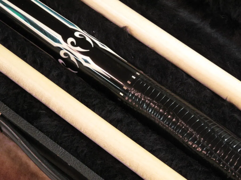

Green Malachite
I am a cue collector too . Bobby Hunter cue Ebony Ivory and green malachite
