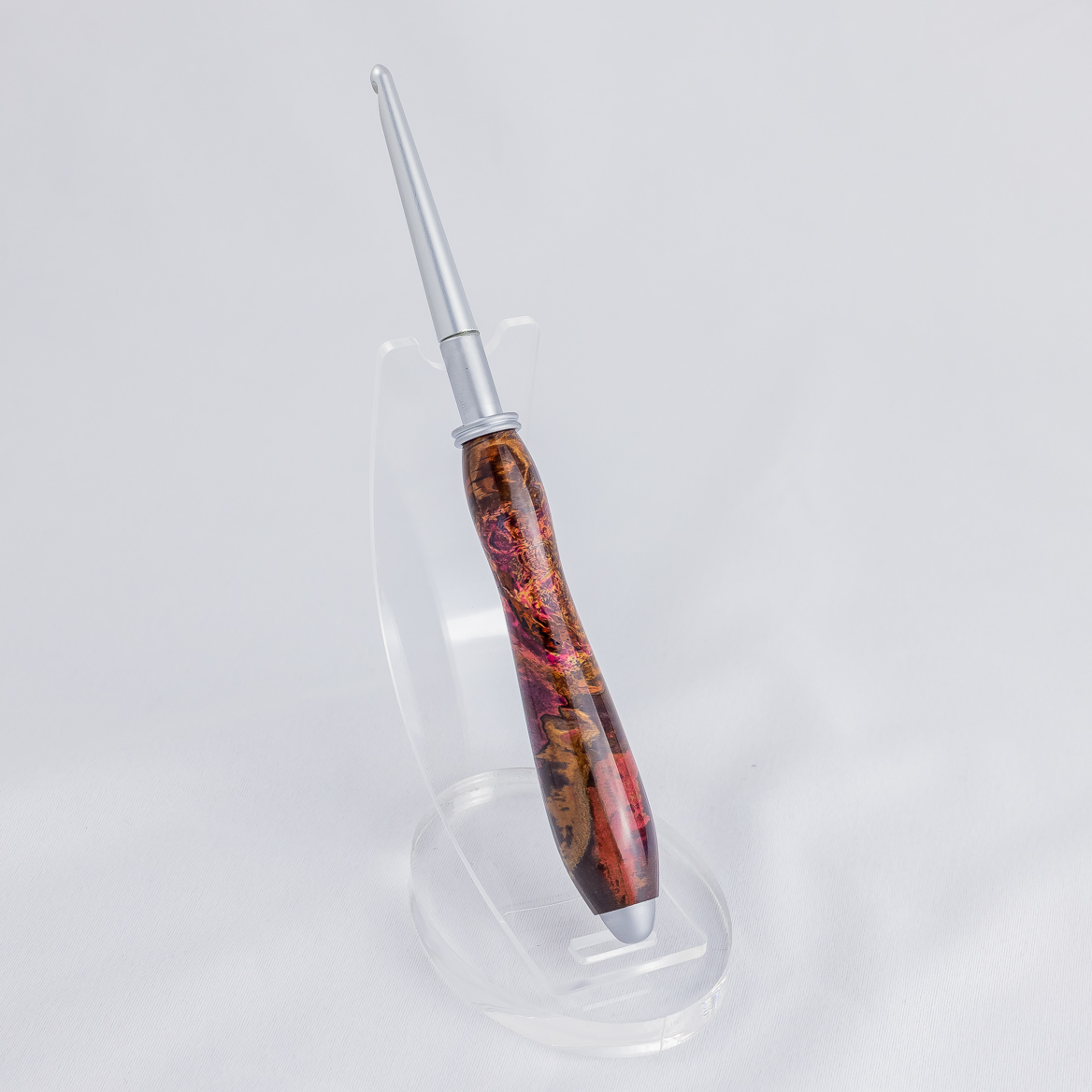

crochet-hook-set-4-jpg.320955

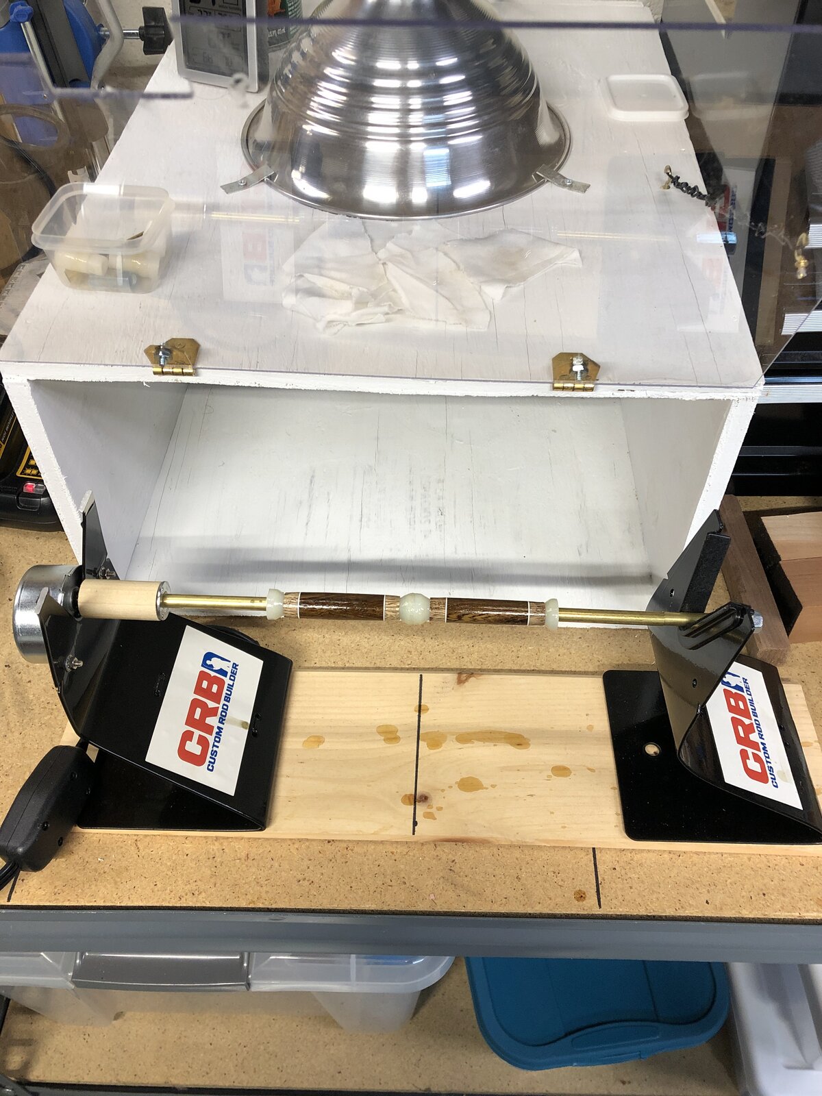

I use WOP, Oil based for most of my segmented pens. I like the slight extra flexibility vs Glu Boost (CA), which I use for non-segmented blanks.
I apply thin coats with a cotton rag section, then place the blank(s) on a slow speed rotating mandrel, under a light bulb for a bit of heat. I can usually reapply in 1 hr. I then let set overnight, lightly sand and repeat. I will be doing several projects at the same time, so while I may take 24 hrs fo 3-4 coats, I have other things to do. This not a quick process, but has worked for me.
