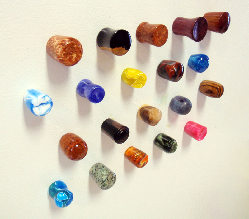

What do you do with all of your pen blank cut offs?

Now that's one of the coolest things I've seen in a long while. Great idea and they should make terrific Christmas gifts. Thanks for sharing.

That exactly why I have a box full of little cutoffs now. I just didn't know it till now. :biggrin:

Thanks for your comments. These magnets were made by request of my sister, and ended up being quick and fun to do.
Where do you get your magnets?
I bought the 3/8" rare earth magnets from Lee Valley, along with the cup holders and friction discs. Woodcraft, etc., also sell the rare earth magnets.

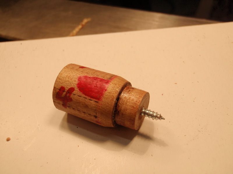

Using a 4-jaw chuck to hold the rounded blank, I trued up the base and drilled a 1/2" hole using a forstner bit to fit the cup, and a 5/64" hole about 3/8" deeper, to fit a #4 x 1/2" screw. To turn the top side, I started using a jam chuck turned to fit the 1/2" hole, but didn't have enough grip, so I added a #4 screw, and made my own mini screw/jam chuck.
After assembling and inserting the magnet, I found that the magnets didn't always stay put in the cups like I expected and would stay stuck to the fridge, so I ended up epoxying them into the cup with J.B. Weld. Hindsight, I will use 1/2" magnets instead of the 3/8" magnets and cup, and just epoxy them in place.

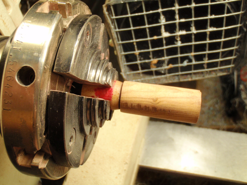

Here's a picture of the jam/screw chuck I used to turn the magnet blanks:
And here's another with the magnet blank mounted, ready to be parted to length and shaped:
And a quick how-to is also attached for reference.
Alternatively, if you don't have a chuck, you can make a wooden morse taper as a jam/screw chuck, or use as a glue block for drilling on the lathe.
