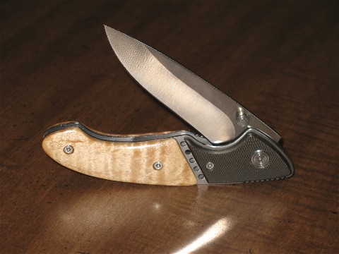

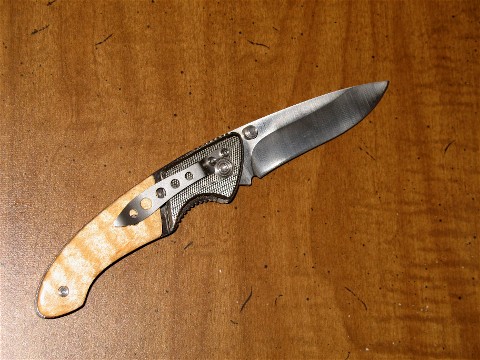

I got this knife kit from Northcoast Knives. It is called a Hitech Folder and can be found at the following link. http://www.northcoastknives.com/northcoast_knives_Specials.htm
I didn't like the scales that came with the kit so I made my own from some scrap curly maple I had. I also fit the scales flush to the liner of the knife. The original kit had scales that were approximately 1/16" smaller than the liner. I finished the scales with spray laquer.

Really nice! Did you just sand down the edge grips or did you try routing?

Great job. I've been looking at doing a knife kit. After seeing yours I think I might have to order one. Looks great.

Thanks guys. I used the original scales to locate the screw holes in the new scales and attached them to the knife kit sans the blade. I then sanded the scales flush with the liners using an oscillating spindle sander and then used a palm sander to shape the scales to what you see in the photos. I did not use a router. I then finished sanding the scales by hand and followed up with the laquer.
