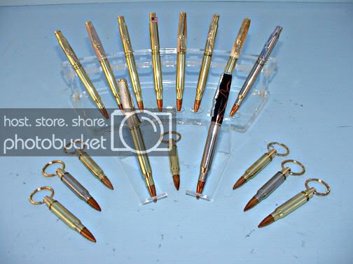

Don't discard those antler tips when cutting blanks for pens. I hate to think of how many times I discarded a bunch before someone (can't remember name due to senior moment) on WWF showed key rings made with them.
I finally got time to try a few this afternoon.
Should make a nice combination gift set and combination gifts mean combination $ $ $ 's for turners. :)

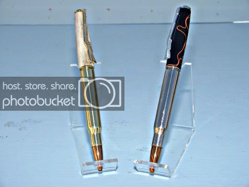

Shown here is a hunters special with 30.06 cartridge and deer antler pen with deer antler key ring.

Antler tip and bullet key fobs. You guys are geniuses. My brother in law usually sets up a table at the local gun shows and sometimes gets me to help. If I take a little corner of his table I should be able to make a few bucks. I was already planning on making up a few bullet pens. Does anyone sell the fobs? If so would you mind telling me how much they sell for? Wait, that might be going a little far. After all you did just give me the idea, now I want you to give me pricing too? : )

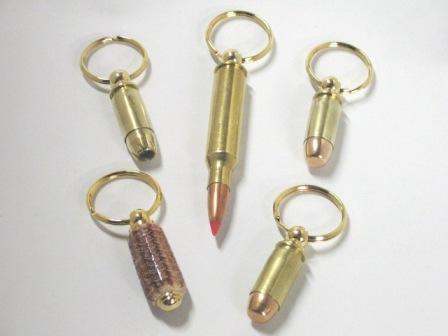

I have sold dozens of them in wood and corian . Now I have added the antler tips .
I get $8.00 each for them .
I also make some secret compartment ones that I get $10.00 or $12.00 depending on whether they have a whistle in them or not.
These wood and corian ones are the same kits that I use for deer antler ones .

Found this at CSUSA-----050-1002 10K Key Ring Only -----.85 cents
Heck I need to order some myself.
__________________
I may be broke---but we have plenty of wood
It is for the ring only but does not include the other parts of the kit.
Seems like woodnwhimsies still has the best price at $1.29 for the whole kit.

I just buff the pieces with the three stage Beal buffer. First Tripoli, then White Diamond and then Carnauba wax. No actual finish is required. It comes up to a high durable shine .
No matter what kind of finish you put on key rings it will eventually wear off with keys rubbing against them . On my wood ones I do use a good hard film finish same as on my pens but I warn customers that the finish will not always look that good.
The corian ones however, are like antler in that they can be finished with only the buffing method and will retain that appearance without any further finishing.
