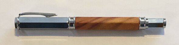

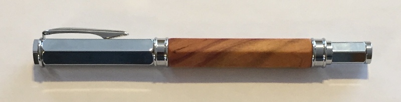

Recently purchased the Beall Pen Wizard after considering it for 4 years. Experimented a bit and decided to make a Vertex rollerball. The wood used is plum with 3 coats of wipe on poly. I am going to enjoy the possibilities of this.

Awesome. Looks great.
Side notes: If you use stabilized wood, it is easy to polish after you shape and you would not need CA.
Well done! Looks GREAT!
It seems like to me that many people go for the Pen Wizard with great imaginations, only to find out that imaginations don't always play out in wood like they thought. . . But you nailed it on that one!
My next step is to do the same pen, same wood but do the flats on a spiral. The challenge is figuring out the gearing to start and end with the flats matching the hardware alignment.
I did find that pen wizard, like anything, is a tool that requires imagination but then the calculating to figure out how to accomplish the imagining.
I also make bud vases and I'm working on a method to mount them. It's only a "pen" wizard until I figure out other mounting methods.
