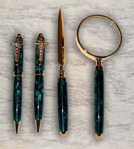

Here is a picture of a set that I did from Green Crushed Pearl from PSI. I just used the acrylic sanding pads from PSI following there directions for wet sanding. Just wet sanding, no polish at all. This is how I do all of my acrylics. I have had great success!
