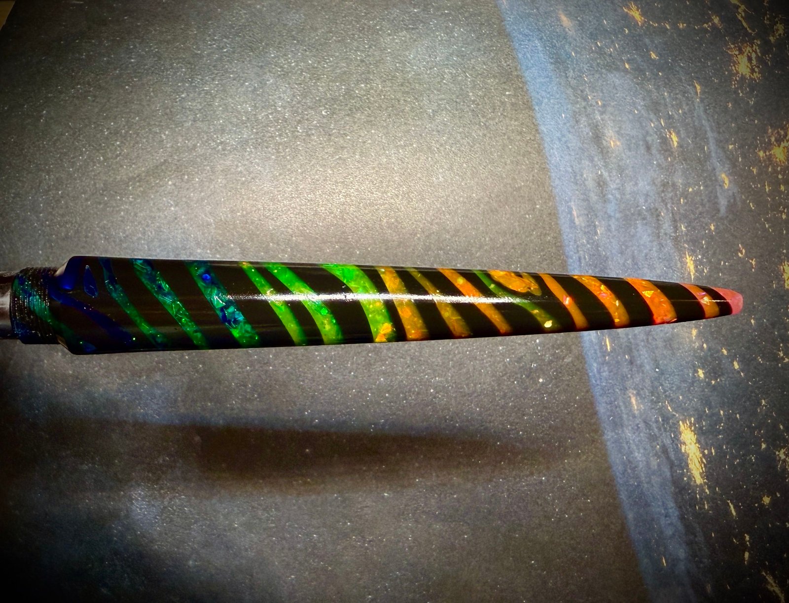

Thanks! I will give that a try. I'm turning a partially 3D printed blank pen at the moment and I think CA may be good on this one due to the texture differences between the materials. This is after sanding with 600, but will be taking it to at least 1200 first.
