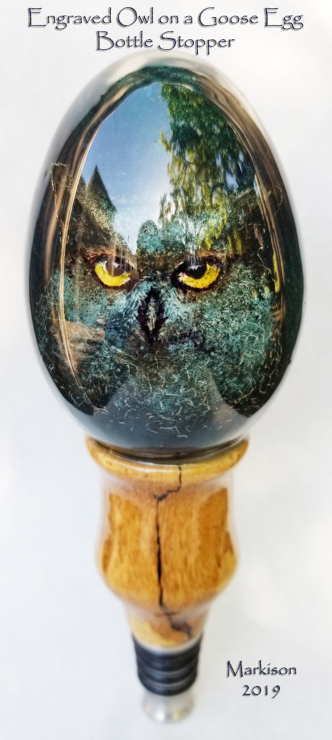

This began as a life drawing of a rescued owl in pencil on a dyed goose egg:
219852
Glad to show the steps if there is interest.

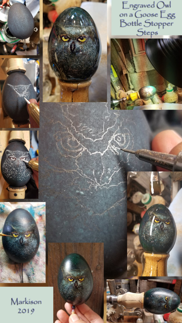

Russ requested the steps.
Tony - Yes, 2 layers of UV cured resin.
Steps:
Goose egg dyed thoroughly using blue + black mix of Ukrainian pysanky egg dye.
Life drawing done of a rescued owl using a mechanical pencil - minimal lines.
Engraving done with a high speed pneumatic Vortex F5+ carver (foot pedal-controlled), but a Dremel also works; CA Airtools Quiet Flow 1610SPQ air compressor.
Painted with hand made acrylic paints made by mixing tiny amounts of raw pigment with Golden brand airbrush medium, hand-brushed in multiple thin layers.
Egg sealed with 2 layers of Krylon spray, dried x 3 days.
Spalted tamarind pedestal turned with a Magic Skew, detailed with a carbide detailer; not sanded.
Egg centered and epoxied onto the pedestal.
Pre-warmed Alumilite UV resin brushed onto the (gently pre-warmed) egg-and-pedestal ; pre-warming seems to eliminate resin bubbling tendency.
Resin cured with a 250 watt (www.cureuv.com) UV flood lamp that operates within the ideal range of 365 nanometers; 2 exposures of 30 seconds each, 15minutes apart, at a distance of 3-4"; 2 coatings to harden well, and to add depth and gloss.
Finished with a Ruth Niles brass insert and stainless steel stopper fitting:
219869
Hope this helps.
Warm regards to all - Bob
