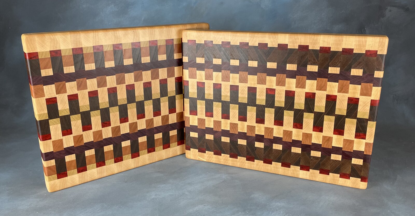

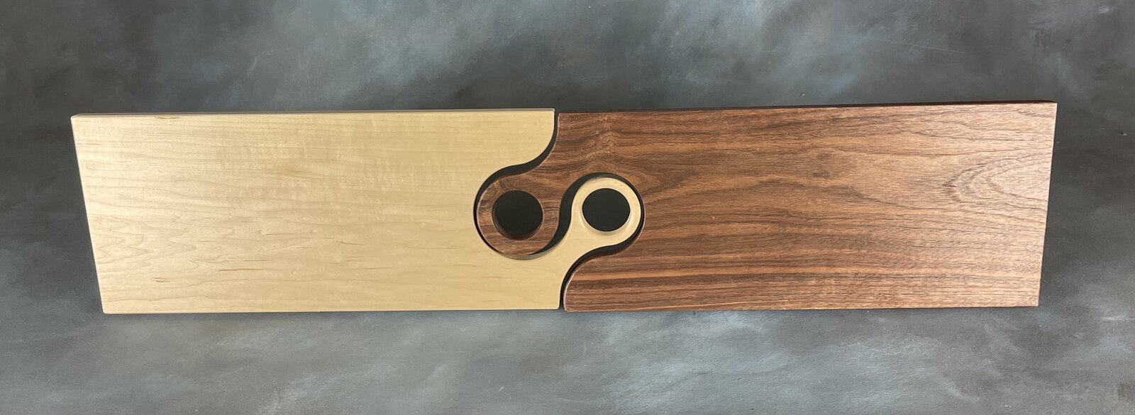

Here is how I make end grain cutting boards with two of the finished boards. The woods used are: maple, walnut, cherry, padauk, purpleheart and poplar. The ying yang charcuterie boards are included too.

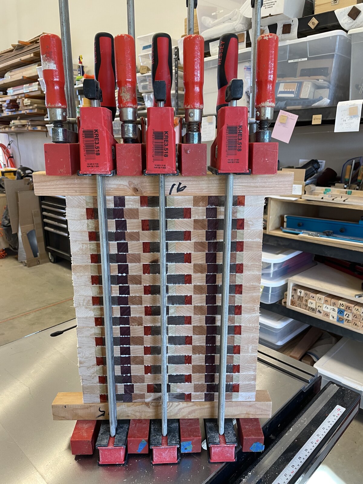

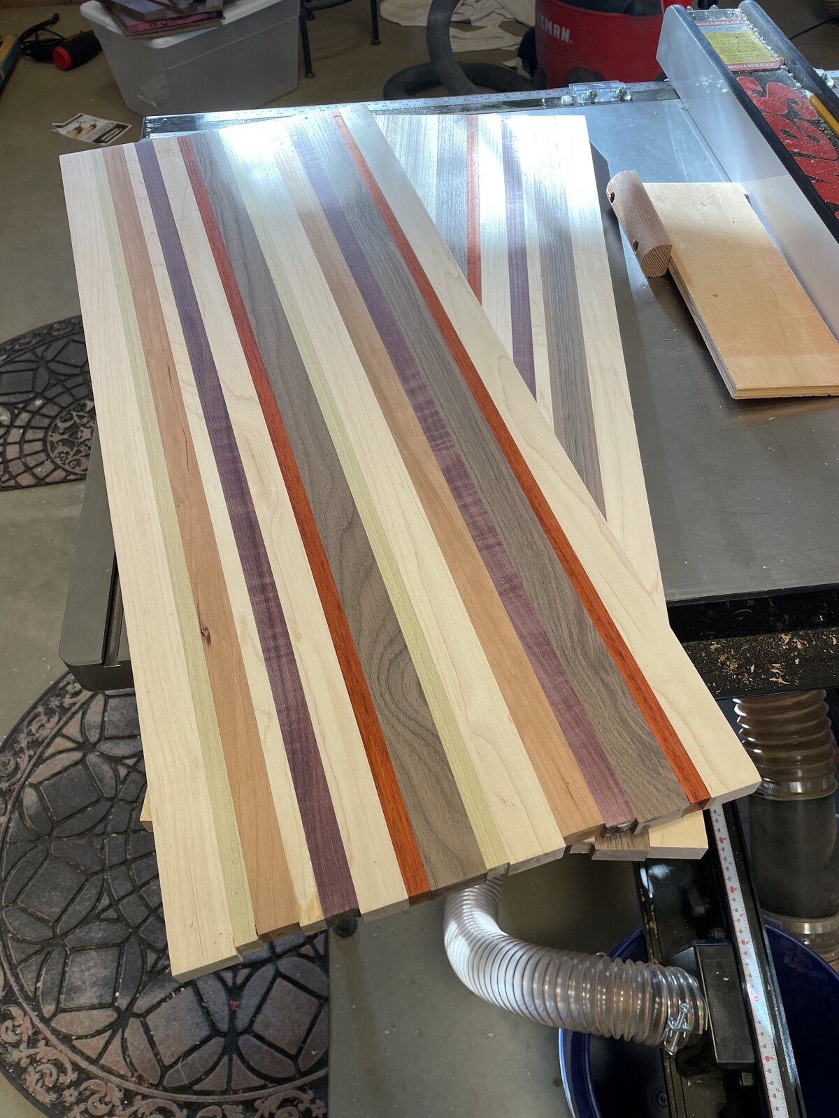

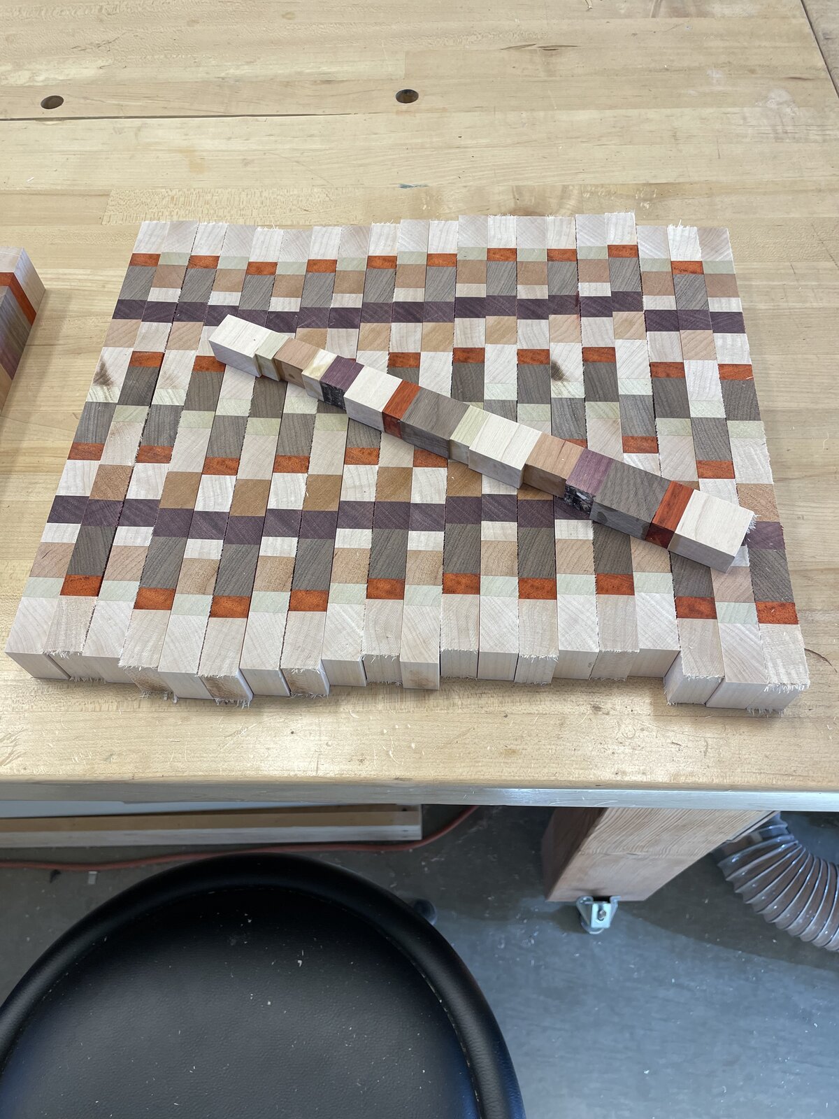

We make all of the boards shown in the photos. The board shown IAP was an end grain. We sell it for $175 and sold quite a few. It requires making a motherboard in which a bunch of strips of wood varying from 1/2" to 1-1/4" are asymmetrically glued up long grain to long grain. It is imperative to not only get them clamped tightly but keep them flat along the whole length. My motherboard is 32" long by 12.5" wide. Use Titebond III ONLY or get out of the cutting board business. When cured overnight I drum sand the glue up flat. Then I cross cut slices about 1-1/2"-1-5/8" thick. Assemble them with the end grain up reversing the orientation every other piece. I glue these up with plenty of glue and serious clamping pressure and cauls. This dries overnight. I have a Dewalt 735 planer with Shellix cutters and can VERY LIGHTLY smooth out the boards or drum sand. Padauk and purpleheart load up sandpaper like crazy. Yes I know folks say don't plane end grain, but it works very well with just a bit of edge tearing. I'll attach a sacrificial maple strip to each end and cut it off when squaring up the board to eliminate the end tearing.
You need
Great source of wood: maple cherry, walnut, poplar, padauk, purpleheart and perhaps bloodwood.
Bessey K body clamps (12",18",24")
Titebond 3 glue
2"x2" cauls
Perhaps the clamps that also press flat at the top in addition to towards the middle. The last photo shows two of these clamping up the end grain motherboard!
Either a drum sander and or a planer hopefully with helical cutters
Good sander with dust collection
Lots of grits of sandpaper like Norton 3x
Ask more questions anytime.
Mark
