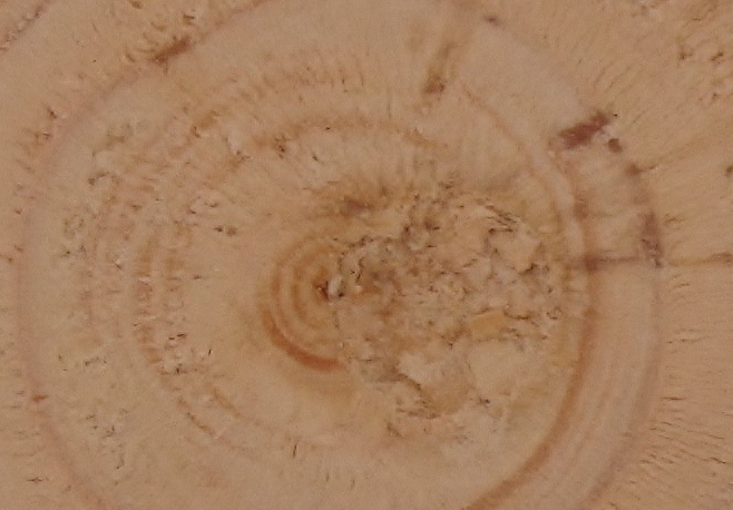

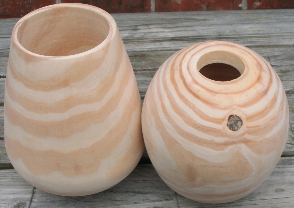

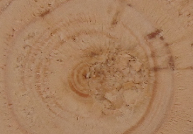

Two green Long Leaf Pine end grain hollow forms working on. While no problem turning outside with my bowl gouge with them. Had no problems inside hollowing with 3/16" HSS cutters until reached the bottom. Your are looking at end grain, pith & juvenile wood at bottom of bigger vase.
Since hit the point of dimension returns will wait till wood dries out and hopefully harden a little before doing anymore with it. I may end up removing pith & juvenile wood & installing a plug don't know yet.
If could see a picture of your problem might be able to help.
