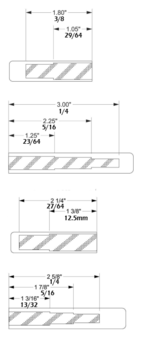

If you need a custom size just draw me a simple sketch like this...
PM me and we'll talk more about the specifics of your step drill bit.

Step Drills
Pentel Pencil step drills are $20.
All other step drills are $15 labor plus the cost of the drill bit .
Here are some pics of Step Drills...
Most of my bits come from Brazil, there are quite a few American companies with factories there. Not all are from Brazil but I will never sell you one made in China.
All of my step drills are $15 plus the cost of the bit, I charge you exactly what I pay rounded up OR down to the nearest whole dollar.
We all know how fast prices are rising, the prices below are subject to change as prices rise.
Apollo...
23/64"...$22
29/64"...$25
Artemis...
13/32"...$24
12.5mm...$30
8mm Bock #5... $20
9mm Bock #6...$21
9mm Jowo #5...$21
9mm Jowo #6...$21

PIN CHUCKS
See my video on how get rid of the runout on your Pin Chuck... Pin Chuck Video
These pin chucks are custom made for any size pen you want to make, most folks use them to make “closed end” pens but they can be used for ANYTHING with a hole in it that you want to turn on a lathe.
They're made from the same tool steel as my TOOL RESTS and will last forever....IF you take reasonable care of them!
They are approx. 4” long and have a 1/8” pin that fits in an 5/8” long slot. The turned down part that fits inside the tube is about 1/2” longer than the tube so you have some room to work on the end of your blank.
The little “dimple” you see is a reference mark so when you're done and want to remove the blank, you turn the chuck so the dimple is on top, that way the pin won't fall on the floor and roll under something........can you say ...” Murphy's Law”?
All my standard PIN CHUCKS are made from 1/2" material and will fit either a 1/2" or 13mm collet. My 7mm PIN CHUCKS fit a 1/4" or 7mm collet. If you need a PIN CHUCK larger than 1/2" I'll let you know what size collet you'll need.
I have a lot of different pen kits in stock but I don't have them all. If you want a pin chuck to fit something I don't have I'll either order that size tube OR you can send me the tubes and I'll return them with your order. Measuring the I.D. of tubes with calipers is fine for some applications but not for this, I like to have the tubes I'm fitting on hand so I can insure a perfect fit.
This is the pin chuck mounted in a collet chuck, ready to accept a blank.
This shows a sample that I turned down to a pen cap shape....works like a charm!
Pin chucks are "tube specific" so you'll need TWO pin chucks to do both halves of a pen.
These little guys are only$17 ea. , no matter what size you want!
