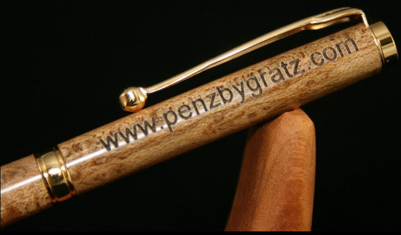

I've always had pretty good luck having pens engraved (by MrCook here on the forum), here's a 7mm slimline that he did for me sometime ago... I agree that there isn't much wood left after turning!
