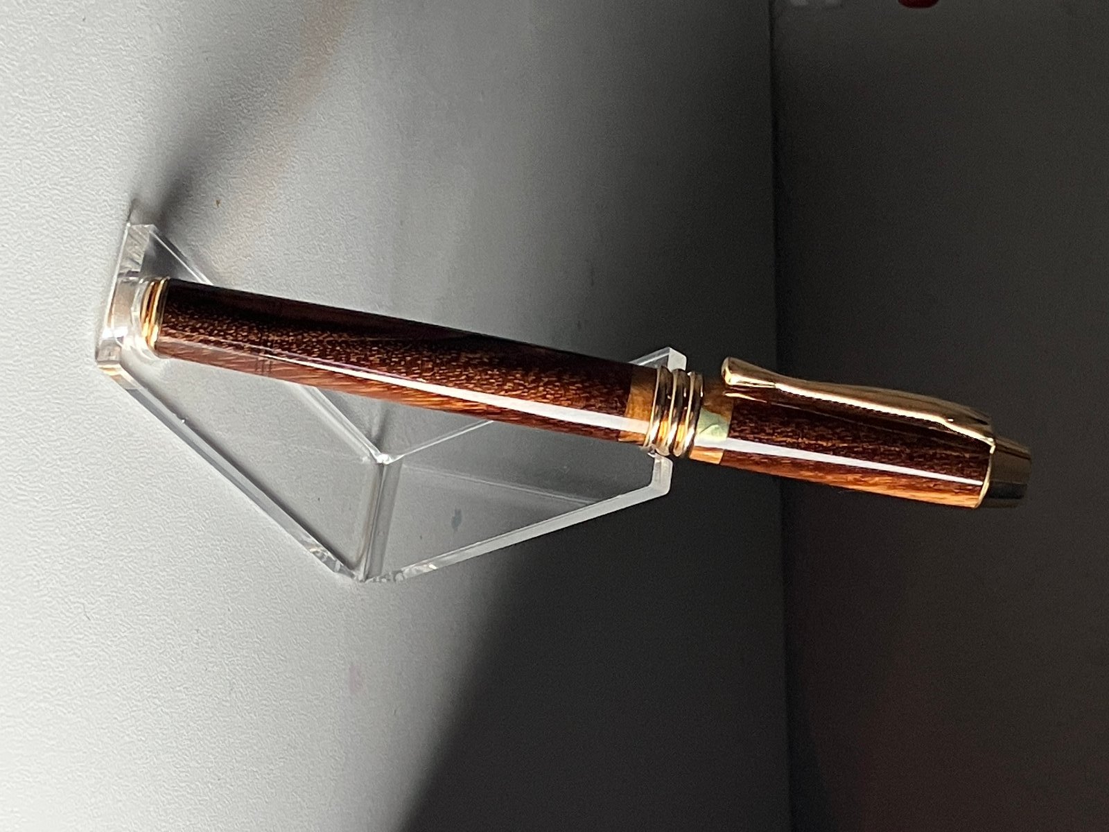

Tried everything for photos of recent pens to display on the venue website. Tried everything, different settings, flash, etc., etc., nothing works. I took photos of four pens but are too far away to see any detail. Might need to skip a drink and buy a good macro lens.
Here is a list of the camera and lenses I used: Canon T7, EF 18-55mm IS (marked as Macro on the lens body but didn't work with Macro setting), EF 28-168mm IS; other lenses are for long distance photos. Thanks for your input. Also posted on a photography forum for advice.

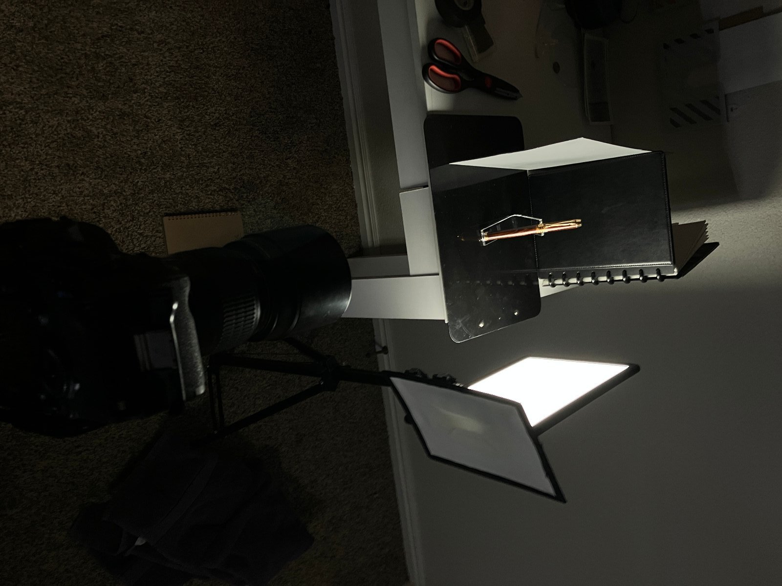

The trickiest part about getting a good-looking pen photo is lighting. Without getting into a super long dissertation on it, the two things you probably want are a light source large enough, and way to control where that light spills.
Light in photography is often described as either "soft" or "hard." Soft light is what you want for most product photography. That means instead of casting hard-edged shadows, it tends to "wrap around" the subject and create a much more even, flattering look without harsh shadows; sometimes without much shadow at all. The way to get that is by making sure that the light source is larger than and/or closer to the subject. That's why photography studios that do portraits usually have gigantic softboxes and shoot-through umbrellas. They're spreading out the source of the light (usually a flash) so that it's much larger compared to their (human) subject. The good news is, your subject is a relatively small pen. That means you don't need to spend $300 on a 6' octobox to get nice soft lighting. You just need some kind of diffuser that is ideally larger than the pen. Lots of DIY options exist. You could point your flash or light source at an 8x10 square of white matboard and have the light bounce off of that as a reflector. If it's close to the pen and just out of frame, you should get really nice soft light.
If you're going for a light background, it doesn't much matter if your light spills all over the place. In my most recent crack at taking some nice photos of pens I've made, I really wanted a dramatic black background. That made it much more important to control the light and make sure it was hitting the pen, but not hitting the background, to the extent possible. I did that by using what's called "flags" (in my case just pieces of black whatever I could find) to block the light as it came out of my light panel, so that it would hit the pen, but not spill onto the black background. Without these, the background was more gray, and not convincingly "dark", so the pen didn't pop out like I wanted it to.
It occurs to me as I type that when you say you've tried with the flash, you might be referring to the built-in on-camera flash on your T7. I'll advise you to skip that entirely. The direction the light comes from is every bit as important as how soft it is and how well the spill is controlled. Almost nothing looks very good with light coming at it directly from the front, 2 inches above the lens. You'll want to use a different light source. That could be an inexpensive manual speedlight (the Godox TT520II is under $50). It could be an LED panel (which is what I'm currently using to photograph my pens). It could be a cheap clamp light with a regular lighbulb from Home Depot.

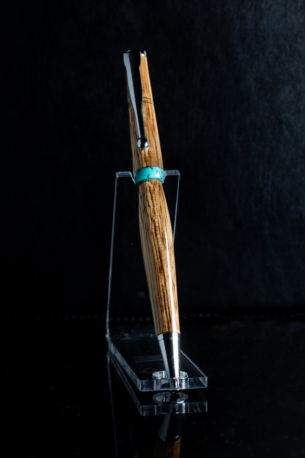

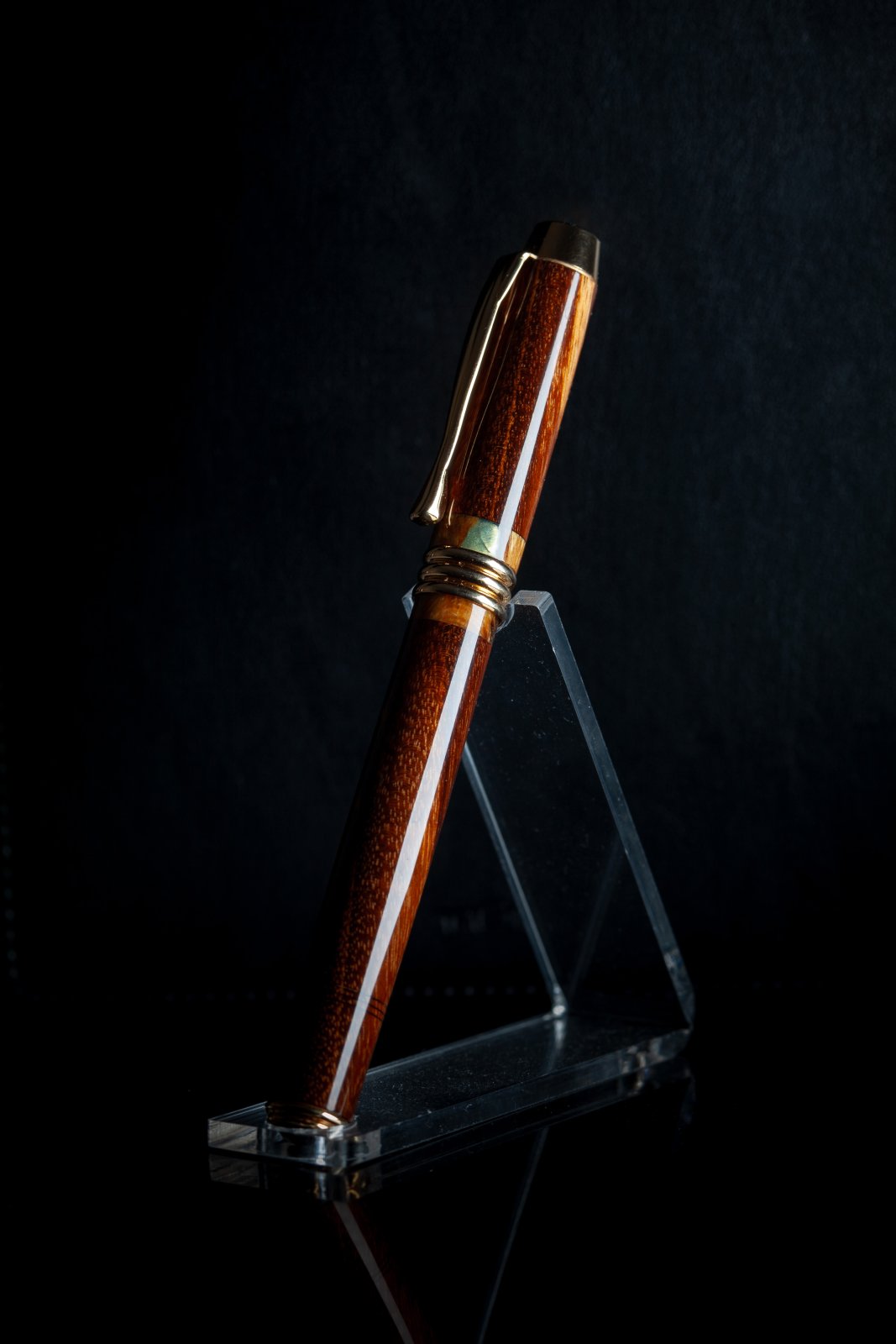

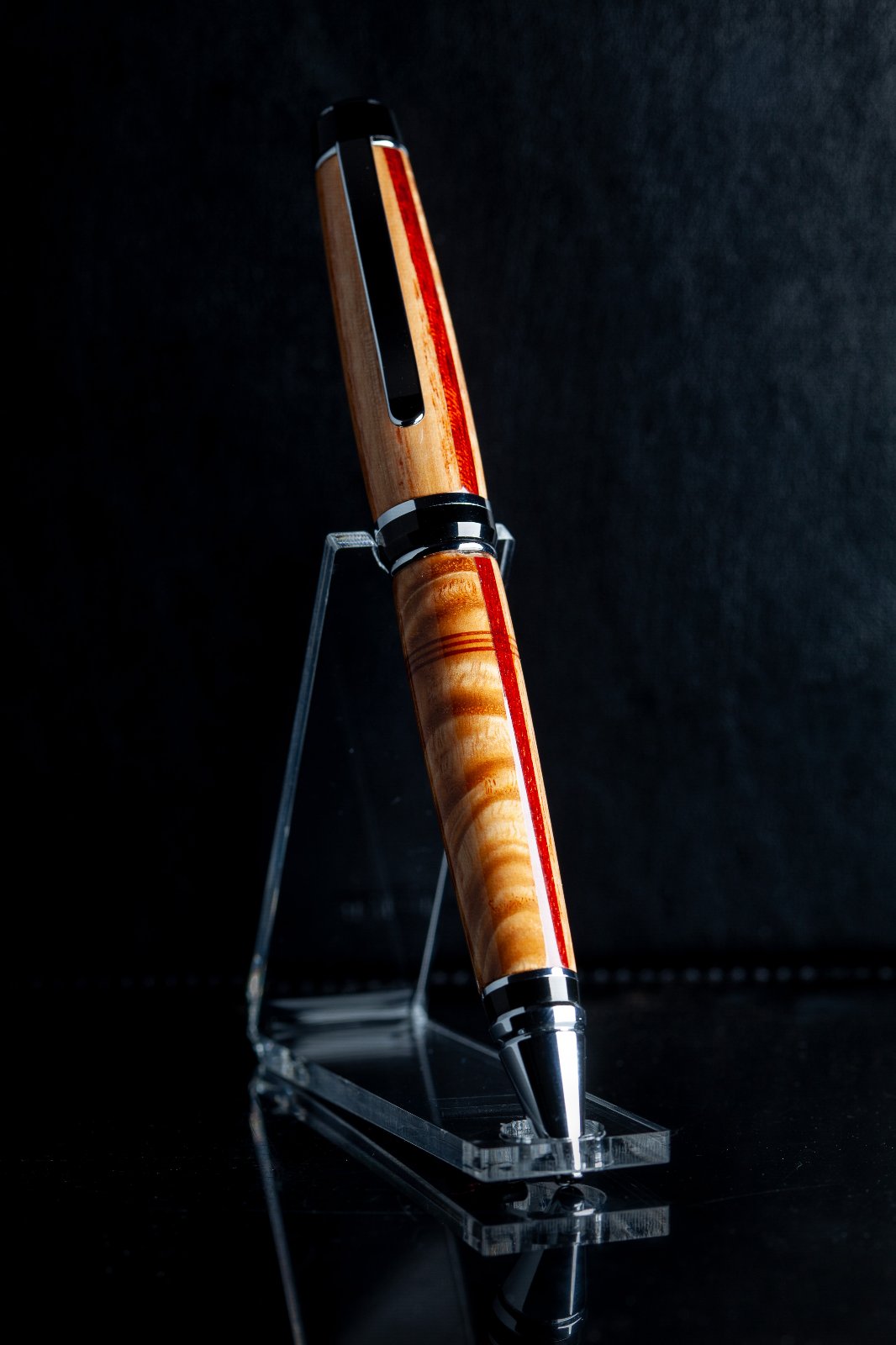

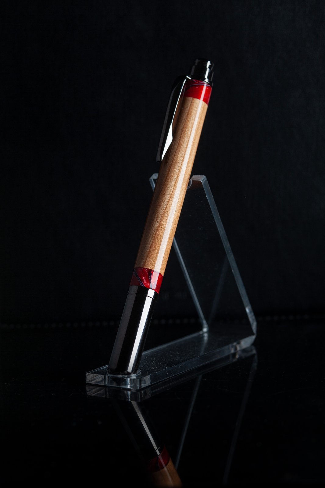

Anyway this has gotten long. Let me show you a picture of my setup and the results. You'll find that the lighting is hands-down the most important difference between a good and less-good pen photo. Even a cheap phone camera will make a great photo if the lighting is good. Your T7 and existing lenses should be more than up to the task.
Setup photo. Notice reflective black plastic base to sit on, matte black leather background (a notebook I had handy). Light coming from the right - as close as I could get it without being in the frame, to make it maximally soft. To the left of the pen a regular sheet of white printer paper to act as a reflector, and bounce back some of the light onto the left side of the pen so the contrast between the right and left wide wouldn't be as dramatic. The light source angled away from the background to keep light off of it and let the background stay dark. The flag on the left side of the light source primarily to stop light from shining directly into the lens and causing a flare. Sorry for the rotation of the photo. The forum doesn't seem to have a way to set the orientation.
Phone photo from my 4-year old iPhone SE (the model with the least impressive camera). Same basic lighting setup, but before I added the black background or controlled the light spilling. Still easy to see how nice the soft light makes the pen look, regardless of camera.

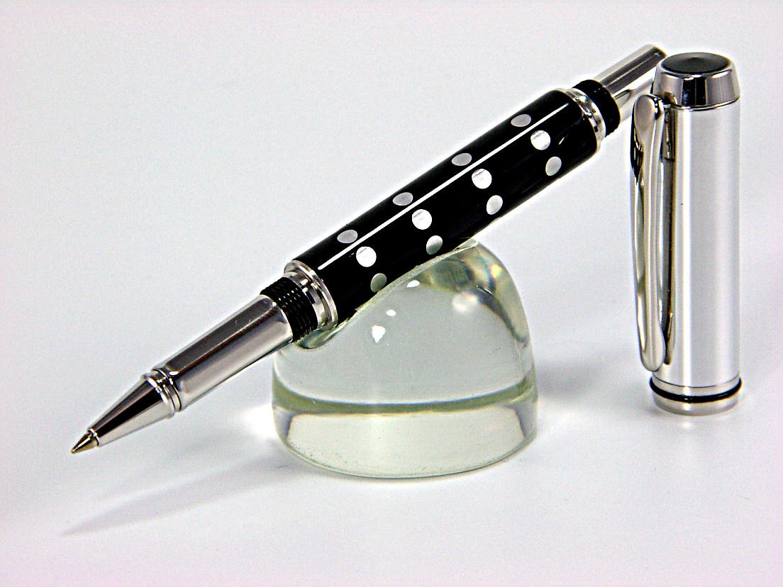

A few end results taken with the actual camera and the exact setup shown in the first photo.

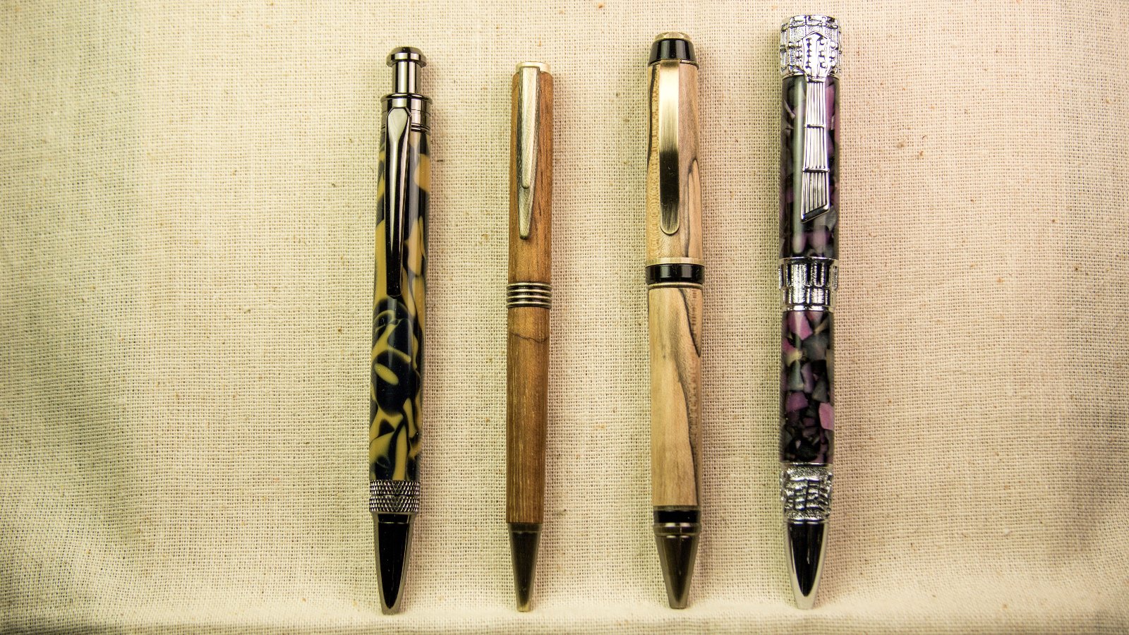

Here is my light setup that has been posted many times.
That looks pretty workable. Yes, getting the correct exposure can be tricky, but with digital it's fairly easy since you can just shoot and check and make adjustments for free.
Looking through your profile and the photos you've posted, I wonder if you might find a simple white balance adjustment goes a long way. If you shoot RAW then you can adjust white balance all you want with no image degradation after the photo is taken. If you're shooting JPG, you're better off adjusting it in-camera. Your camera should have an incandescent light setting that help balance out the warm orange tones and provide more accurate color rendering.
Besides that, I'd throw the camera on a tripod, use your 28-135, zoom it in all the way (most zooms have their best close-focus when racked out to the longest focal length), frame your shot, focus, and set the aperture to something like f/11. ISO can be set to 100, and the shutter speed can land where it may - your subject is holding still and your camera is on a tripod, so even if it takes 30 seconds to get proper exposure (it won't... but it might take like 2 or 3 seconds depending on how bright those lights are), you'll still get a really clear image, without having to compromise on other exposure settings. If you're getting shake, try using the self-timer. With slow shutter speeds, even vibration caused by pressing the shutter button while you're on a tripod can cause blur. The self timer lets the vibrations from pressing the shutter release subside fully before the exposure actually starts.
For what I do regarding trout flies, etc., the tripod is a must. Bhuij, thanks for the reply and info.
I had taken a photo of one granddaughter's birthday. Turned out yellow. Sent the photo to a retired professional photographer. Sent back brief reply...white balance. Been aware of its importance since then. Didn't a chance to play with the camera, lenses, etc., but hopefully tomorrow or Sunday. I still have the pens as they are backup to keep up inventory when I sell a pen or two. Weather has played heck around here. Even with no snow, southern folks aren't used to this real cold weather. Wife commented that usually we have maybe two days of cold then a warming spell.
IMHO, your light stage is too brown and you need diffusion on the output of those lights. Careful with putting anything over the lightbulbs if they are incandescent as they get hot and will melt or fry anything directly in front of them. Switch to LED screw ins for whiter light.
Curly Q bulbs. Trying an edited RAW image. Finally figured out how to change to jpeg.

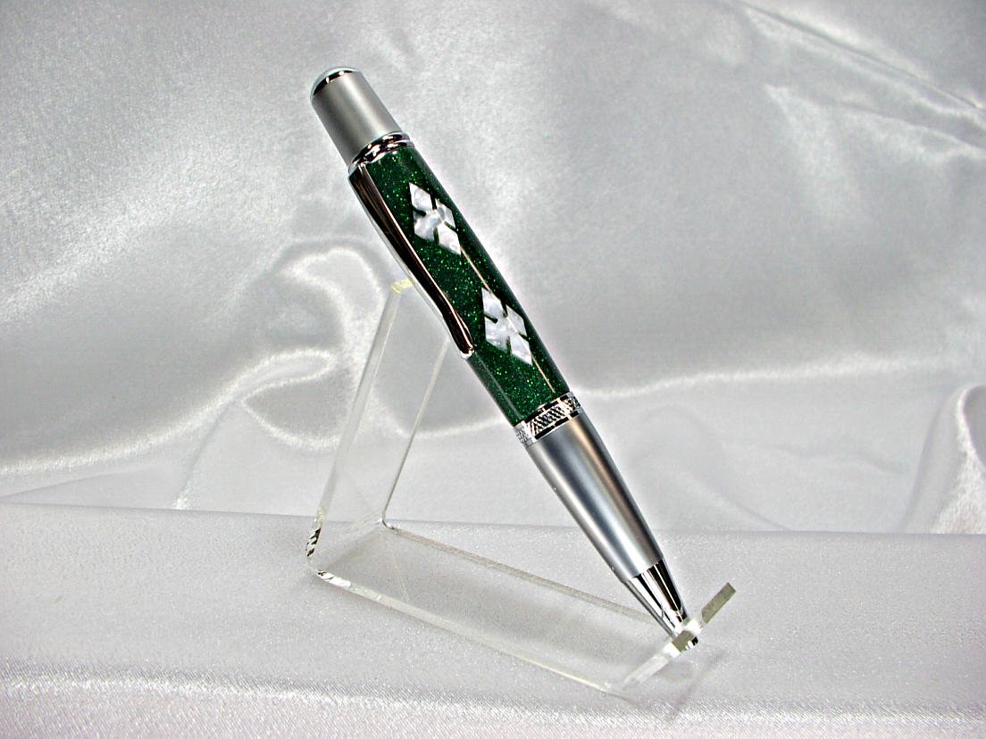

Will say this I and am sure many have gone down this rabbit hole too. I tried many many ways to take photos and used macro lenses and photo editing programs. The best photo editing program I found years ago was called Picture it I believe. It no longer is available and I was ticked off when I got a new computer and found out I could not find it again. I had the disc but was not able to download it to new computer. have never found as good of one to this day. But just do the best I can. I can use the same setup for every pen but some pens just come out better than others. Just when I think I figured out the right lighting angles and background the next pen does not show as well. I posted on here of my troubles and Eric helped alot. He wrote an extensive detailed tutorial here that is very helpful because if you ever look at his photos they are magazine quality. He knows what he is talking about. Check them out in the library.
Now I see you are trying for better photos for selling your pens and I understand that because that is all people have to judge the product by abd the better photos and detail help customer. But for web sites like this as you can see many people just use their phones and many times the photos are not really that good but work for showing their work to us all.

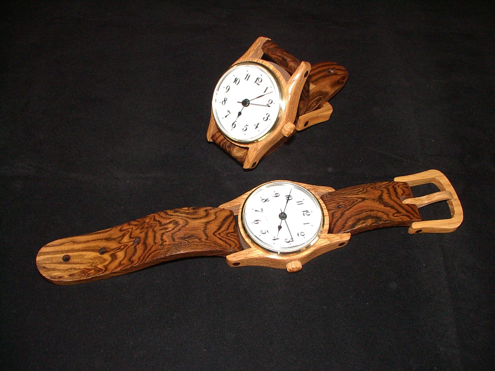

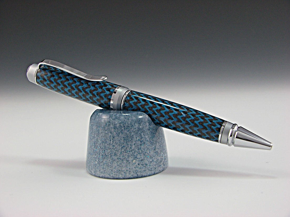

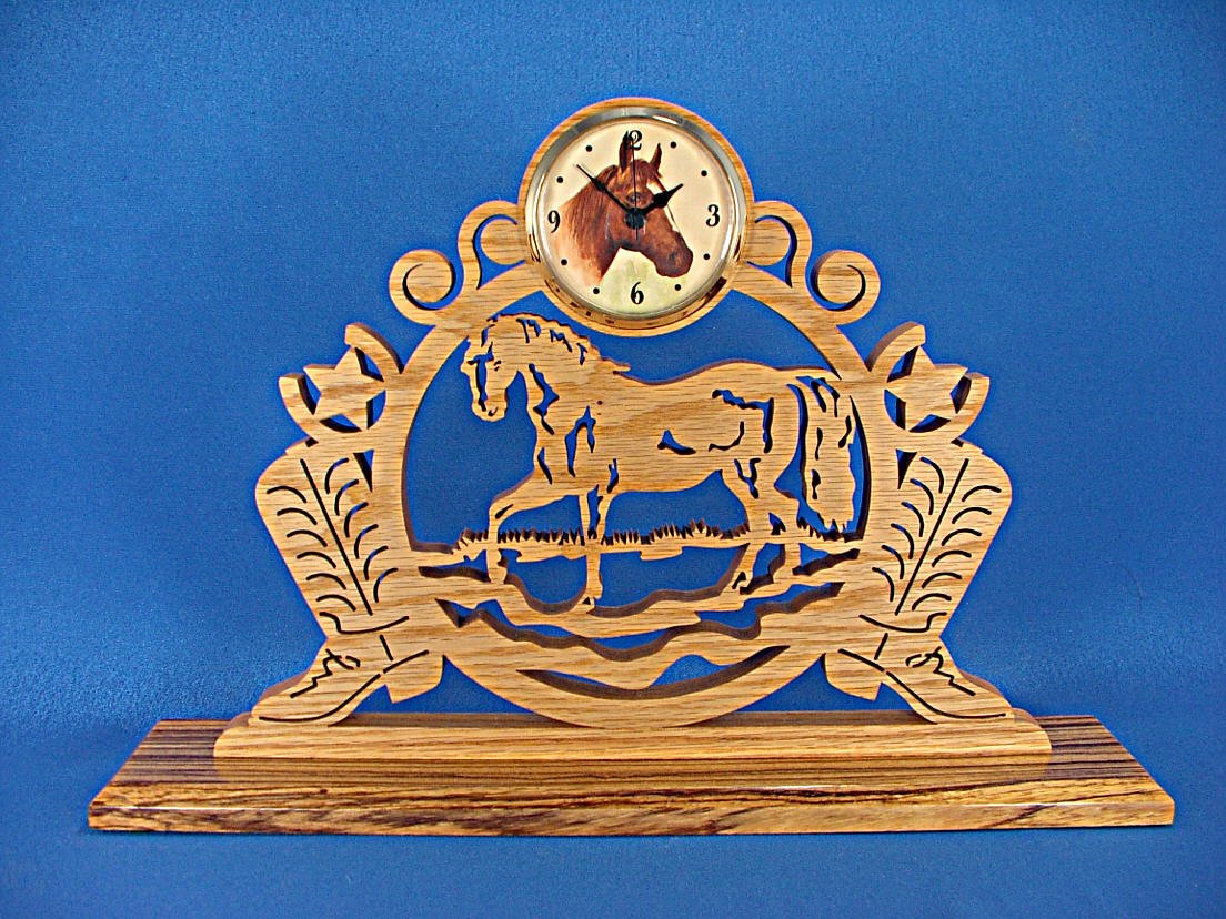

I have tried many different approaches with backgrounds as you see from some of my photos here.
I have tried the outdoor photo which some people use here and there was one person going back a few years who did outside ligting and he said on his back porch and it happened to be a perfect set up. He had the right amount of light when the sun was out and his photos were excellent I tried that many different places and could never find that sweet spot. maybe you could. Then I tried different backgrounds because people were using Gradient paper and loved that look. I still have them but again could not make work for me. Those photos are great for magazine shots. Lots of people use them. Professional photographers use that paper. I tried arts style photos using props and things and some worked well. But to make a long story even longer I found the best background to be white or a light grey. It works best with pens that have color or darker woods. If the pen is metal or light colored it gets absorbed in the background and looks washed out. yes playing with all the settings is good. but I never did master that stuff. I wanted a point and shoot setup. So I either use a white cloth now if I want more artsy look or just plain white paper background and it works. I do use a editor program to enhance sharpness and size the photos down.. Here are a couple photos of pens I have shown here before. I could never be able to tell you set up of lighting and all that stuff. Good luck and hope you find that sweet spot and take notes. I have an old Minolta SLR camera with all the lenses I can sell you. :):):) People forget how we had to have film developed to see how are photos looked. Yea that is what I am talking about. Spoiled people today!!!!! LOL.
