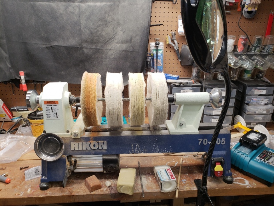

If have a Beall-like buffing system (instructions are to the left). I added two more progressively finer compounds and mounted all on this lathe which I operator with a variable-speed foot pedal.
Here's pic...not exactly operating-room standands LOL
